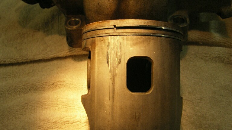

Bugeye59 sent me these I will let him tell the story.

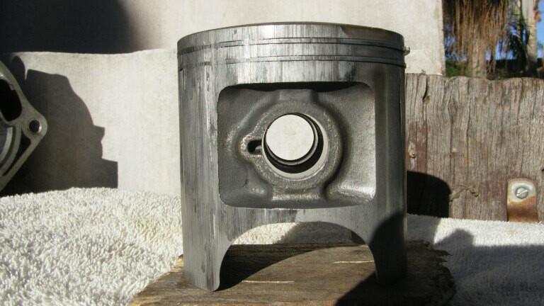

PostPosted: Thu Jul 26, 2007 10:22 am

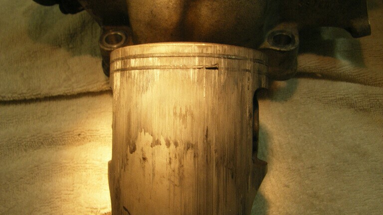

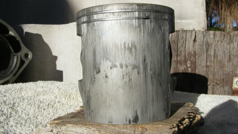

Did the locater pin that keeps the rings located in the correct position fall out?
Take a razor blade or sharp knife and run it around the rings top and bottom trying to cut the aluminum enough the rings will not be stuck in the piston and see if you can remove the rings from the piston.
You will need to remove the aluminum from the cylinder before you can accurately measure the cylinder, do you know how to dissolve the aluminum with muriatic acid? looking at the wear by the exhaust port you will need to bore the cylinder.
PostPosted: Thu Jul 26, 2007 10:39 am

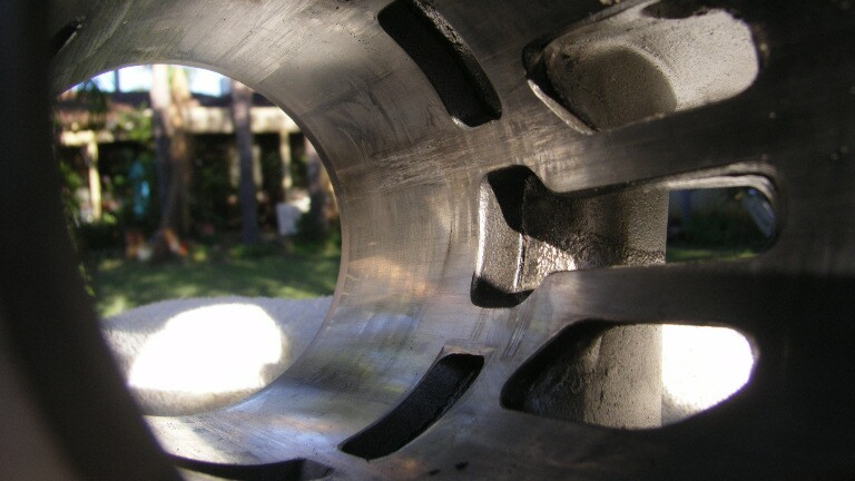

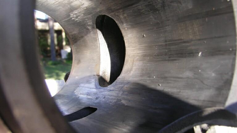

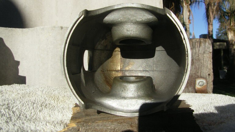

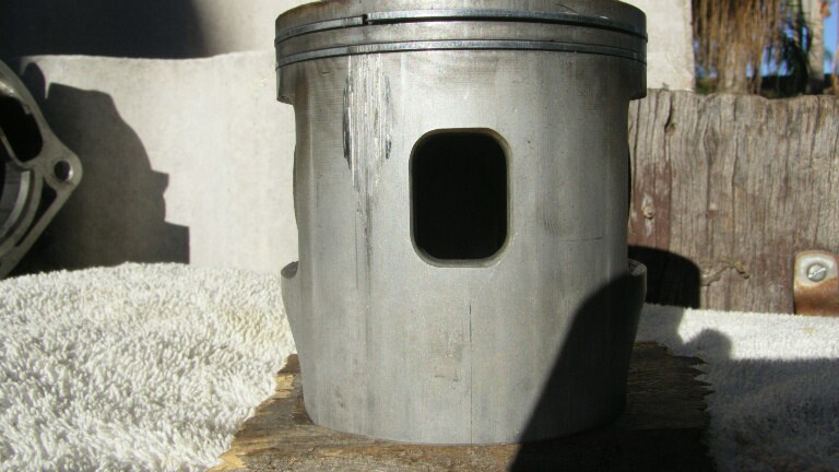

When I removed the cylinder n head, I found the vacuum hose to fuel pump at cyl spigot to be loose! This may have caused air leak and also affected the efficiency of the fuel pump resulting in the lean out.
There was also a leak at the base gasket right rear at bolt area.
If you look at the top pic, you can see where the bottom ring has migrated around to the exhaust side and nipped up on the exhaust port's,top n bottom edge.
Look at pic 1644 and you can see the bottom ring end forced up into the piston, on the exhaust side,:shock:
I will take to the piston with a knife tomorrow morn-I'm off to bed now, it's nearly 11pm here.

PostPosted: Thu Jul 26, 2007 10:44 am
I can't tell about the pin yet, it's all sort of mashed up together. I was worried about the same thing, want to know where it is, if it's not in the piston, then where is it? There is also several close paralell lines that run same as the rings in the cylinder walls. This must have been the bot ring as it moved around to the exhaust side.
PostPosted: Thu Jul 26, 2007 10:52 am
Look close at the cylinder inside and out that area where it leaks is usually from porosity in the casting.

Just got back from the machinist's place and he reckons that the pin dislodged,he's seen it happen before with other jobs. He has already bored it out to 1st oversize, for OEM Honda ART Piston.He said if it was'nt for the ring end damage to the ports edges that it could have been honed out as the MIC'd size was still showing orig bore size.

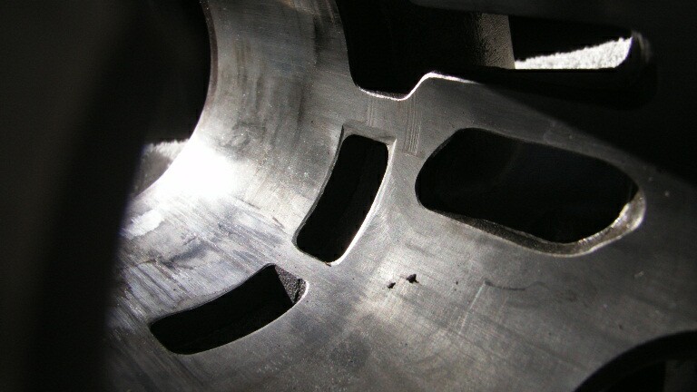

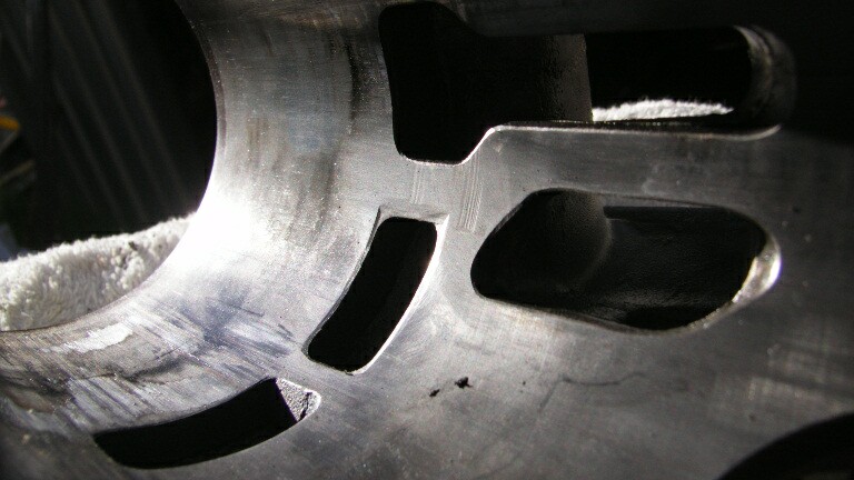

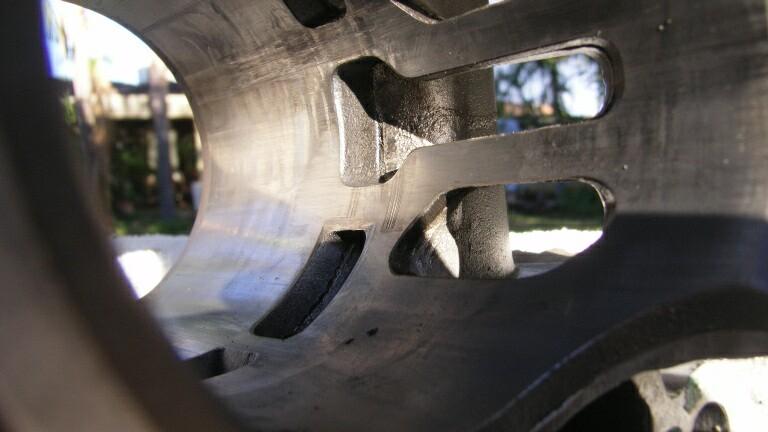

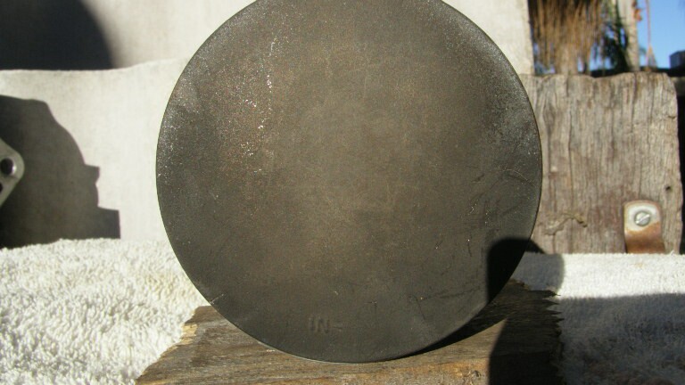

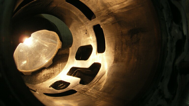

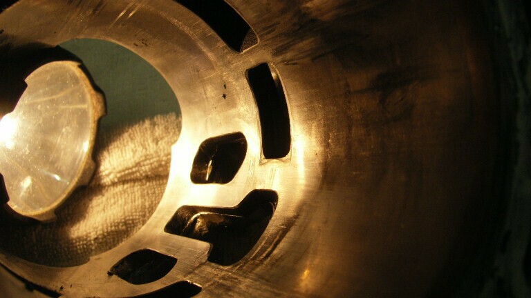

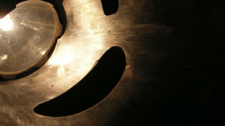

Took more pics this morning in the sun. You can see the damage the ring has done.

PostPosted: Fri Jul 27, 2007 9:03 am
Almost looks like detonation where the arrows are.

PostPosted: Fri Jul 27, 2007 9:04 am
Give this to your machinist its out of the service manual its how the ports should be beveled.
pilot port bevel
Look at the colored arrows I added.
I like to add slightly more bevel in these areas so they don't scrape oil off the piston as it travels up and down.
The required piston to cylinder is .0031 don't let him add extra clearance like most builders want to add, I run .0031 on my full modified Pilot for years and never stuck a piston or had scuffing problems even when the Engine over heated.

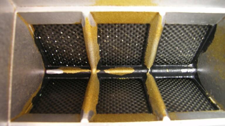

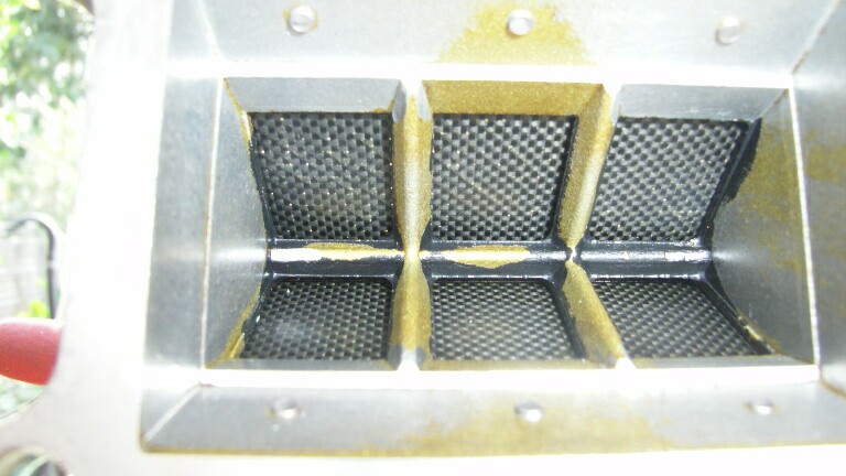

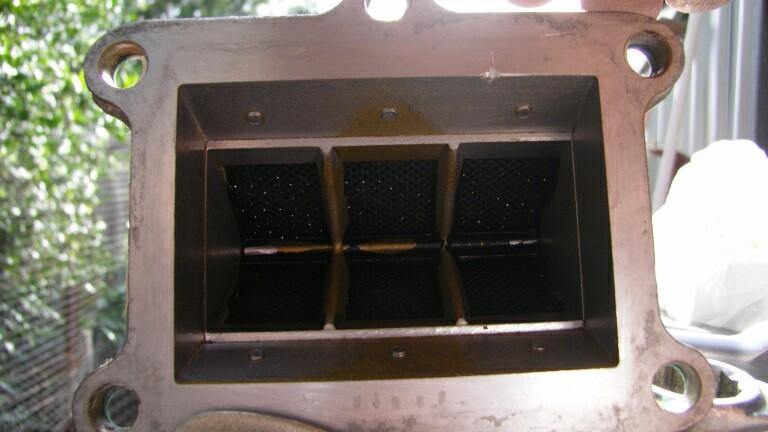

Well, finally got all my parts for top end rebuild,1st oversize Honda ART 25, did'nt end up shaving head,erred on the side of RELIABILTY. Got stuck into it, and before I knew it was nearly finished.
When it came time to install the reed cage valves, I checked it against the sun for wear n holes-gaps. Did'nt like what I saw,lots of pin holes,black carbon fibre I think, but had nothing else to install, so put them in to find out PSI. See pics.Judging by the diff colours,gold,silver,black,there's a lot of abrasion happening there due to inadequate air filtration.
Very dissapointed with Comp reading-125psi! Must be all the pin holes in the petals? I remember a while back there being alternatives to Pilot petals, CR250? Year? Those I can get here in Aus, but Pilot ones,forget it!-another 2 weeks! :shock: Recomendations??? Next race, this coming Sun. :shock: :-)

PostPosted: Sun Aug 19, 2007 10:19 am
Are those actual holes in the reeds or just light showing through the resin?
If your replacing the whole cage go Honda or FMF
You know how to check the squish clearance?
Check compression again with another tester if its 125 and the cylinder is stock something is wrong! don't even start the Engine!
Give me details on exactly how your testing compression and detail pics of your tester, does the tester have the valve core at the end where it screws into the head?
