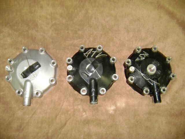

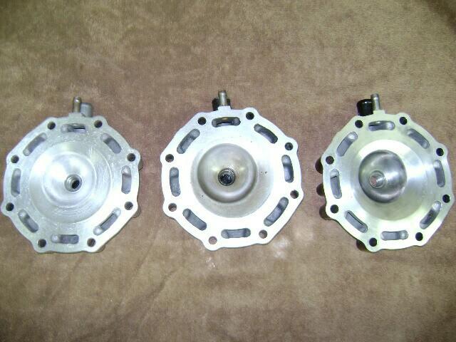

NUTZ4SAND sent me his 3 Pilot heads for evaluation, all 3 are Honda heads that have been modified, 2 are modified by PCP and one by "ATV" I assume ATV Racing?
The unpainted head on the left is PCP the middle ATV and the right PCP painted.
Attached to the heads was the solder he crushed to check squish on his Engine
PCP unpainted was .046 Squish angle 15 degrees
ATV .040 Squish angle 15 degrees
PCP painted .043 Squish angle 17 degrees
ATVR fail

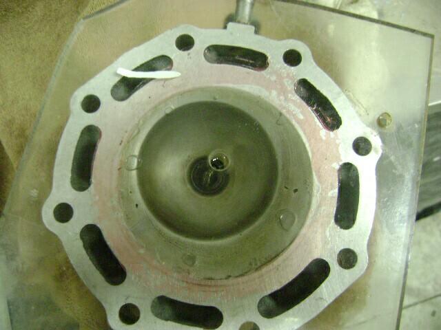

PostPosted: Thu Sep 06, 2007 3:44 pm
Posts: 22616
The PCP painted head (in the picture below) and the PCP bare head BOTH have had the top side of the head machined where the spark plug makes contact when you tighten it I can only assume this was done to repair wear damage where the spark plug gasket seats? See how it sticks into the combustion chamber, a shim needs used when using this head to keep the plug back perhaps 2 gaskets can be used, I know they sell spark plug shims but I don't know where you can get them.
PostPosted: Thu Sep 06, 2007 3:53 pm
Posts: 22616

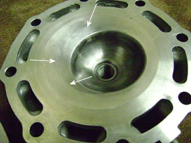

The PCP painted head has a double squish angle, not sure whats up with that perhaps its some secret squirrel stuff I never read about.
The arrows point to where the angle changes, hard to get this pic.

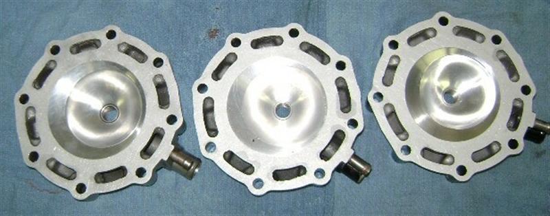

Your heads are completed per your last request by email, the heads are as follows.
PCP bare 215 psi 40cc NOW IS 170 PSI at 47cc
ATV 185 psi 45cc NOW IS 160 PSI at 49cc
PCP painted 215 psi 40cc NOW IS 160 PSI at 49cc
All 3 heads were lapped flat you will see the gasket area is gray once you get them where they were lapped.
I washed the heads pretty good but as with all parts you will want to wash them again real good before use.
You can see in the pics I put 'hoser' on the heads one I put PilotOdyssey.com I didnt like the way it came out so I didnt do the others, I am no engraver lol
I will include a USED stock Honda head gasket you can use for mocking up and checking compression what ever before use if you like.
Heads will be shipped today.

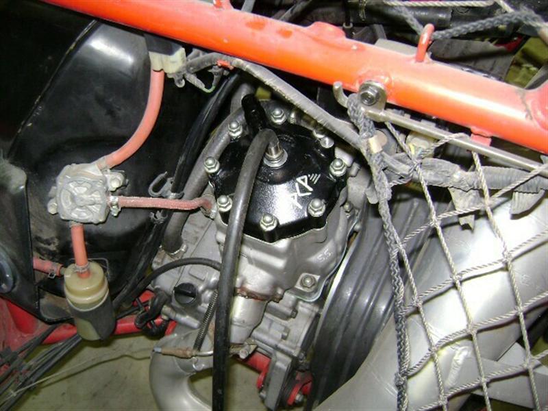

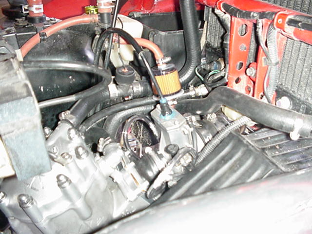

I have the PCP bare head on it. I finally got a chance to fire it up yesterday (I wanted to take it to the dunes this weekend but will be doing so today it looks like.) As I cleaned the carb after adding my new power jet kit I discovered the Pilot air screw was missing the oring and the little washer that rests against the oring. I made a washer to fit but had to go to four different places before I found such a special o-ring to fit down in there. I do not think it even had it when I tore it apart butI could have missed it and not seen it fly out when using compressed air to assure clean passages. Its got it now and that what matters. I ran it yesterday without the seat and safety harness out of it so I could get to things and see better. It was just the initial heat the piston cycle. After that I let it completely cool and the compression test (throttle jacked wide open) revealed a solid 160 PSI. I ran out of gas so I am gettign ready to go now and get some more for it. SO far it seems good and the plug looks better than it ever did before so I am hoping.
One thing that may be normal or not. I have a large clear fuel filter going to the carb (see pic below) When the thing is running it seems the fuel pump can barely keep any fuel in it at all. Easily less than a 1/3rd full all the time. (My lean out condtion??) The only time the filter gains volume in it is when the motor (( Internal Combustion Engine ? )) is shut off then the trickle down effect fills it some. I would think the fuel pump would fill it easy as the overflow tube up top is (I thought anyways) there to take excess fuel back to the tank. But it should be filled almost up to the return tube?? I checked the fuel pump once before and am going to recheck it according to the book. Hoser if you have a better way to test these pumps I would be willing to test it that way too. Bear in mind that I of course did not rev the motor (( Internal Combustion Engine ? )) to much (nearly none. Just a couple blips here and there to vary Engine speed a little. Very little idling. Usually above idle a little) That said the pump might pump a lil more with more rpms more the carbs gonna go thru a lot more. (I am not convinced of this as the pulses will be faster but not as "pronounced" thus giving less input to the pumps diaphram? Or am I wrong about this?) I was worried as I have heard that the paper filter would not allow the gas through it with gravity feed but the first fuel into it went right thru till the carb got a drink and the Engine fired. Bill
Oh yeah. One other thing that delayed me a little was I had to get a reed spacer and install it. (Yah I retested for vacuum and positive pressure in the crank after I changed it) When I was modding the carb for the power jet kit I noticed the bottom of the FRONT of float bowl when the choke circuit is was wearing from rubbing on the starter. It was not a problem with the stock manifold but with the new larger CR250 manifold that Hoser guided me to for easier fitting of the larger 41mm carb. The new manifold is a straight shot into the reed cage but it does hold the carb a little closer to the cylinder and thus the carbs fuel bowl was bumping the starter with motor (( Internal Combustion Engine ? )) vibration. There was enough wear that had the motor (( Internal Combustion Engine ? )) not had another issue that cause me to go into it again it might have worn through with a couple hours running. Thanx Bill

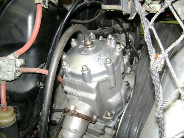

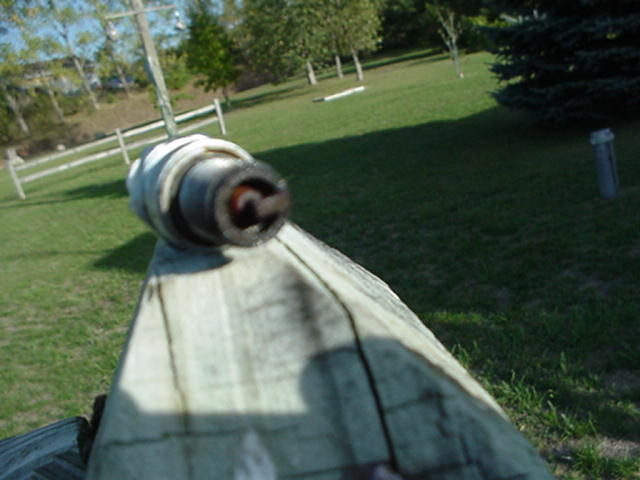

I have near two tanks thru the machine now and it seesm to be running fine as frogs hair. I still am not going for broke with the throttle but have tapped it a couple times late in the second tank but not long enoguh to get the rpms way up. The coolants hottest temp so far has been 197.7 (Digital temp with max and min readings) And the cooling fan does seem to be on most of the time when I come to a stop but it shuts off within 30 second usually. I finally got home tonight after some dune fun ( no one there makes for dam smooth dunes!!! ) The reason I say finally is my dune truck decided tonight was its last night to go duning as the motors head or headgaskets gave way.
The Carb adjustments (the things I fixed like improper jets) The Power Jet kit I installed is awesome. Its not as nice as dial a jet with a knob (But it is 1/3rd the price. And its fits any carb but was MADE to fit the Mikuni Proseries. So installing it was falling off a log easy.) but all you have to do is undo one screw on the top of the back of the carb and then unscrew the jet there. Lifting the brass jet out is tricky so you need a fine little wire with a tiny hook bend to reach in and lift it out once unscrewed. I started out a lil rich (on purpose) It ran great in the midrange but the top end burbled a little. Just for laughs I put a bigger jet in the power jet and it flat out would not rev well once past half throttle. The power jet kicks in there and supplys the extra fuel needed. Once I went one size leaner than I started with the thing ran smooth from the bottom to the top. It might be me but it does not have the hit it used to but it seems to actually have more torque low and pull better thru the range. Before it seemed to smack you harder after a little windup. Might have been the jetting issues. It will walk up Test Hill at Silver Lake at about half throttle with out to much trouble and not a big run. (that's with my 270 pound ash in it!) The fuel pump IS keeping the fuel filter full once it gets fuel in it so that's good. The compression test tonight showed a solid 160 PSI.(throttle wide open) I tried to get a good spark plug pick but my camera was not having it to well and I gave up after ten and posted that one below. Once again Thanx hoser for all the help and wish me luck with it in the future. Bill
PostPosted: Thu Sep 20, 2007 7:21 am
Posts: 22616
Why are you running the second filter?
I run the stock Honda filter only and never find any dirt in my carb, I have found fine rust and sand in the filter but nothing ever in the carb.
Try to take more plug pics in the sun when you get a chance we need some profile pics too.

PostPosted: Thu Sep 20, 2007 12:14 pm
Joined: Mon Jul 02, 2007 3:00 pm
Posts: 176
My tank is clean and I have a new Honda filter in the stock location. The large CLEAR see thru filter allows me to see that there IS gas going to the carb and being that it holds a small volume of fuel it acts like a tiny pressure boost due to the extra fuel weight (Like a water tower for a town.) Being that this carb is so much larger than stock and the motor (( Internal Combustion Engine ? )) mods I figured it could not hurt to have that little extra there just in case. So far it has been a good reassurance for me that fuel is always there. I consider it a great easy thing for the few bucks it cost to do. I will have to see about pics later today. I am going here to look at a new truck : / in the next little bit and the person who is helping me has to work later so I gots to go now. Thanx Bill

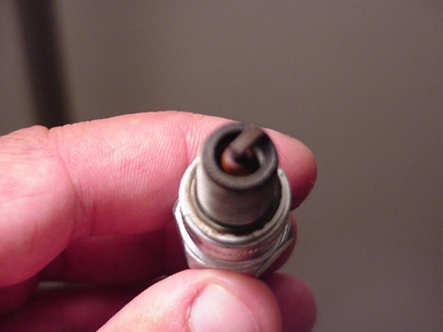

 Post subject: Pics of plug 2nd try
PostPosted: Thu Sep 20, 2007 6:13 pm
Posts: 176
I am not sure how to do two pics a post sooo.
