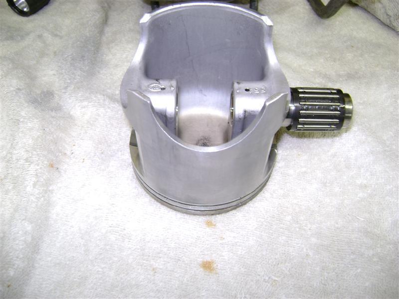

With the head off and the piston cleaned I can see they use a wiseco and its a 1mm over bore.

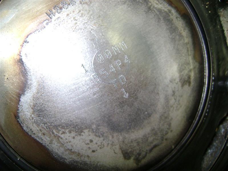

Burn pattern before cleaning the piston, looks like its a low hour piston so far.
Head gasket looks stock Honda, I am assuming at this point, its metal 3 pieces and has the black coating like the stock Pilot gasket.

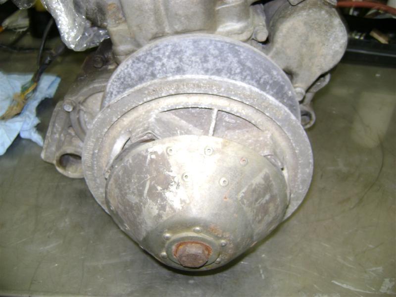

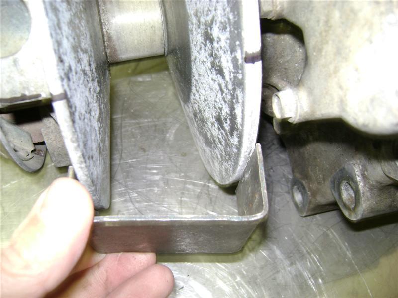

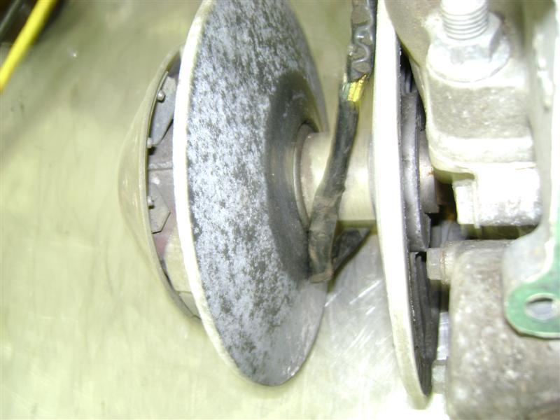

Clutch is wider than my holder I think the clutch is adjusted too wide for the Honda belt

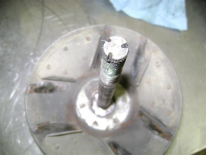

PostPosted: Fri Feb 29, 2008 3:48 pm
Grooves cut on the end of the crank bolt to act as a tap???

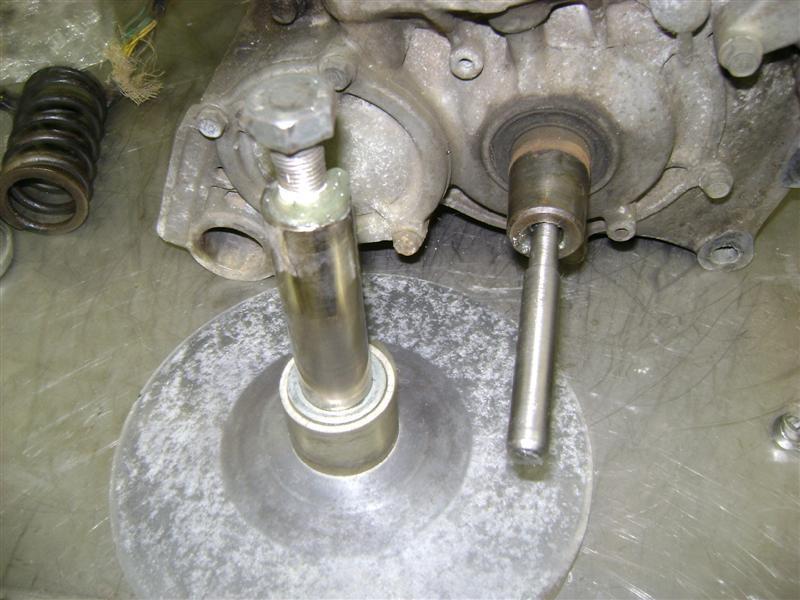

PostPosted: Fri Feb 29, 2008 3:50 pm
Filling the bolt hole with grease before installing the puller works every time.

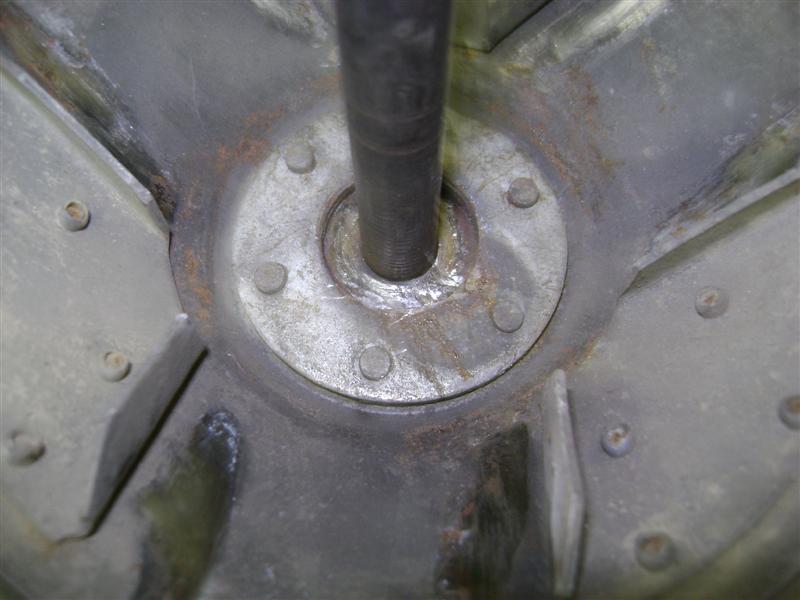

PostPosted: Fri Feb 29, 2008 3:51 pm

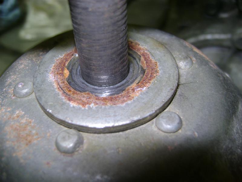

Look close, the washer is junk it has a deep groove.

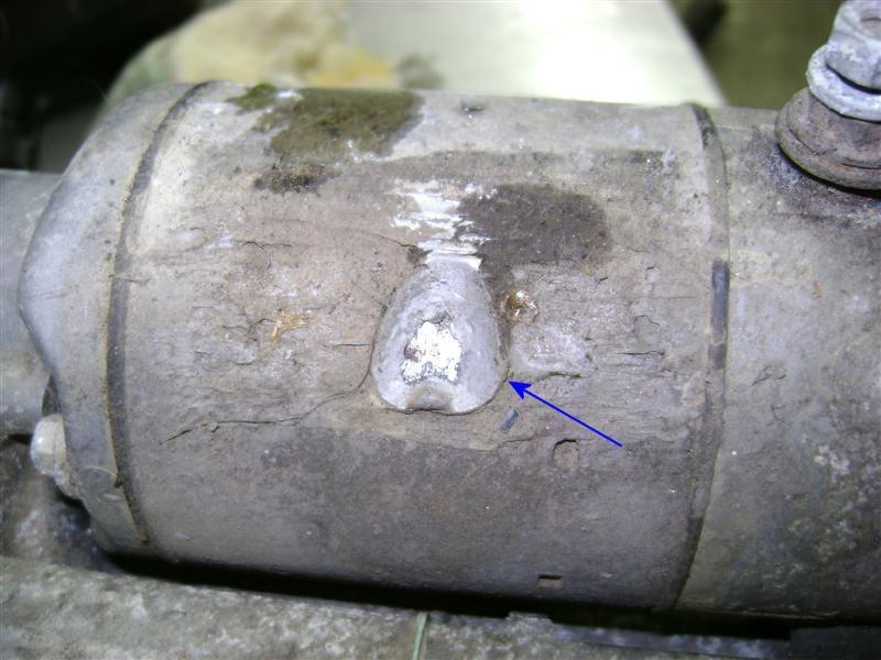

PostPosted: Fri Feb 29, 2008 4:08 pm

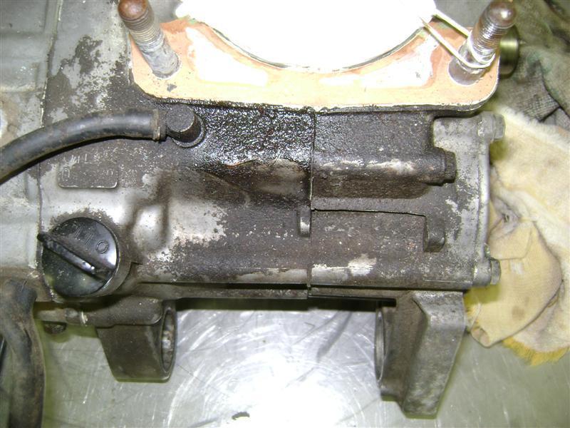

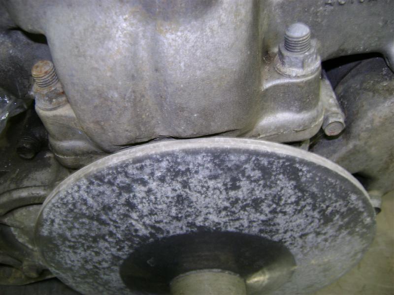

To provide clearance between the starter and the intake manifold they grind the starter housing down then seal it with gasket sealer?

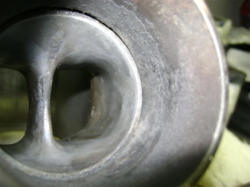

The exhaust manifold was leaking bad.

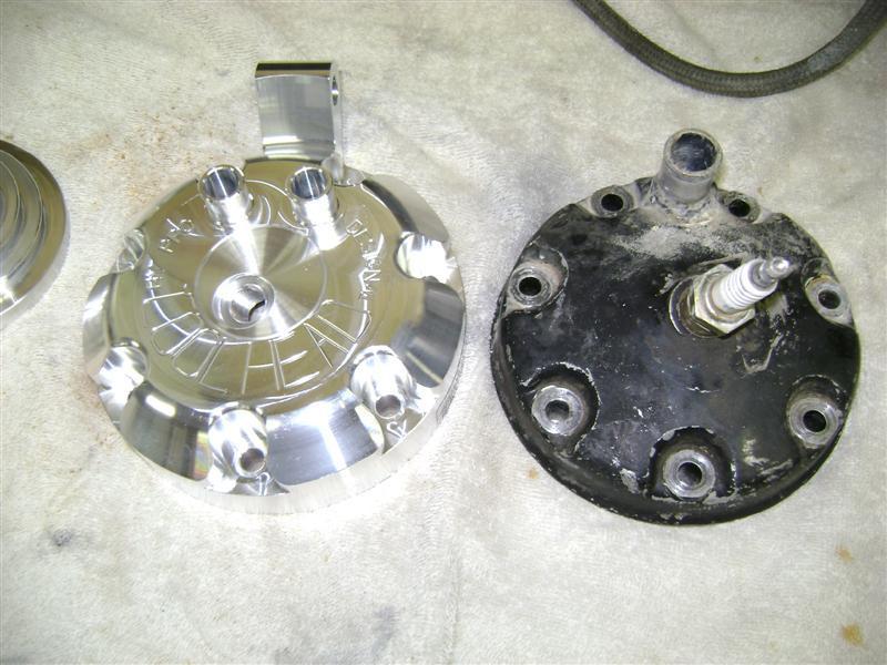

PostPosted: Fri Feb 29, 2008 4:10 pm

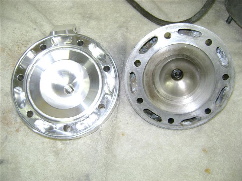

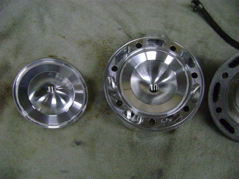

The new cool head next to the old.

The exhaust manifold is matched about as well as the cylinder
PostPosted: Fri Feb 29, 2008 5:01 pm
at least the head port is smaller than the manifold, the other way around would be worse.
PostPosted: Sat Mar 01, 2008 2:05 am
Both directions is bad, look at the animated gif below, when the returning pulse wave from the pipe is trying to stuff the fresh air fuel mixture back into the pipe... Every ATVR Engine I look into their is all these details that are over looked, they must save all the highly detail work for the engines they put on the dyno?
