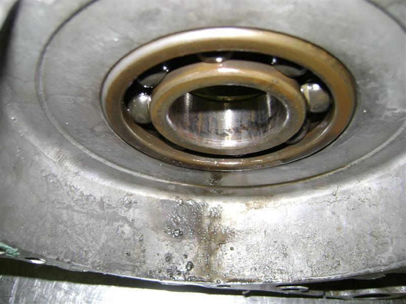

I looked closer at the bottom end this morning their was metal parts of the piston down the oil galleys and behind the crank bearings so I split the cases, I know this bottom end didnt have a lot of hours on it but it had to be done all it takes is one of them chunks of aluminum to mess up one of your crank bearings then you end up with another dune trip cut short and pissed off again :shock:
Green arrows is pointing to the metal chunks behind the bearing.

Whole bottom end is peppered with metal from the piston.

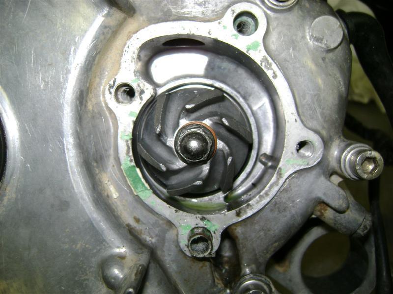

To rule out over heating issues with this Engine I pulled the water pump cover to make sure the impeller was still their, connected and working, it looks ok, only thing I seen wrong is who ever was in the water pump last didnt clean off ALL the old gasket, you can see the black gasket material under the green.

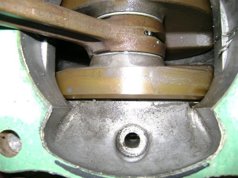

Here is just a picture of the bottom of the balancer case the idea of this pic it so show how clean the case is and the lack of dirt and or metal shavings, this is where they usually accumulate.

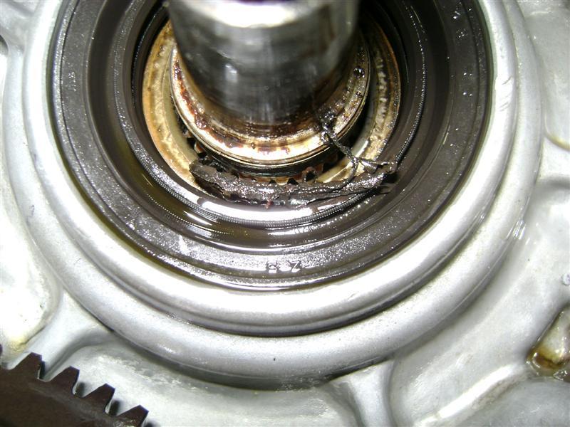

In the next few pics you can see the O ring that goes behind the balancer drive gear is cut up, their was a large chunk behind the crank bearing floating around, it looks to me that the wrong size O ring was installed then when the balancer drive gear was installed it cut off the over sized area as it was compressed.

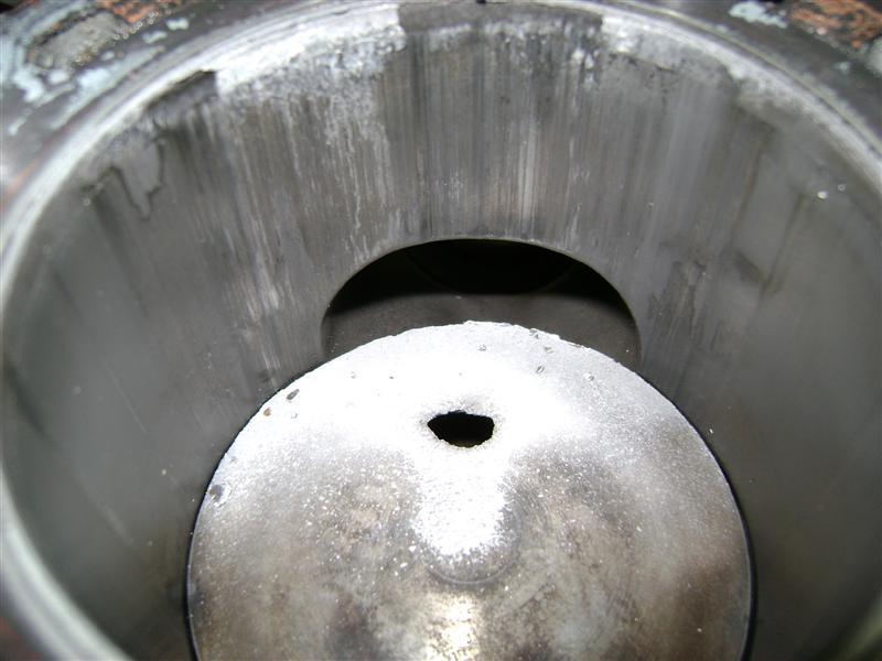

Took a closer look at the cylinder today, the only signs of "porting" I seen was they modified the exhaust, they raised it .201 or 5.12mm higher than stock, they left the width stock, its raised .155 more than I raise mine. HEY adnoh what effect will raising the exhaust that high have?
Most I ever seen a Pilot exhaust raised before this one was 4mm
The bore measured 81.07 mm and it needs bored again.
Before I do any more with the cylinder I want to figure out if raising the exhaust that high is the cause of this Engine going poofkaboom all the time under heavy load at the dunes.
Still gotta reverse engineer the head to see if that was cut wrong.

Top of the exhaust to the top of the cylinder was 1.617
On a stock Pilot cylinder top of the exhaust to the top of the cylinder is 1.818
