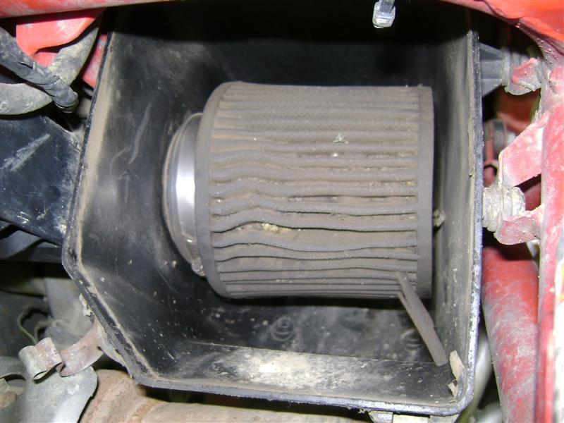

Here is Harescrambles K&N filter, Mr. Maintenance, a great example why you NEED a pre filter setup.
http://pilotodyssey.com/prefilter3.htm
File comment: As found...
PostPosted: Thu May 08, 2008 2:27 pm
I wonder if anything has been getting past the filter?
Yup, didnt see that one coming did you, hey you know "the dirtier the filter gets the better it filters" K&N filters are good for ON-road applications or you better have a serious prefilter setup.
PostPosted: Thu May 08, 2008 2:29 pm

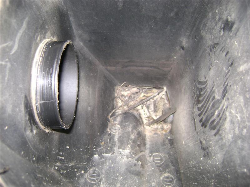

I stuck the camera right in the air box and started taking pictures here is the as found.
PostPosted: Thu May 08, 2008 2:30 pm
Here is the stuff he is collecting in the bottom of the air box.

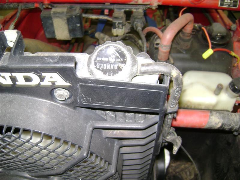

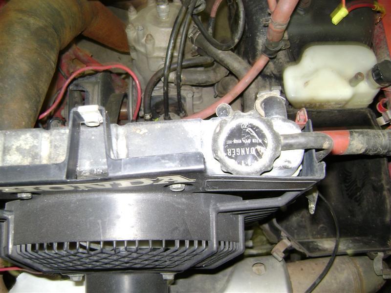

I need full access to the wire harness so we can resolve this fan issue, I removed the radiator plastic, the radiator is all bent up on top.. Cap smashed and the neck/top of radiator bent up.

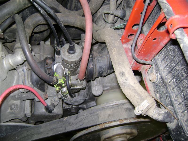

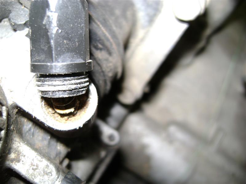

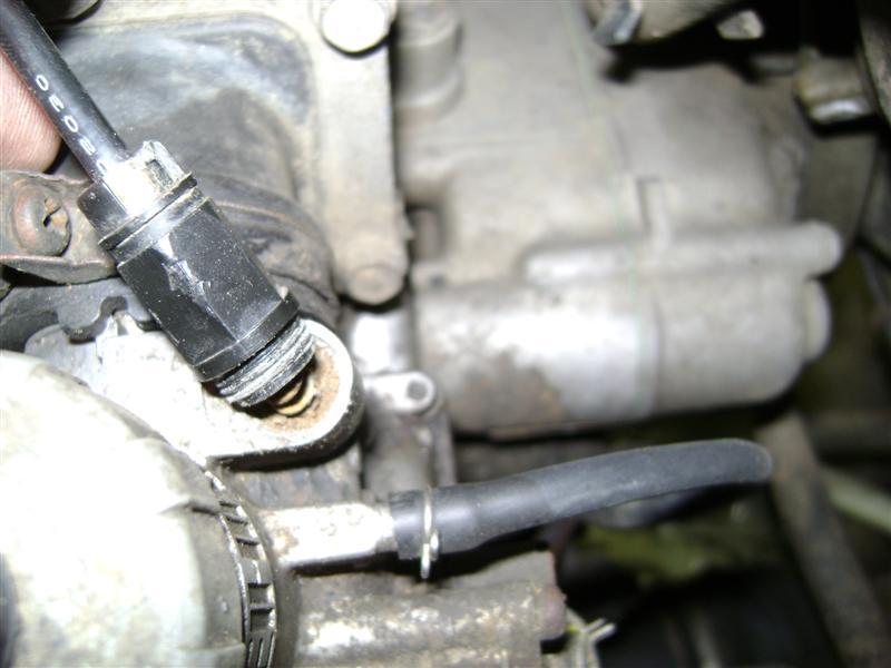

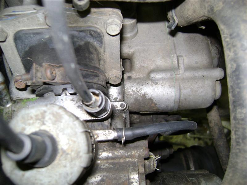

File comment: See the missing hose clamp on the coolant line that goes to the carb.
PostPosted: Mon Nov 10, 2008 4:56 pm
Coolant leak by carb?

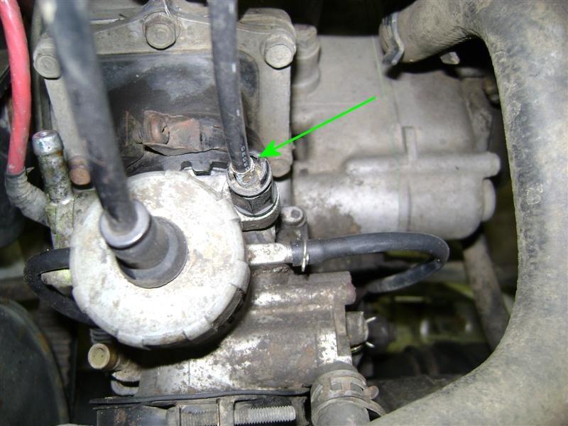

Look at the rubber on the choke cable, have you checked yours today? If not go check it, old rubber don't SEAL, this would be a good time for you to go put a dab of silicone sealer around yours even if it looks good!

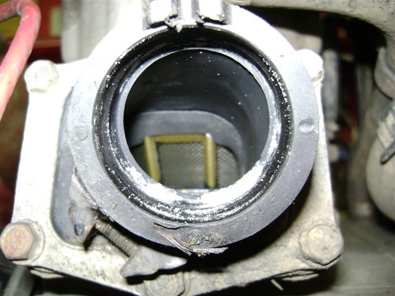

PostPosted: Mon Nov 10, 2008 5:01 pm
STOCK reed cage with CF reed petals
File comment: Someone already flipped one side of the reeds over, upper right reed petal the corner is chipped.

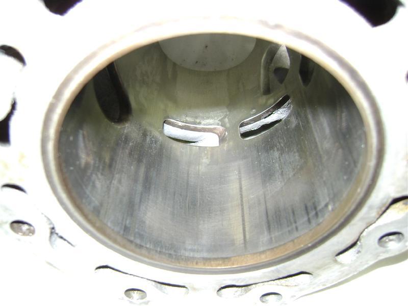

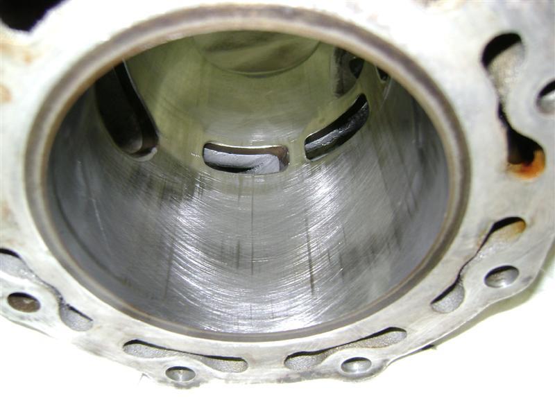

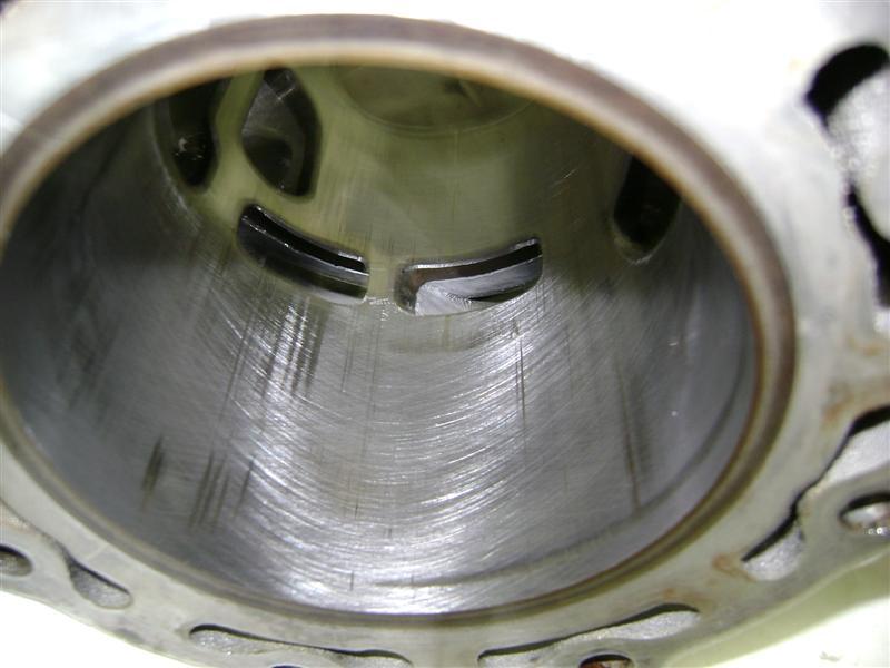

Its hard to see in the pics but I can see plenty of scuffing on the cylinder wall, the cylinder must be pulled for inspection.

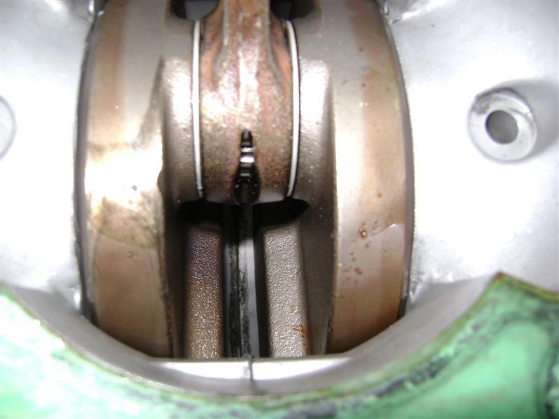

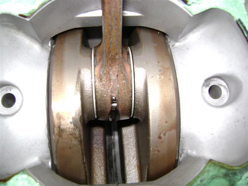

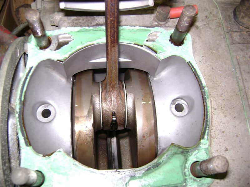

Cylinder off, the bottom end seems clean and tight.
File comment: Can see where the rod had made contact with the cases at some point in time, assume the rod was replaced since its so tight now...

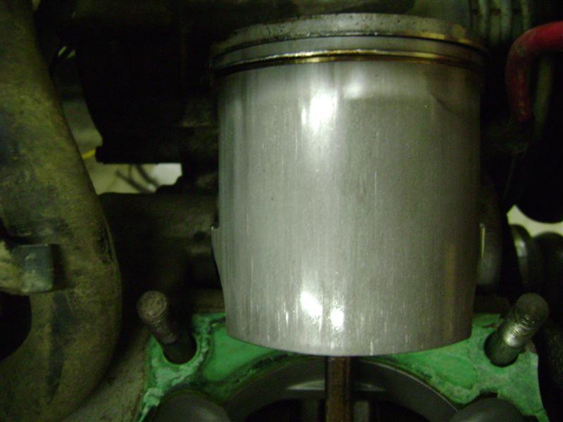

You can see where the "more flow" of the K&N really comes into play in these next pics, see the dirt scuffing on the piston skirt?

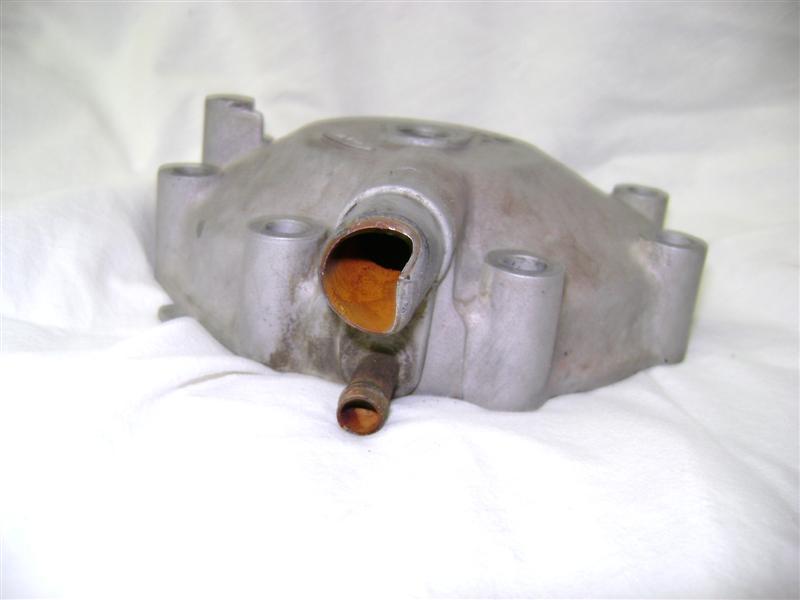

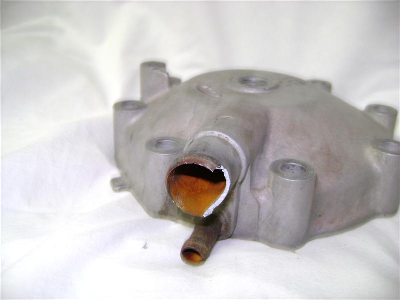

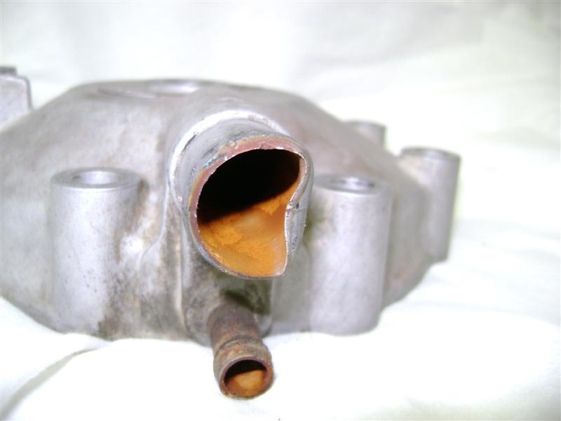

Hose connection on the head bent in bad, enough to cause a serious flow restriction, I have straighten 3-4 of these in the past with good success.
PostPosted: Mon Nov 10, 2008 5:11 pm
Murphys law, that's aluminum! you can straighten a bunch of them then one will break :shock:
Its still usable their is still plenty of surface area for the hose and clamp to hold/seal.. Still pisses me off it broke!
Either way the problem needed corrected.

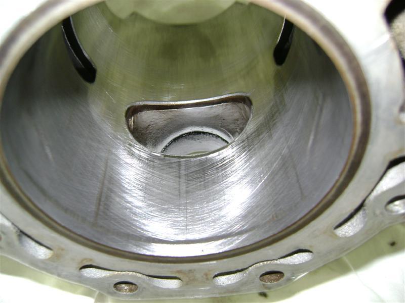

The next series of pics are the as found cylinder pics.
File comment: GO K&N!!!

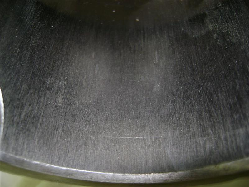

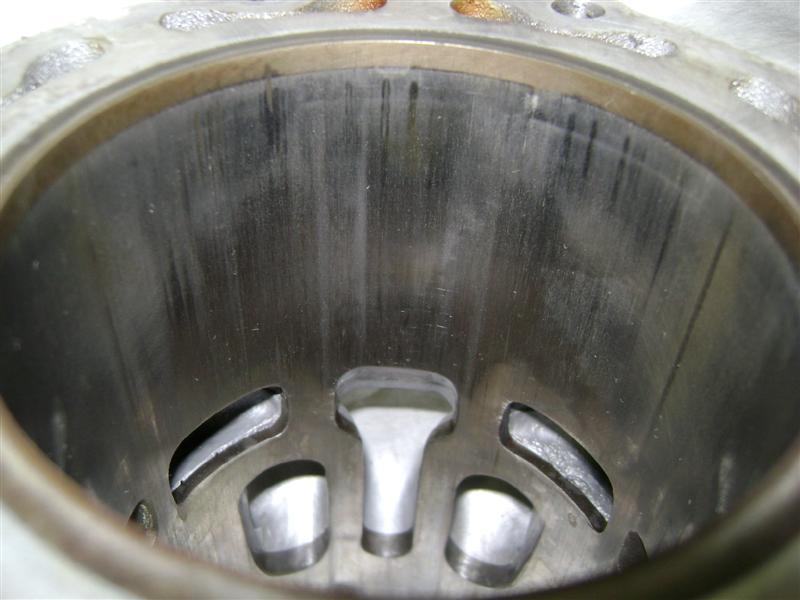

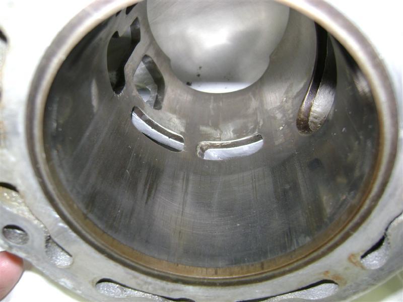

PostPosted: Mon Nov 10, 2008 5:14 pm
Cylinder after lite hone with a AN-112 Sunnen ridged stone hone not a flex hone or ball hone
The cylinder measures 3.209
The piston measures 3.196
Do the math .013 clearance...
