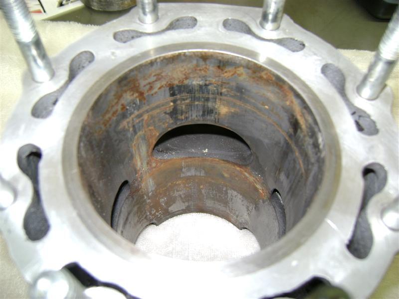

PostPosted: Sat Jun 07, 2008 5:03 pm
Some as found pics of the cylinder, plenty of aluminum stuck to the cylinder, muriatic acid will removed this.

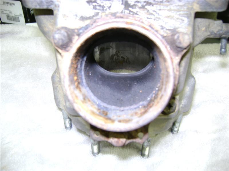

PostPosted: Sat Jun 07, 2008 5:04 pm

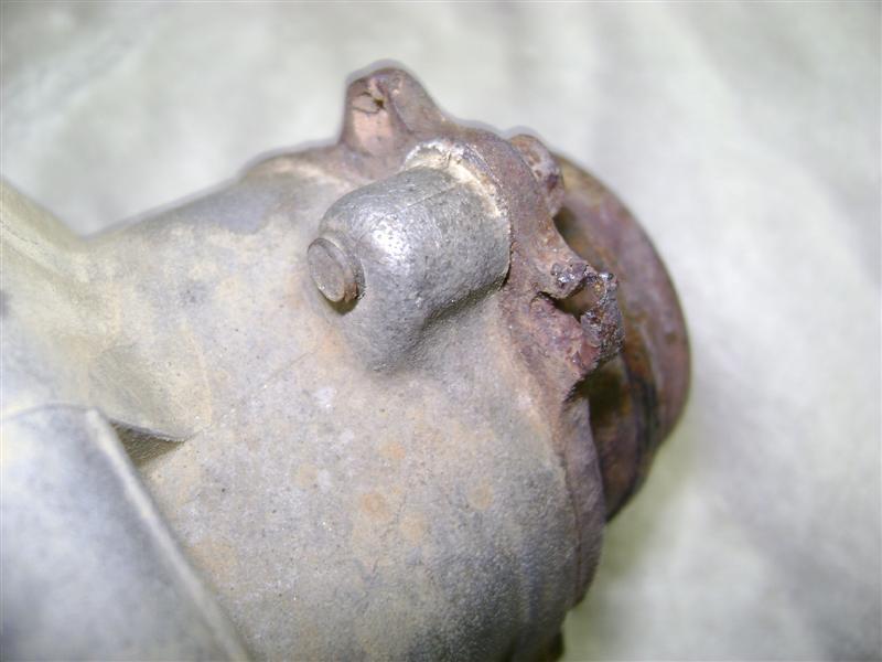

The tabs on the exhaust manifold are about worn out.

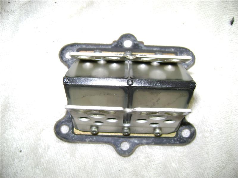

PostPosted: Sat Jun 07, 2008 5:13 pm
Reed cage

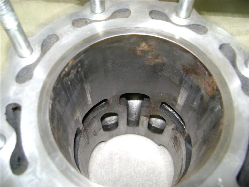

Now the intake exhaust and studs are remove its time to remove the aluminum smeared on the cylinder walls

PostPosted: Sat Jun 07, 2008 5:18 pm

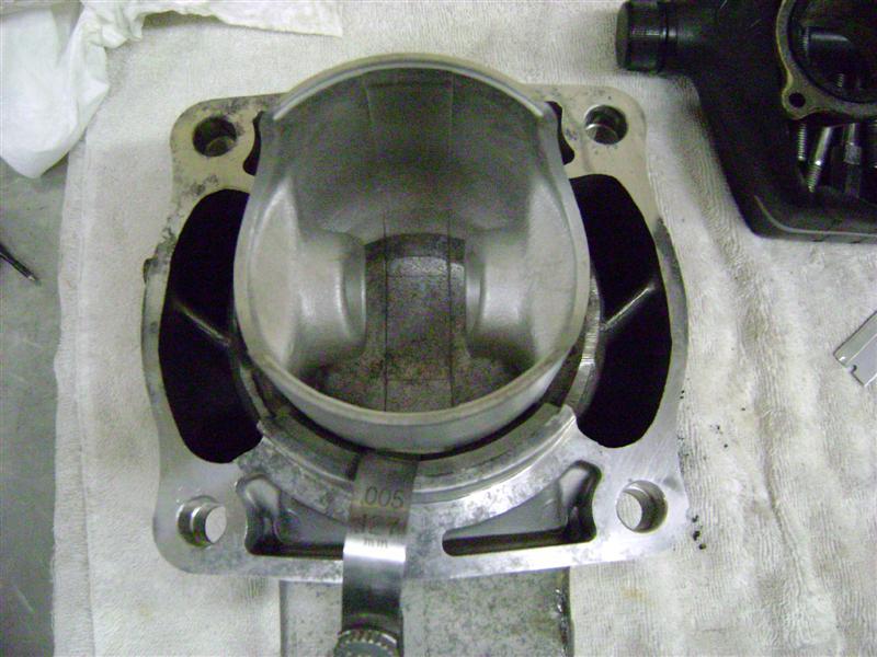

Once the aluminum was removed I took a new stock piston to check the clearance the quick and dirty way, that's a .005 feeler gauge this cylinder will need bored to the first over bore.

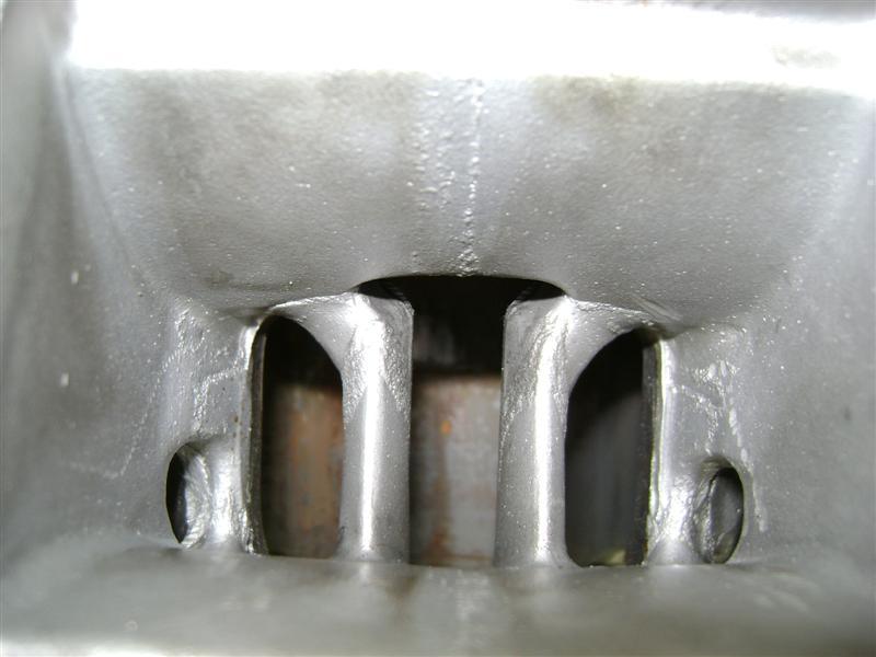

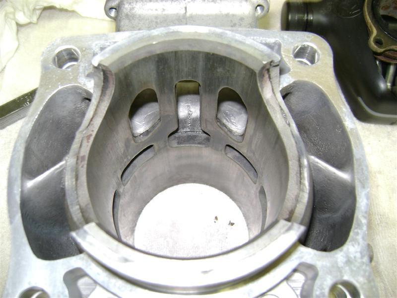

Update, I remove the studs, exhaust manifold, reeds and intake, lapped the top of the cylinder so its flat again, bored and honed to fit new piston, beveled the ports, I cleaned up a few of the real nasty casting flaws too, their was a huge one in the exhaust port.

I touched up the exhaust manifold pretty much the same as done here http://pilotodyssey.com/manifoldrepair.htm
I put some copper wire in the holes then welded it a little, file it down then bevel up the back side of the hole like factory.
