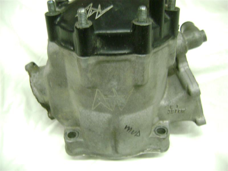

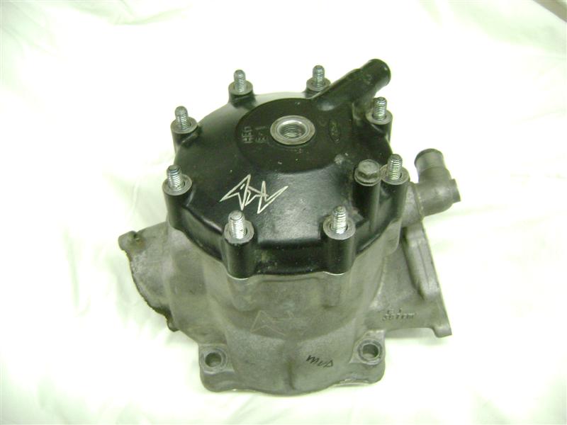

PostPosted: Sun Mar 18, 2012 1:42 pm
Mudbogger sent me a cylinder and head that was "ported" by ATV Racing?? I can only assume it was done by ATV Racing because I have never seen one that was lettered up on the cylinder and head like this one is in the past they just scratched a single line letters on this one they spent more time doing a outline theme.
Anybody know for sure?
Anyways Mudbogger wanted a CSI and to bore it to fit the piston he sent.

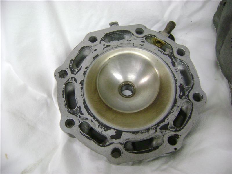

PostPosted: Sun Mar 18, 2012 1:45 pm
The head, I will cc the head see what they done usually they are 46cc's or less when you see aluminum smeared on the cylinder wall lmao whats really funny is they charge like 100 bux to machine the head turning your Pilot into a piston eater poofkaboom machine.
viewtopic.php?f=25&t=3495

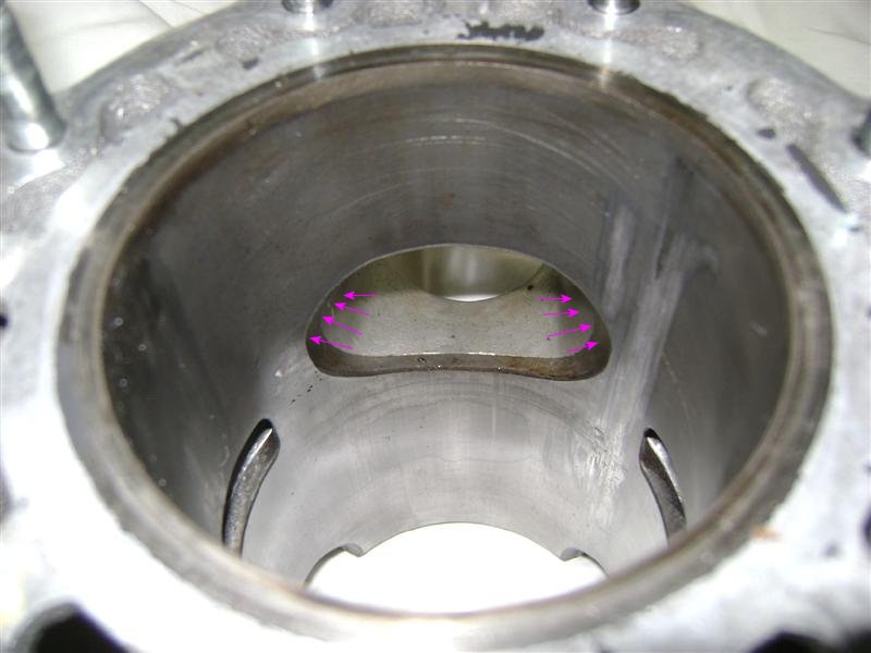

PostPosted: Sun Mar 18, 2012 1:49 pm
The exhaust port tunnel has a really stupid shape to it looks like they made the port opening changes (wider/higher) just at the opening then never finished the port tunnel, rookie mistake who ever did the work on this cylinder must have skipped a few chapters or books.

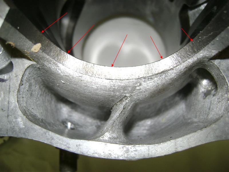

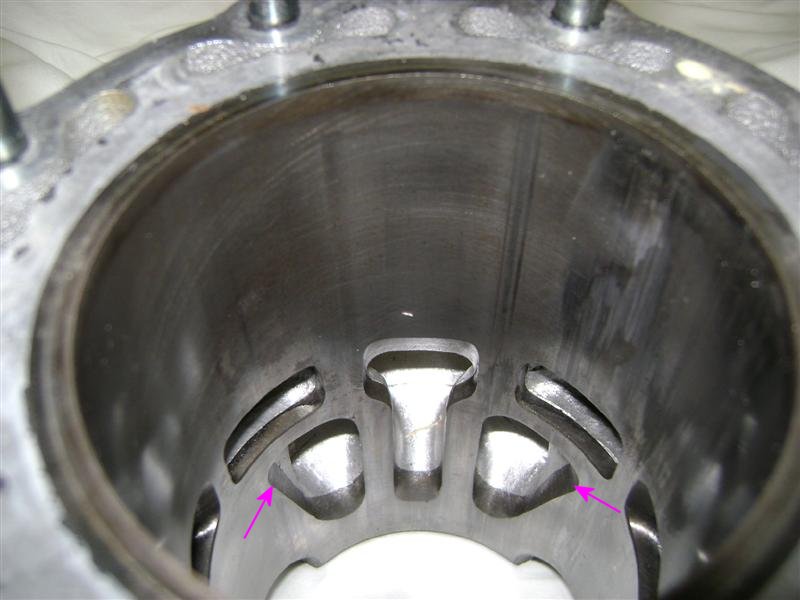

PostPosted: Sun Mar 18, 2012 1:51 pm
They made two of the intake ports really wide at the top no real advantage for this again they missed a few chapters on filling and evacuating a combustion chamber sad to say their is no way for me to fill this in and undo the butchery its something you have to live with.

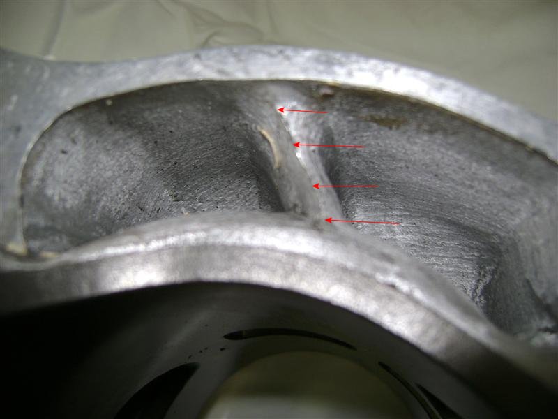

PostPosted: Sun Mar 18, 2012 2:01 pm
Another rookie mistake putting a knife edge on the entrance to the transfer port tunnels, its a old school mistake.
No book required for this one do your own test, go to the kitchen get out a butter knife, take it to the sink turn on the water run it over the edge of the knife watch the water flow over the blade noe change the angle of the blade about 1/2 degree watch the huge changes to the flows over the edge, anybody that studied Leonardo Da Vinci probably seen his stuff where he spend months at a small stream studying "flow" over different objects.
