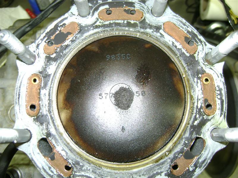

Slickrick sent me his ATVR Engine that Poofkaboom after a few short hours for a CSI
Can you tell us the whole story on this, what ATVR did, how many hours on it, type of use etc. more info the better.
A few questions
What needle are you running in this carb, it has a 40 slow jet and a 172 main jet.
What brand and octane gas
What brand oil and at what ratio
I need a 80.5mm wiseco piston kit.
Also need a head gasket and a cylinder gasket these can be wiseco or Honda what ever you prefer, ATVR used Honda gaskets.
Ask around for the best price on the piston kit prices very quite a bit, afastcar just bought two...
Typical ATVR the head is cut wrong I forget how many this makes now I have lost count, more than 7 heads for sure...
I wish they would give up trying to machine heads so they would quit frying engines and making the CUSTOMER pay for their mistakes..
If this was my Engine I would buy a Speedchaser head, maybe you can sell your current head back to ATVR...

ATVR fail

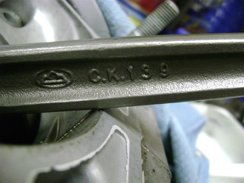

Bottom end looks good and looks fresh, looks like they installed a new rod, a HOT ROD

1. ATVR completed a laundry list of items about three pages worth that totaled $5,014. I could list everything but it might take a while so ill bring the receipt to glamis to have you go over it.
2. Hours-I would say a total of 18hrs
3. I run 91 octane form my local chevron with techron
4. I use Maxima castor oil and run 32:1
5. Riding terrain is Arizona desert. Local riding areas consist of Bulldog canyon, Sycamore creek and saguaro lake. I will try to post some picks of the riding areas mentioned.
6. When the car ran it ran great. There was a huge noticeable power gain compared to my stock pilot. When breaking it in. I would warm it up utilizing the verbal instructions given to me by Luke, one of the ATVR techs. Hold the throttle about a quarter of the way until the cooling fan kicks on. I ran two tanks of gas through never holding the throttle in one position and never full throttle until running through two tanks of gas.

PostPosted: Thu Dec 31, 2009 6:42 pm
Slickrick, I would like to play with it since it's junk. "H" did the pin slid out of the piston or did you have to press it out. Just wondering if the piston went square.
