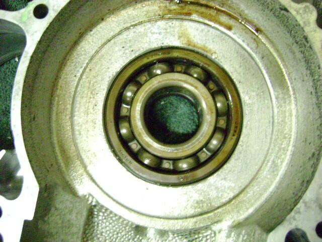

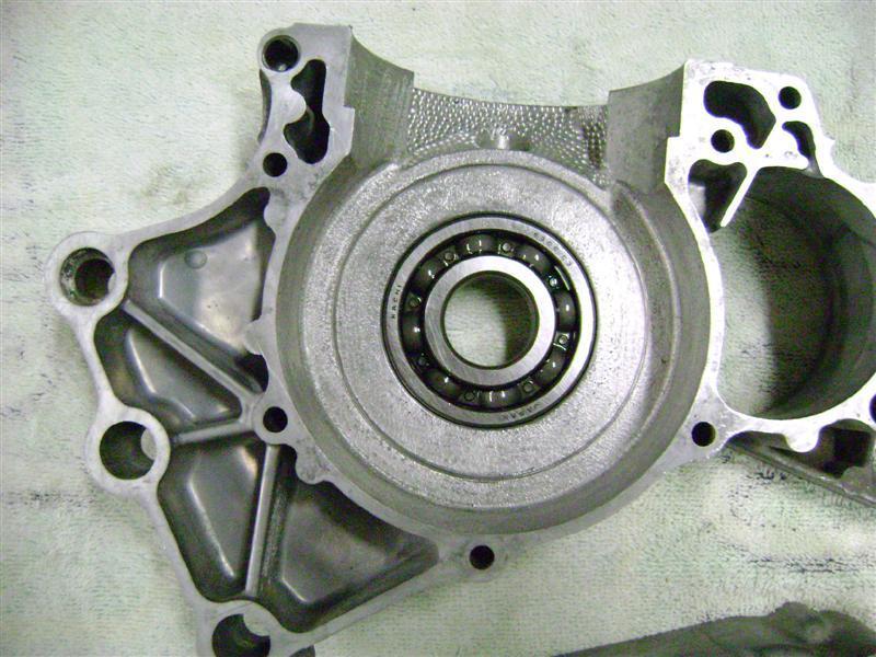

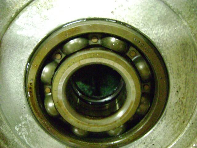

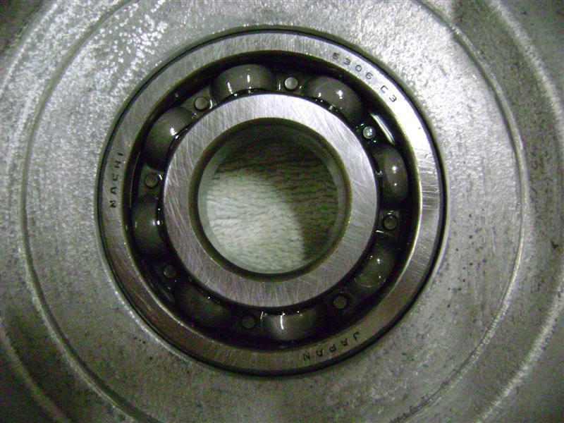

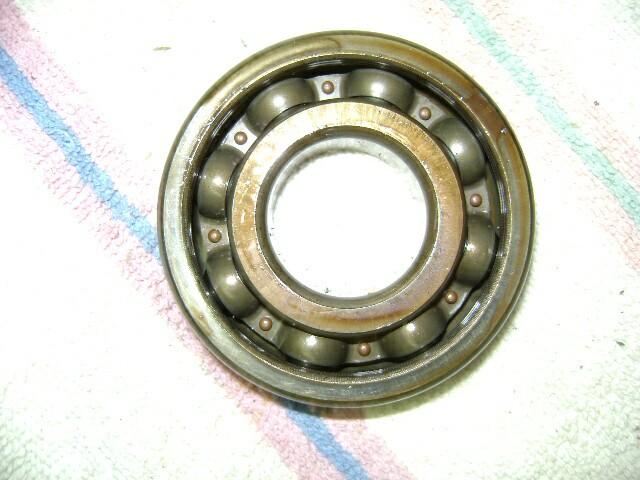

I split the cases, the rod bearing is bad, it did not go so bad it trenched the cases just enough to lock up.
For those of you keeping track of the Pilot crank bearing saga please note the crank bearings are LIKE NEW, no play, no ghosting on the balls or races, no discolorations heat trails etc. they will NOT be reused NEW bearings, seals, gaskets, crankshaft, piston, rings, wrist pin, wrist pin bearing, C clips are on order and will be here any day...

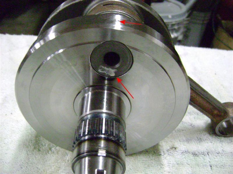

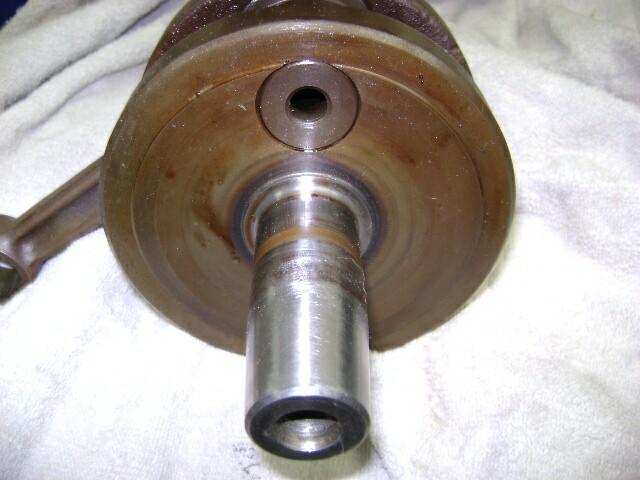

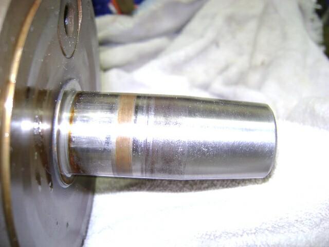

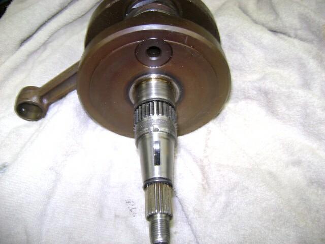

PostPosted: Tue Jan 08, 2008 4:23 pm
The crankshaft itself is in GREAT shape, NO grooves worn where the crank seal rides, NO HAMMER MARKS where it looks like it was BEAT TOGETHER, NO galling where the bearings were, no signs the inner race of the bearing has spun on the crankshaft.
Once I get the parts cleaned up I will take more detail pics and post.

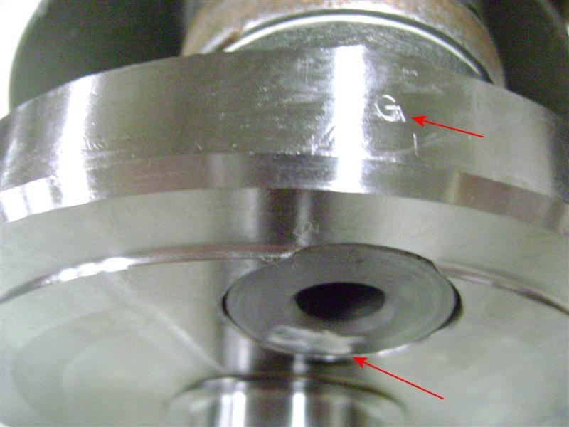

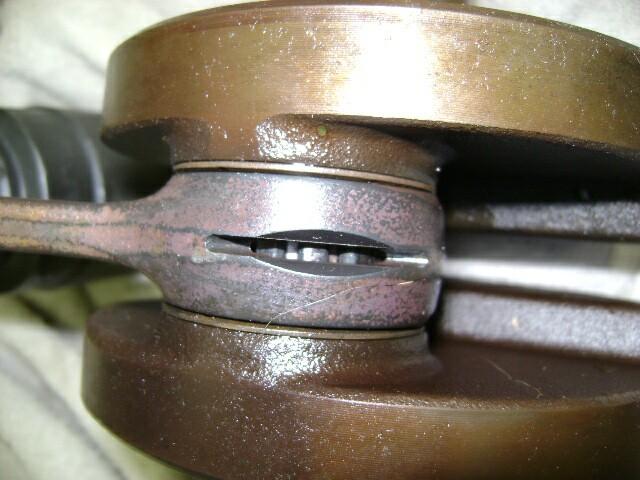

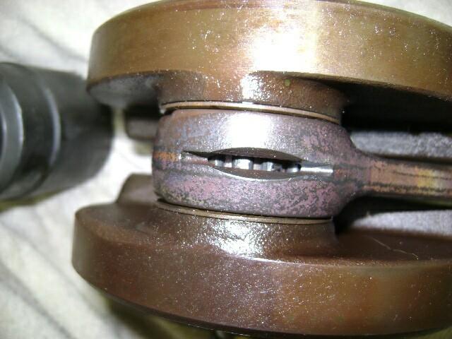

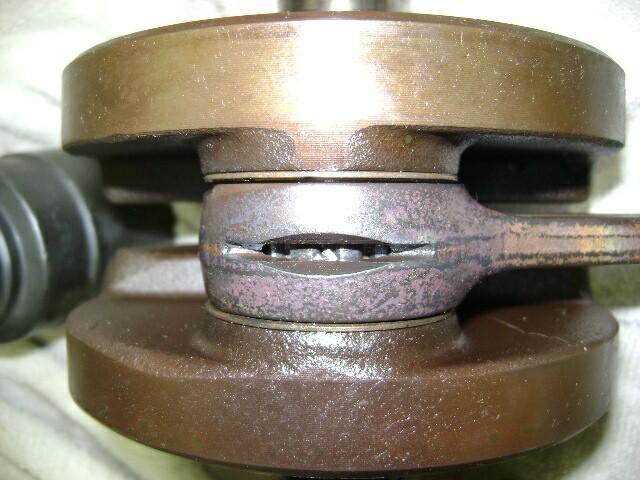

PostPosted: Tue Jan 08, 2008 4:26 pm
If you look close you can see the cage that separates the bearings is worn flat, it is actually locked on, fused to the crank pin the rod just spins around the bearing.

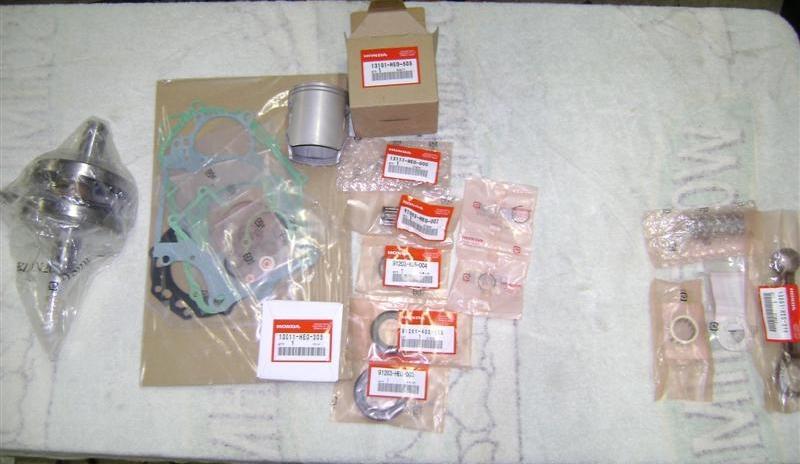

PostPosted: Sun Jan 13, 2008 6:17 pm

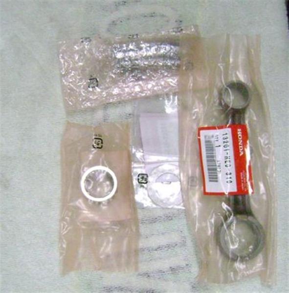

New parts :-)
New rod assembly for the crank I just removed.

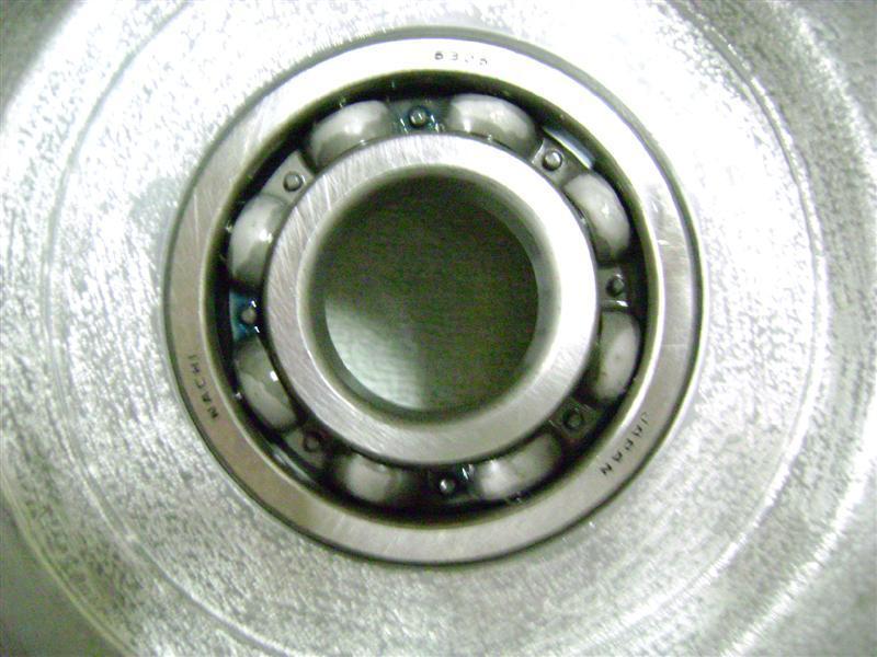

PostPosted: Sun Jan 13, 2008 6:20 pm
New bearings installed in the cases.
