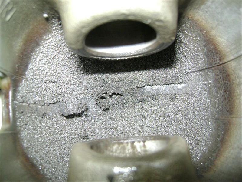

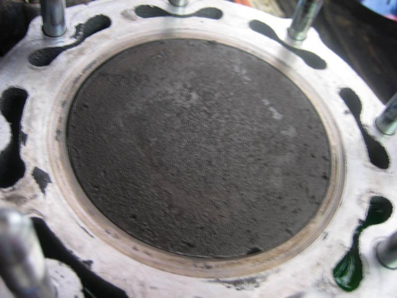

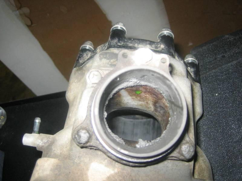

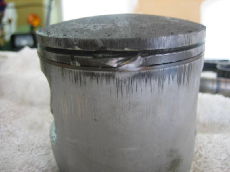

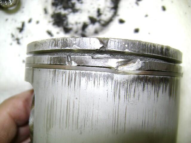

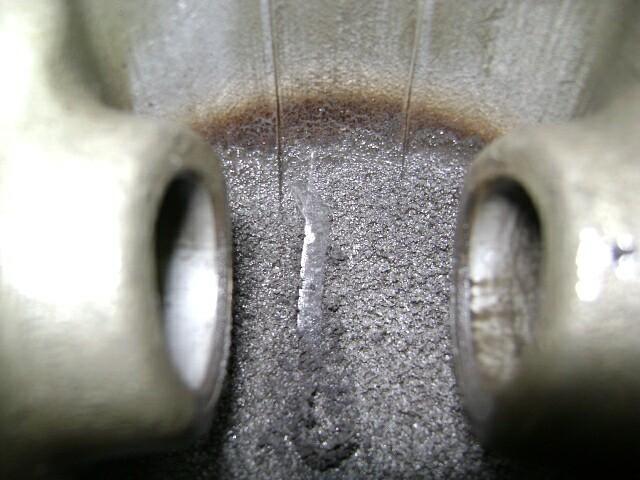

out in ecj pilot started loosing power then shut down. After thinking it was just something simple, Hare pull on the pull start and didn't even break a sweat. NO COMPRESSION.
Here is what I found.

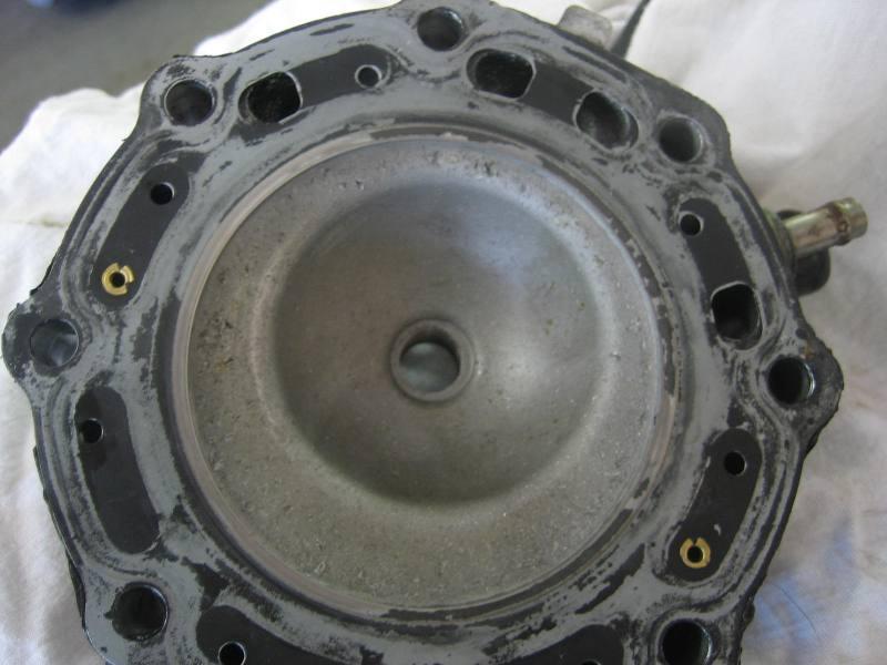

File comment: top of piston in jug, notice the chunk missin

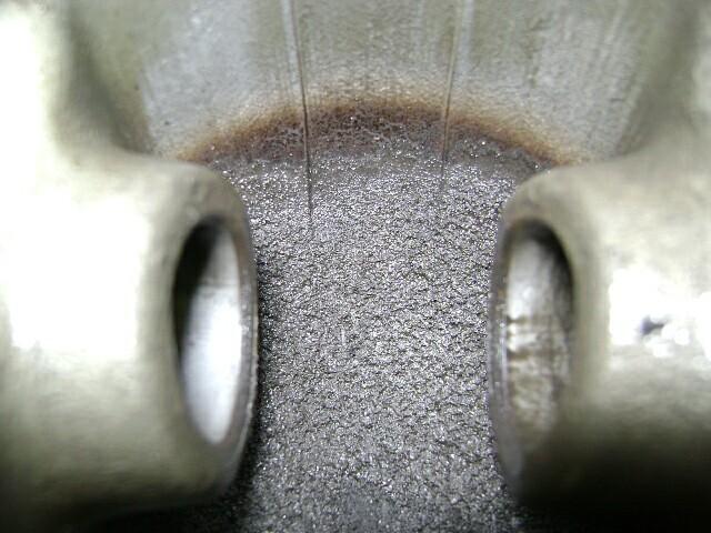

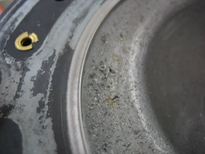

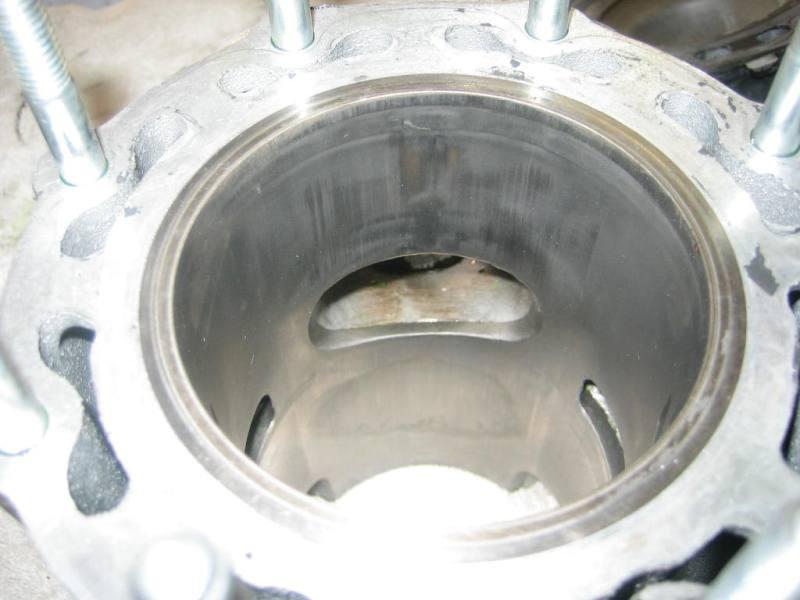

File comment: inside of head

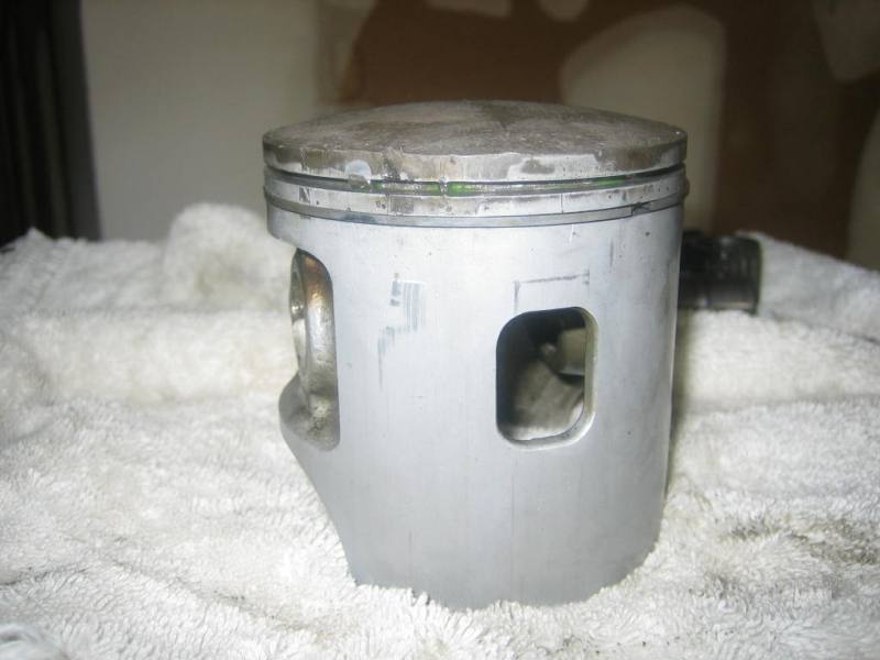

File comment: piston missing top ring
File comment: top ring missing a part I cannot find

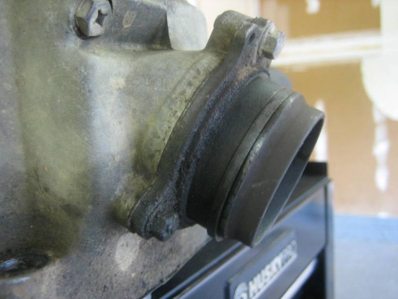

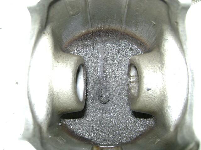

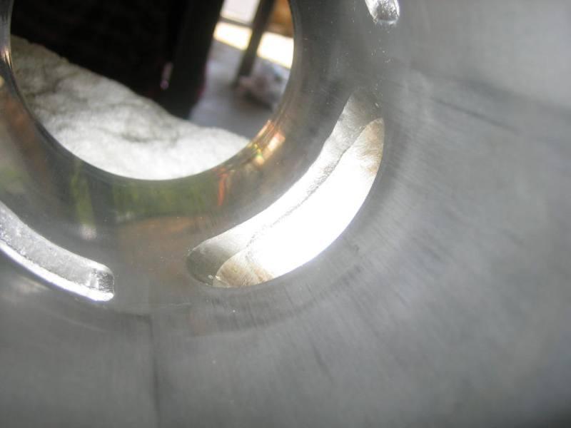

is it possible that the missing part of the ring has just shaved down to nothing and disappeared?
The bottom end of the motor (( Internal Combustion Engine ? )) seems nice and tight and moves smoothly with no signs of particals.
Jug also looks in good shape to me....maybe a hone. With a new piston and rings and seal kit, I could be off to the races in no time.
What you guys think?
PostPosted: Sat Aug 18, 2007 4:31 pm
WOW!
Locate that missing part of the ring, you can put a small CLEAN towel by the rod then SLOWLY rotate the crank around and the rag will follow sweeping as it goes then once you do about a 360 you can carefully remove the rag to see whats on it.
What pipe and silencer are you running?

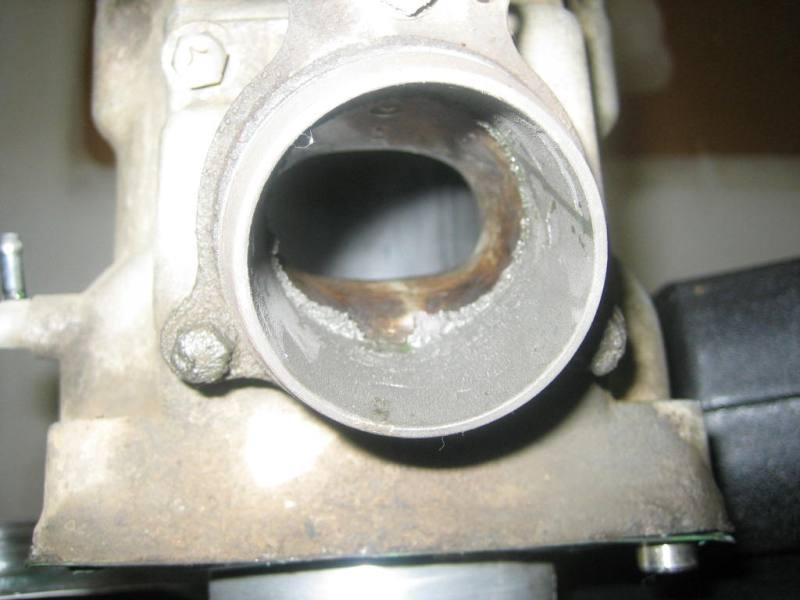

Sow me pictures of the exhaust manifold inside and out and also the pipe inside and out where it connects to the cylinder.

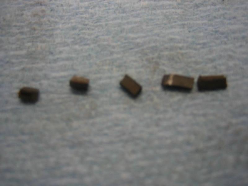

Shake the pipe is the missing ring inside the pipe silencer?

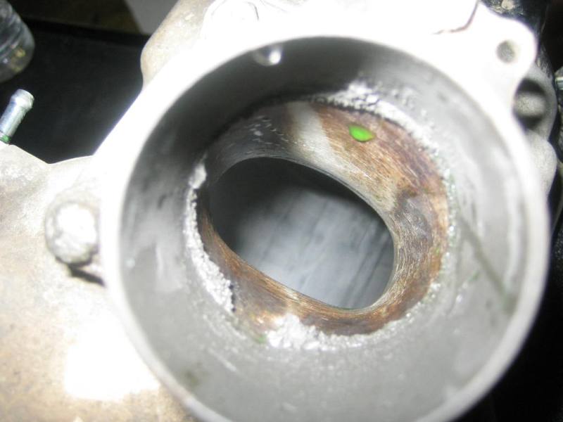

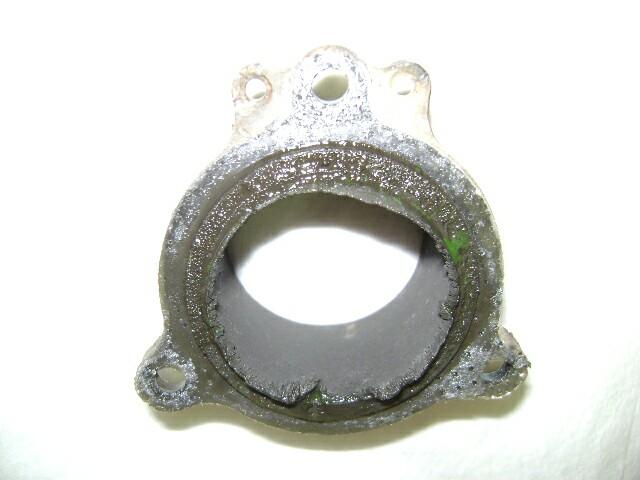

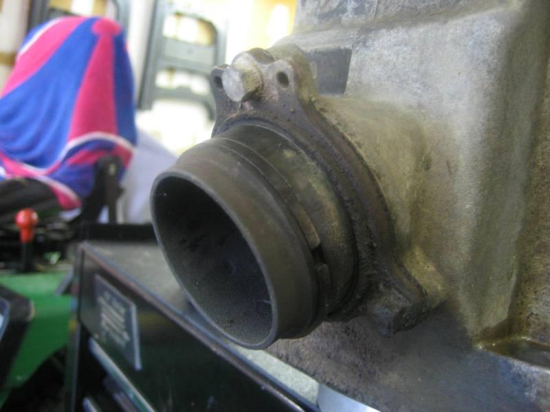

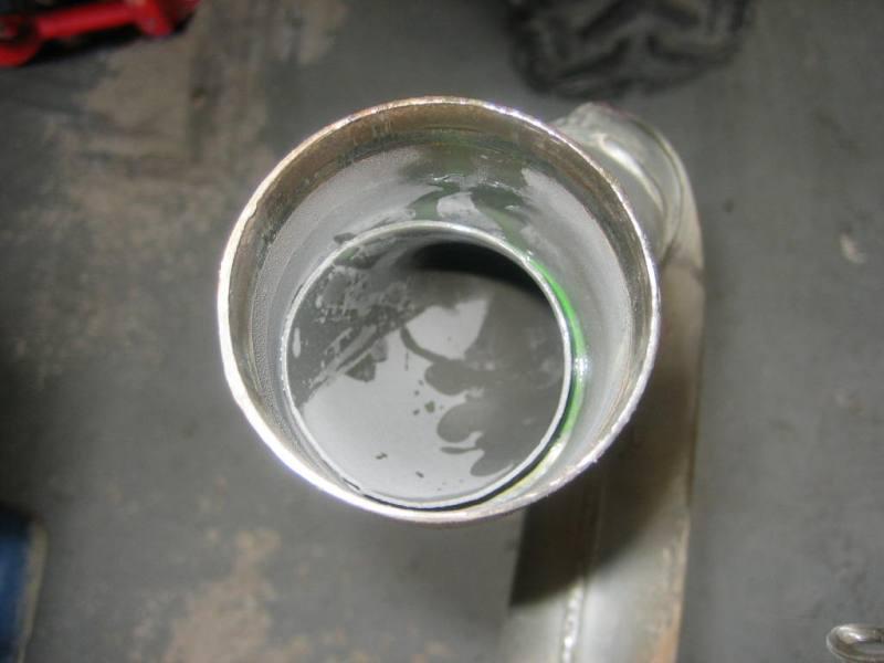

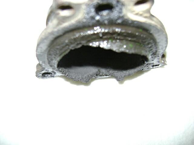

picks of exhaust manifold and also some parts I found after you ask me to shake out the silencer.
I'm using a torque pipe an silencer from Marv
File comment: pcs. found in the silencer

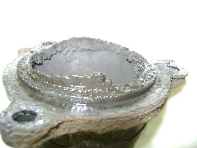

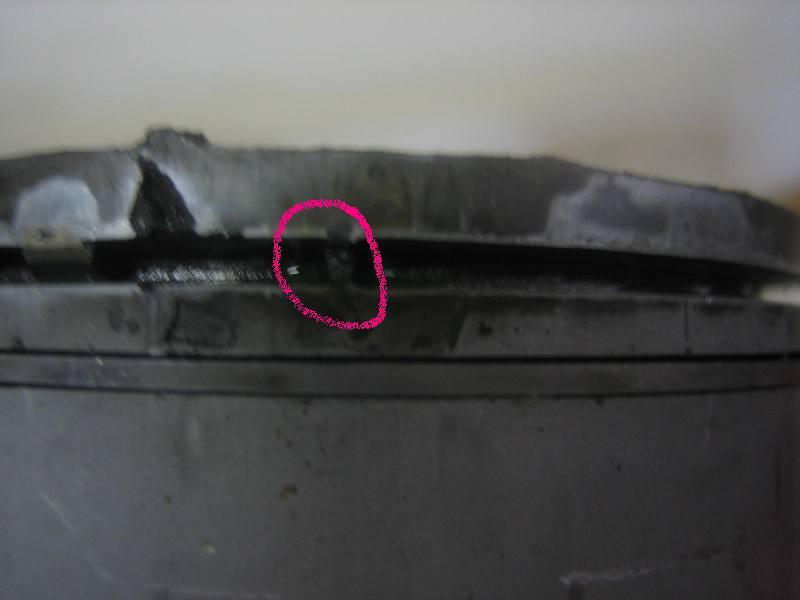

I see some things I don't like, go here and read this viewtopic.php?f=109&t=13671
I need you to remove the exhaust manifold and stick it in the pipe and take some pics so I can see how it matches the pipe...

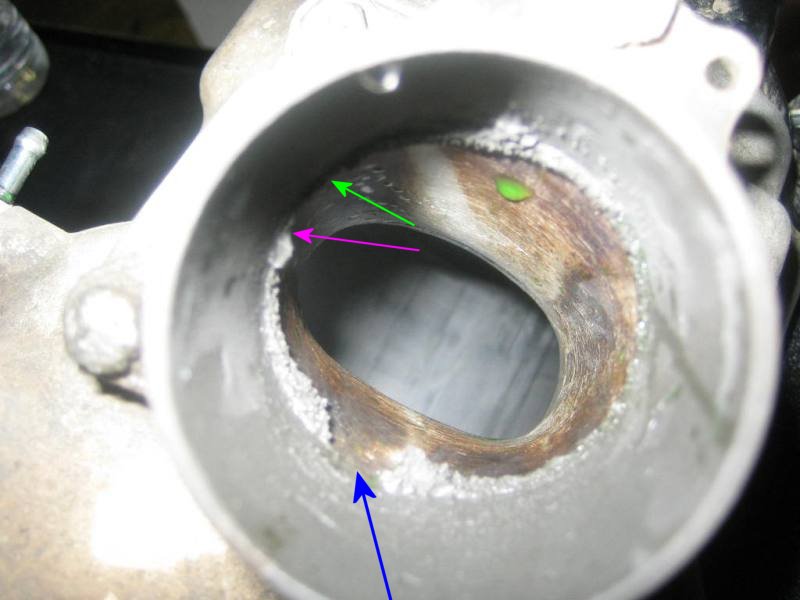

PostPosted: Sat Aug 18, 2007 6:31 pm
What kind of oil are you using and at what ratio?
I don't like the size of the buildup in the exhaust manifold where the blue arrow is did that piece get sucked back into the Engine?
look how far the piece sticks out where the pink arrow is and were the green is pointing is that missing or was never their?
PostPosted: Sat Aug 18, 2007 6:32 pm
The size of that piece is scary!
Try to preserve it if it falls off send it with the parts please.... it evidence... :-) I want to run it through the hoser labs

Some of those pcs may be what is stuck to the head. You can do your analysis when you get it.....I will send you the pipe and silencer too.

That is very similar to what happened to mine. Your top ring ends have migrated around to the exhaust port and nipped up. Where as on mine it was the bottom ring. Can you still see the top ring locater pin?

PostPosted: Sat Aug 25, 2007 5:21 pm

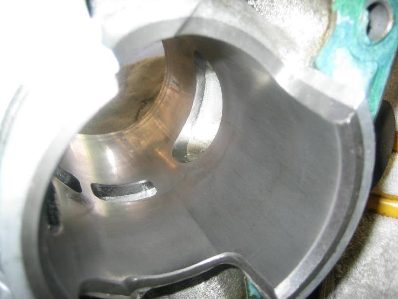

Here are some more pics I took the wet look is from the antifreeze other wise it would be dry looking.

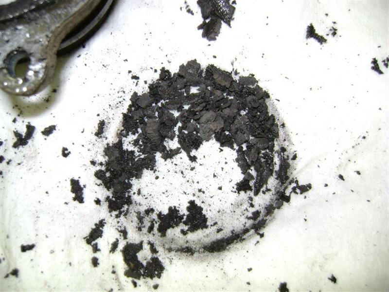

Stuff I scraped out the inisde of the exhaust manifold..

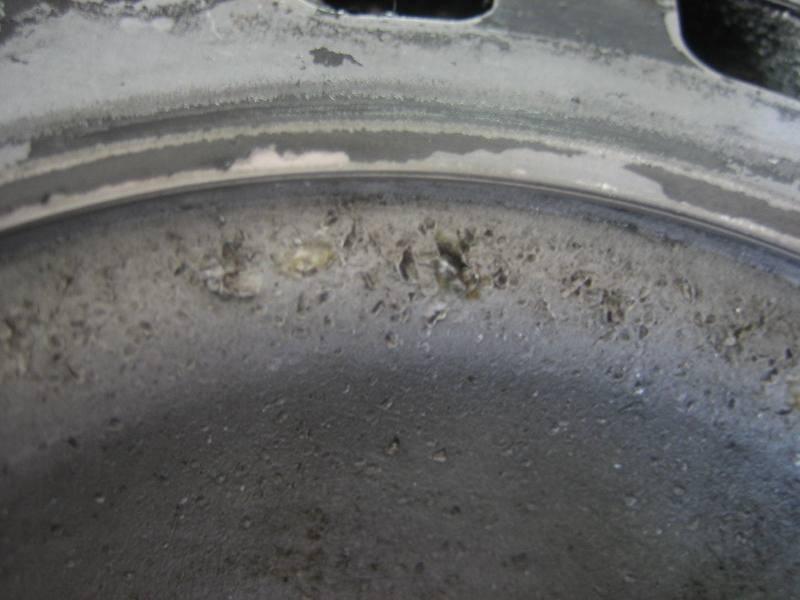

PostPosted: Sat Aug 25, 2007 5:24 pm
Bottom side of the piston, I scraped it with a screwdriver.

How many hrs on this since the rebuild?
PostPosted: Sun Aug 26, 2007 1:17 am
Posts: 631
Location: Fredon,NJ
Where does the carbon build up form from?
Is it poosible to be the oil?
Is the cause of this the breakoff of the carbon getting sucked into the cylinder?
Coolant never needed to be filled after topped off from the first time after the rebuild.
Check coolant - it is free of oil and black peeper - looks clean.....
hours on Engine are between 25-30
