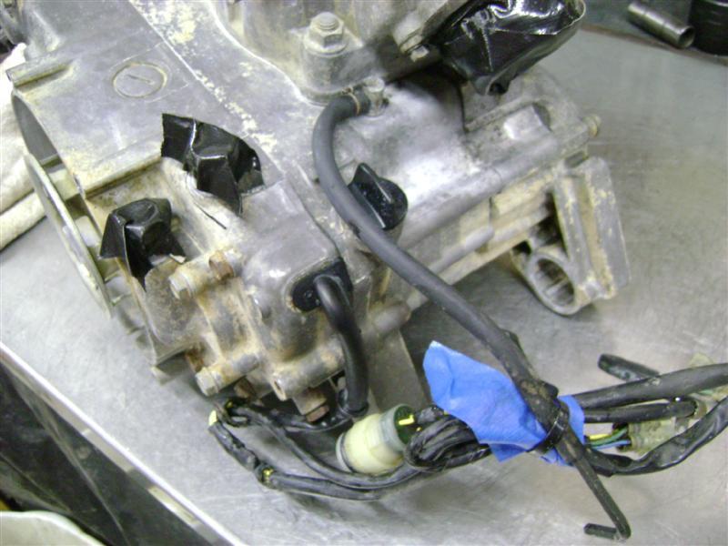

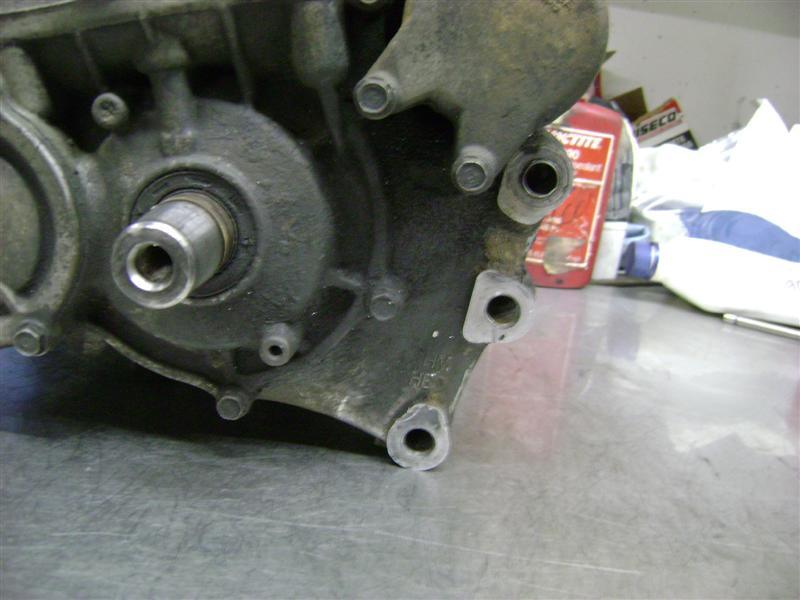

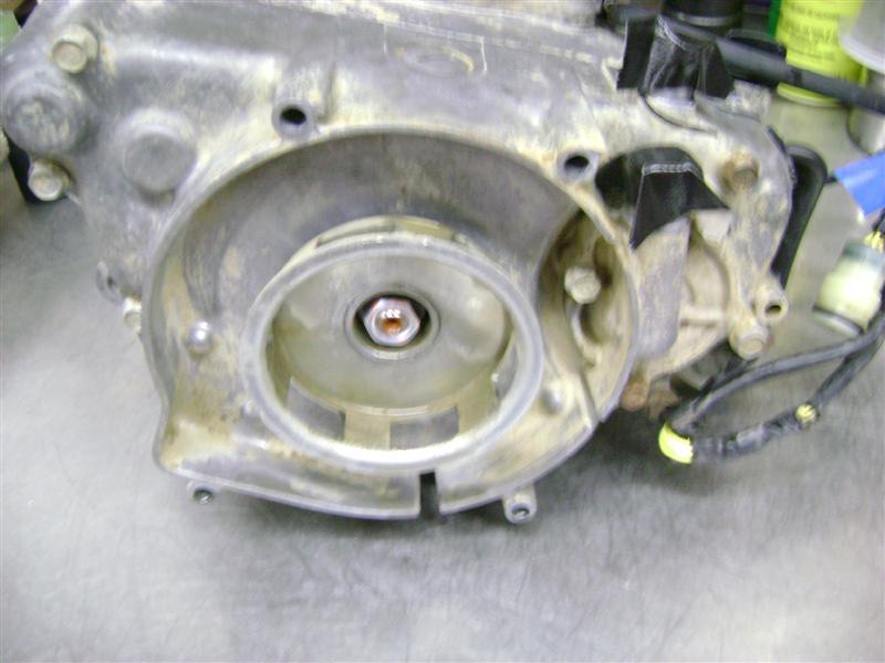

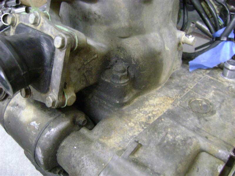

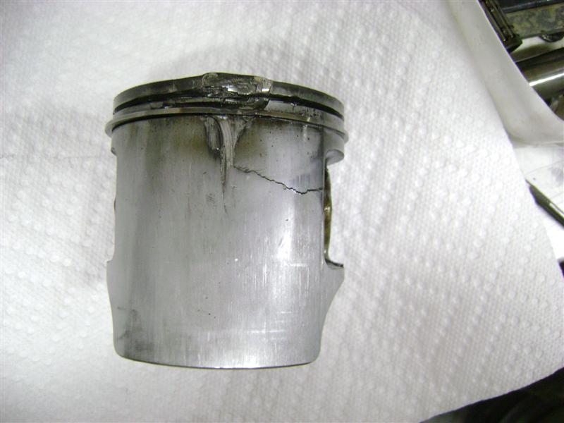

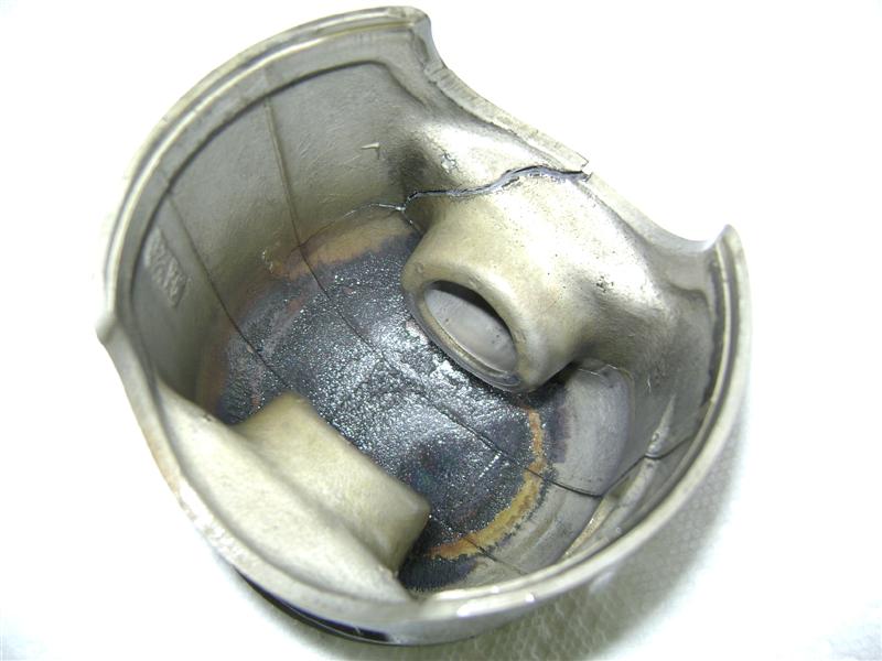

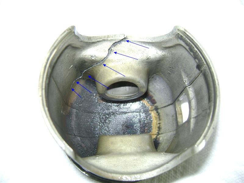

The parts tell the story, cracked piston, broken ring, part of the ring missing make sure you check your entire exhaust system see if you can find the other part of the ring it went some place.
The piston was run way past its lifetime, all the factory machine marks are worn off the piston.

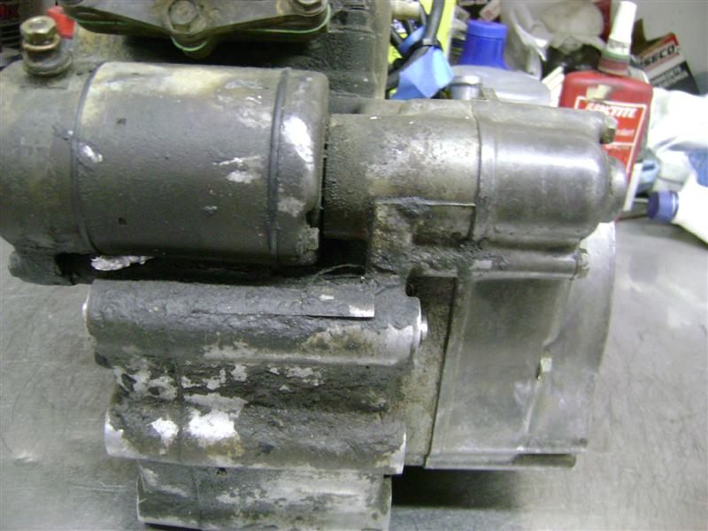

Engine came a dirty greasy mess you said the trans seal was leaking a while?
Sealed her up and off to the sink for a good scrubbing to remove the first layers so a autopsy can be performed without getting a bunch of crap inside during dis-assembly.

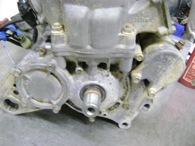

PostPosted: Fri Apr 09, 2010 2:32 pm

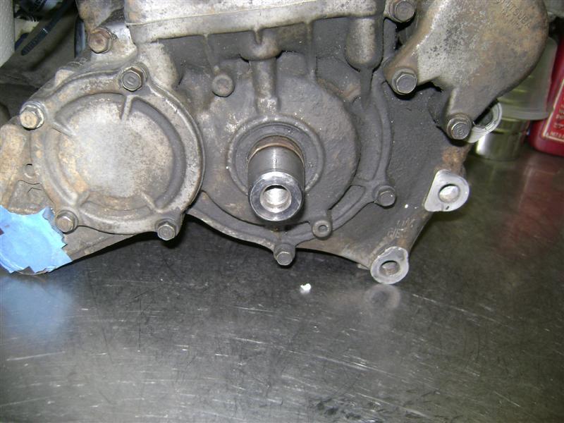

After the bath at least removed the first layer..

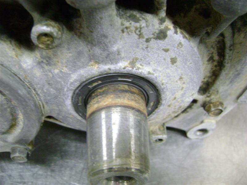

File comment: Heavy rust on the crank between the seal and the clutch

Here is the piston

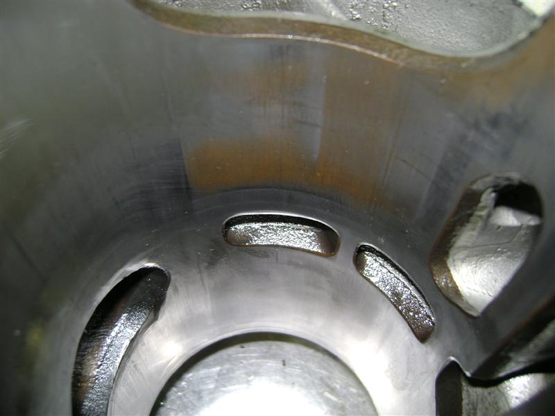

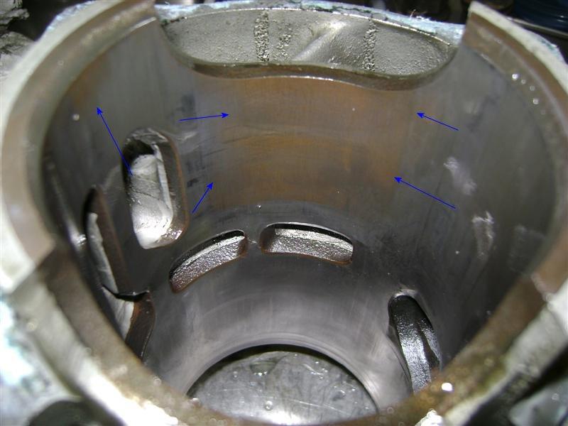

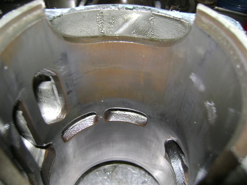

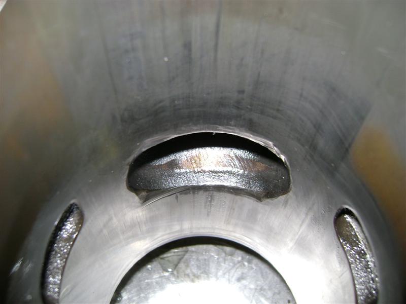

Next on my list is to go pull the studs out of the cylinder and put the cylinder on the boring bar and start boring it out to see how deep the damage goes and what size piston you will need, just as a guess it will be several bore sizes to clean it up..
Look at these next pictures that is RUST on the cylinder wall, after your done running this thing for the weekend or ride trip you need to let it idle with the choke on until you almost flood the thing, this will put extra gas and oil in the Engine, yes the gas will evaporate sooner or later but it leaves extra oil on parts, THEN every few weeks you need to hit the starter and let the Engine crank over a few times to keep redistributing the oil coating the parts, I do this on mine and they are in a climate controlled shop, if its raining at the end of the day when you put it away for the night do the same thing, worried about fouling a plug after you shut it off pull the plug and spray it off with carb cleaner blow dry then reinstall.

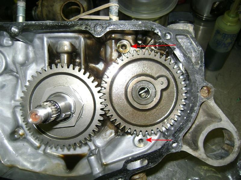

Took the right side Engine cover off then pulled the flywheel and discovered Honda never installed the retainers that hold the balancer shaft in place I have no idea how it stayed in place all them years I guess it was running real true so never moved .
The side cover has never been off you can see the dark oil stain on the upper bolt hole, their is no tell tale signs of loctite in the holes.

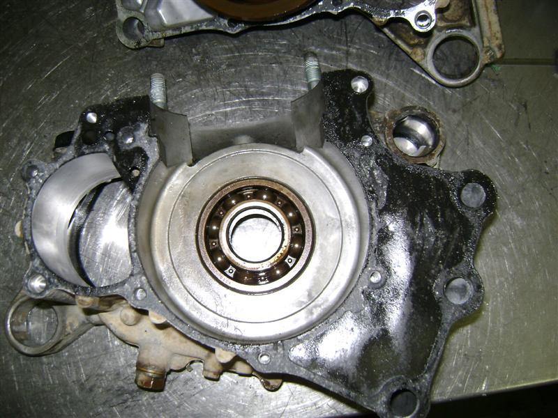

PostPosted: Sat Apr 10, 2010 8:21 am
Cases are split, I will work up a parts list later.
