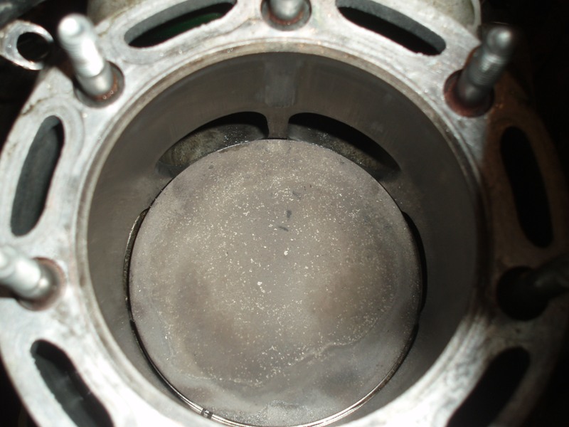

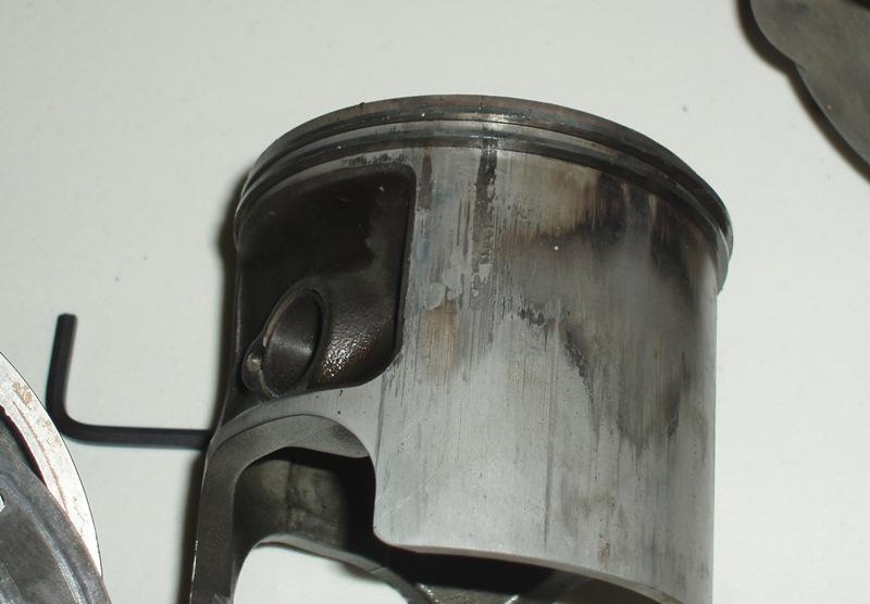

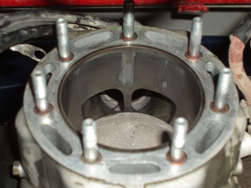

I raced last Saturday night at Milestone Ranch. It was the first time they put us on the Pro track. Like any MX Pro track it's full of huge doubles and triples... not really great for Pilot racing. I had to brake hard for the first jump then nail it for the second... all the way around the track... WOT (Wide Open Throttle), Brake, WOT (Wide Open Throttle), Brake. Anyway, the Pilot ran great during practice. It ran great again throughout the first moto. But then... as I was cruising my way back to the pits, something seemed odd. The thottle response was just a little off. 30 minutes later, time for the second moto, I went to start it up and... I knew immediately... it was done. It cranked a few times but it got slower and slower. After a few tries it wouldn't crank at all. You could just hear it tightening-up...
Here's a few pics I snapped. The cylinder is on its last bore so I'm considering taking it to LA Sleeve. the crank needs to be rebuilt. Any suggestions from the So Cal guys out there on where to take bottom end? Thanks, Darin
No cooling holes drilled in the piston hmmm
Sure it needs a bore or just honed and a new piston?
Measure the cylinder for out of round and taper if in spec chances are its not worn since the last rebuild.
Why would you need cooling holes drilled in the piston for a pilot? I thought pilot jugs don't have exhaust bridges, therefore; no need for holes in the piston...

You don't see the bridge in the pics above with the scuffing above the bridge?
Its a CR500 cylinder he is running.

This top end was done 2 1/2 years ago at a Honda dealership... I was naive back then. I had very little mechanical experience and thought that I should trust the "pros". Thanks to this site... I've learned a lot.
You're right Hoser... The cylinder may just need to be honed. The crank, however, was stuck even after I removed the jug. It's moving now but... not easily. I don't feel competent enough to tackle a bottom-end rebuild. So, I'll pull the motor (( Internal Combustion Engine ? )) and take it somewhere locally.
I've never come across any discussions about drilling cooling holes in CR500 pistons. It makes perfect sense... Is it common? Any CR500 owners out there have any comments?

No big deal it was a good question, your right the Pilot does not have a bridge and no holes need drilled.

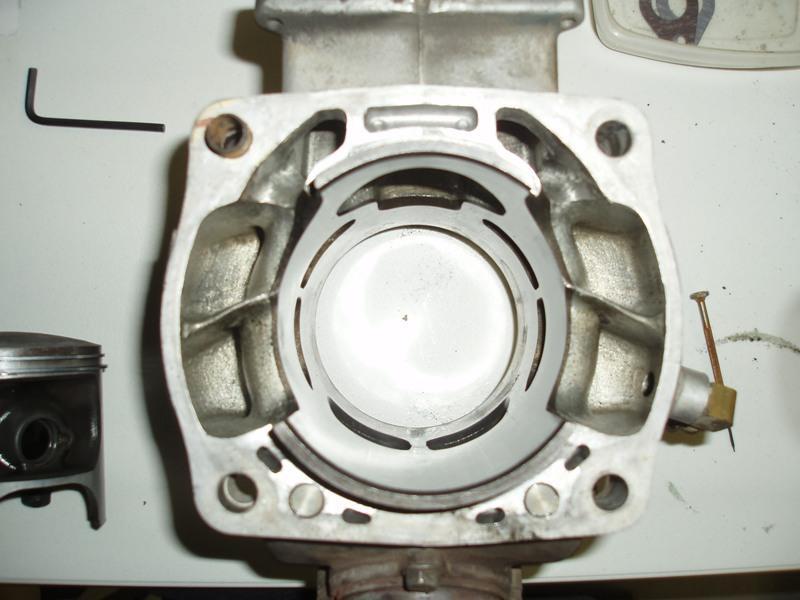

You're right Hoser... The cylinder may just need to be honed. The crank, however, was stuck even after I removed the jug. It's moving now but... not easily. I don't feel competent enought to tackle a bottom-end rebuild. So, I'll pull the motor (( Internal Combustion Engine ? )) and take it somewhere locally.
Measure the over all width of the exhaust port if you can like in this pic.
The current piston looks like a Honda or PRO-X piston in the pics?
If the cylinder is ported and the exhaust ports are cut too wide you have to use the wiseco pistons because the cutouts on the sides of the cast pistons will allow a passage between the exhaust and the transfers.
Can you slip the cylinder back down over the piston then through the exhaust port take a scribe and scribe the exhaust port opening all the way around on the piston then we can see exactly how close to the cut outs you are.
If the bottom end is hard to turn its done don't run it!
I have the tools to go through the bottom end if you cant find someone local that's reasonable to perform the work, factor in shipping x2 if sent my way.

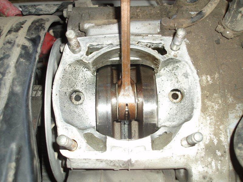

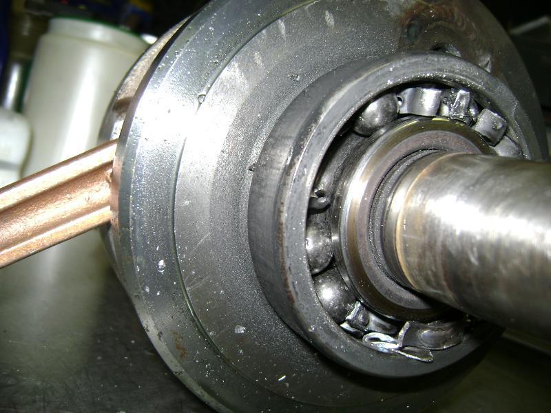

Pics of the crank...
PostPosted: Sat May 23, 2009 8:41 pm
Whats all the dark specs I see in the crank case?
What clutch you running?
Any pics of the bottom of the cylinder showing the transfer ports?
The dark specs appear to be flecks of aluminum. There's a decent gouge in one area of the piston. You can see it in the attached picture.
The clutch is Power Block.
Cylinder pic attached.

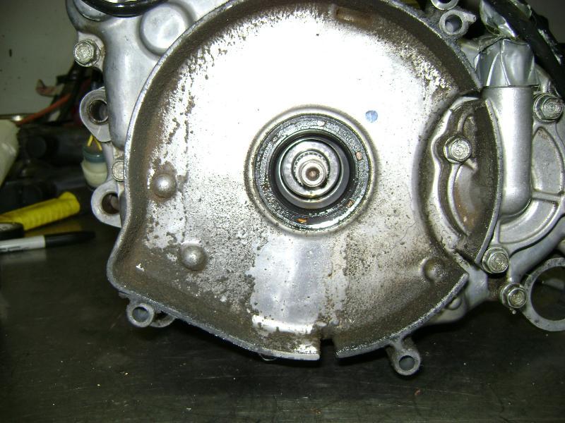

Engine is here and apart.
Seal behind recoil was leaking balancer oil.
File comment: Seal behind recoil was leaking balancer oil.

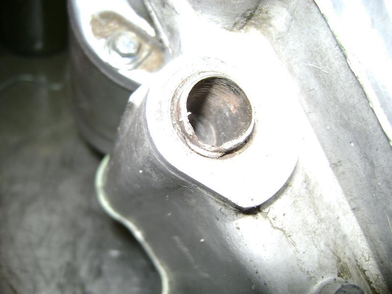

PostPosted: Sat Jun 06, 2009 4:34 pm
One of the dowel pins for Engine mount was crushed and will be replaced.

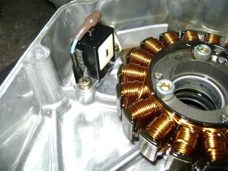

PostPosted: Sat Jun 06, 2009 4:35 pm
Not much metallic in the balancer case.

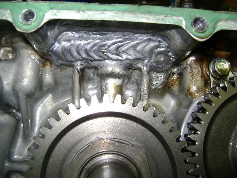

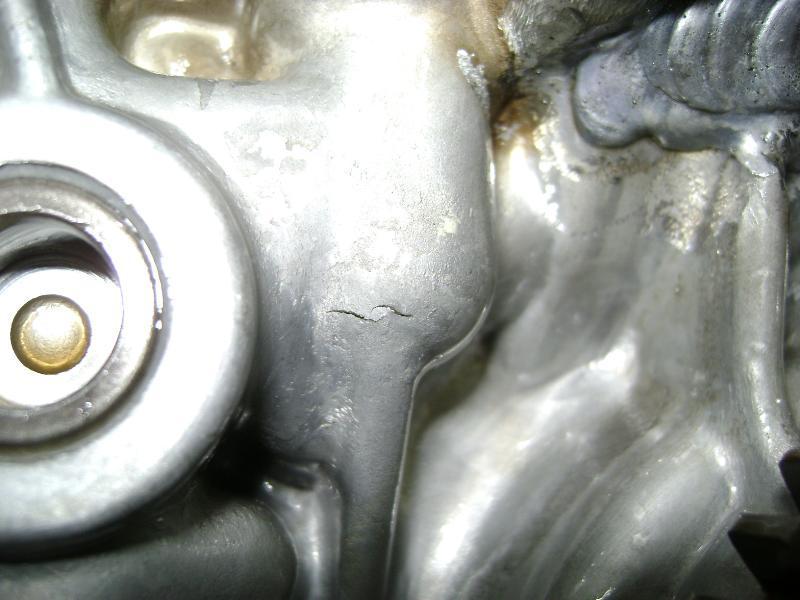

PostPosted: Sat Jun 06, 2009 4:37 pm

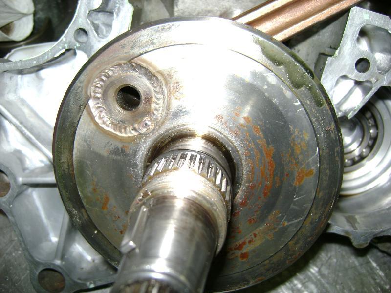

Welds part of CR500 mod
File comment: Looks like they cranked the cylinder stud in so tight it cracked the case
File comment: Closeup

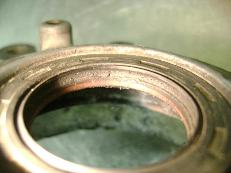

PostPosted: Sat Jun 06, 2009 4:38 pm

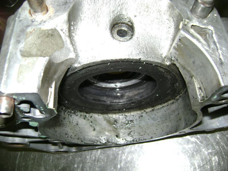

Crank seal on clutch side installed real deep

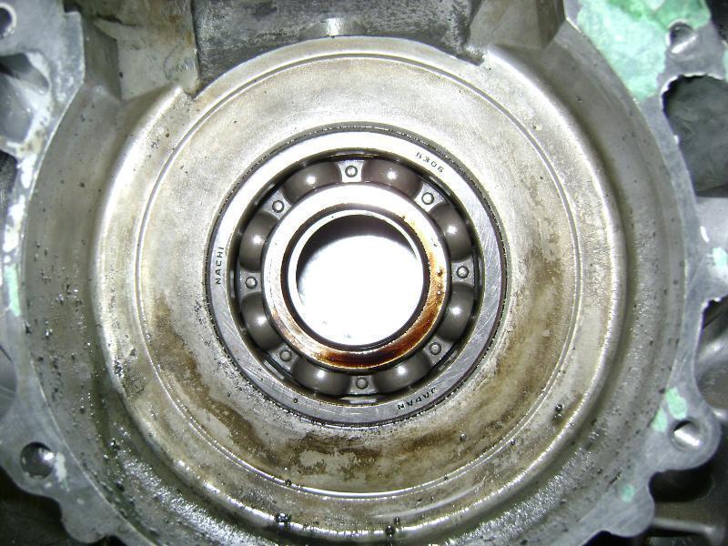

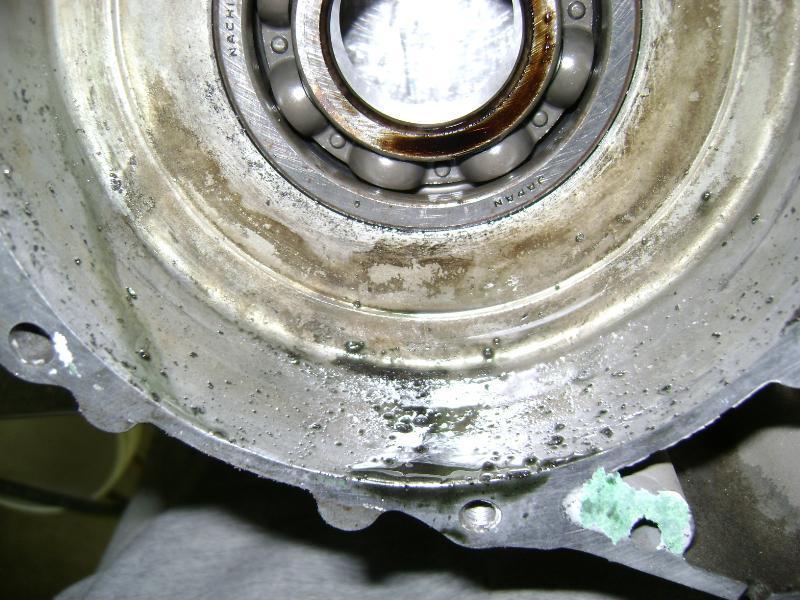

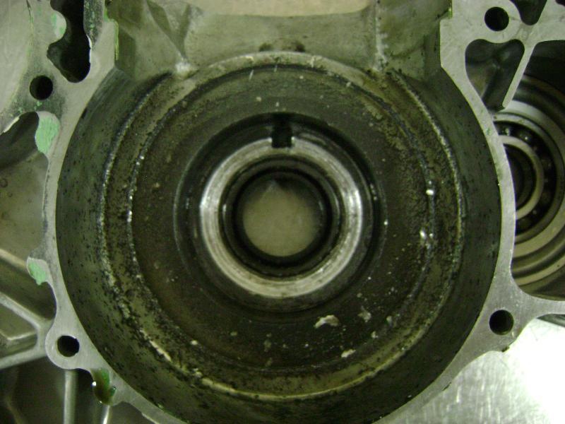

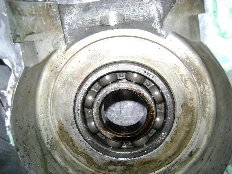

PostPosted: Sat Jun 06, 2009 4:39 pm
Cases split mad side bearing, see brown carbon trails on bearing race and bottom end

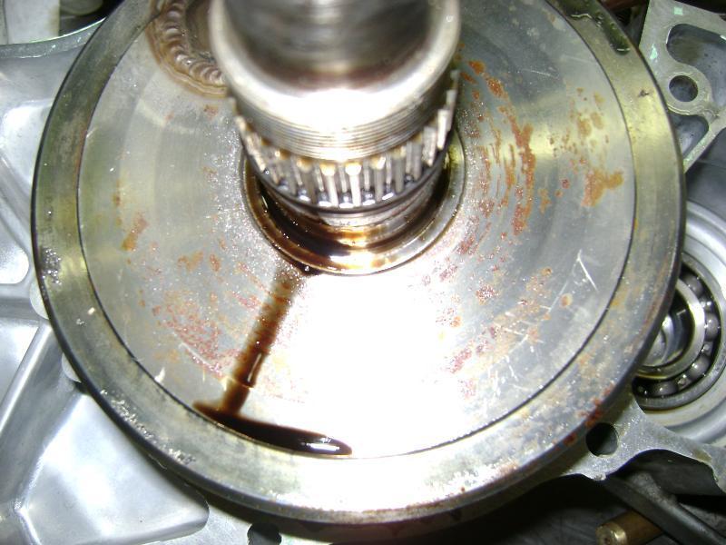

Rust on crank

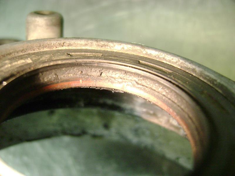

PostPosted: Sat Jun 06, 2009 4:43 pm

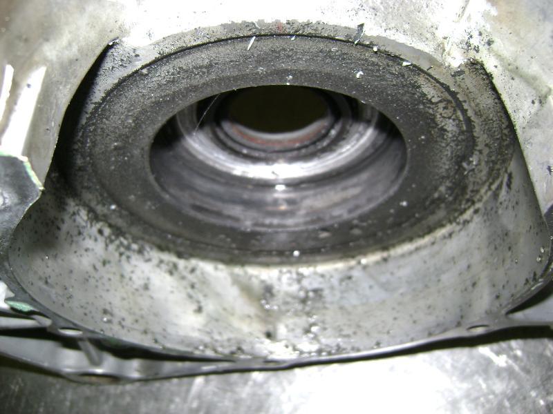

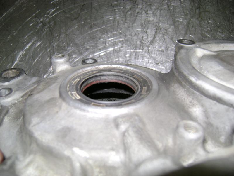

Better view on how deep the seal was set.

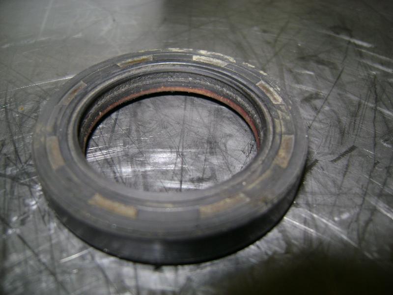

PostPosted: Sat Jun 06, 2009 4:45 pm

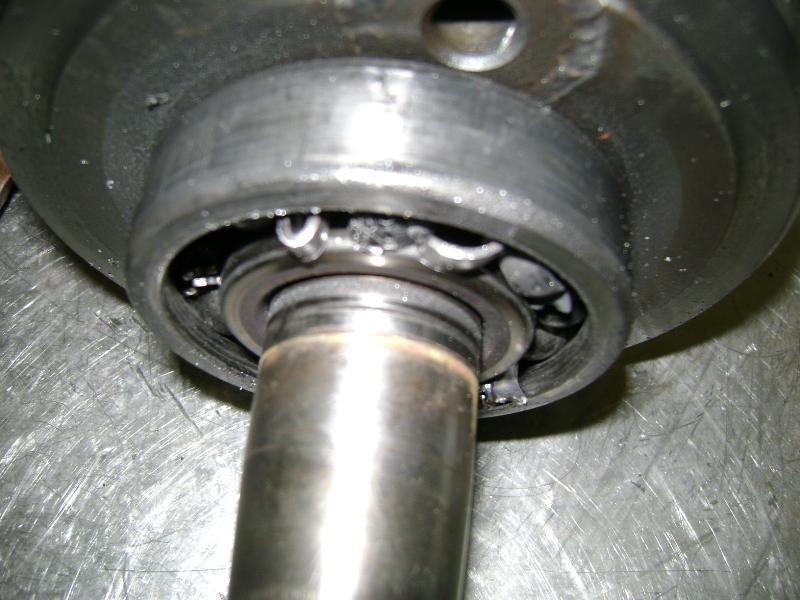

Seal full of dirt and crap, seal was bad letting in dirty and took out bearing or the bad bearing damaged seal and let dirt in, whats the history on this seal, looking at the seal leaking on the mag side I am under the impression these seals have not been changed in a long time???

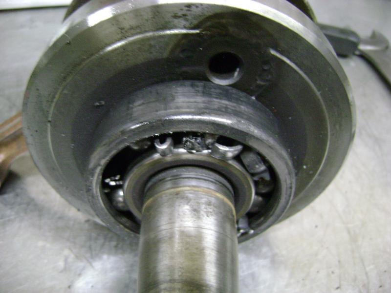

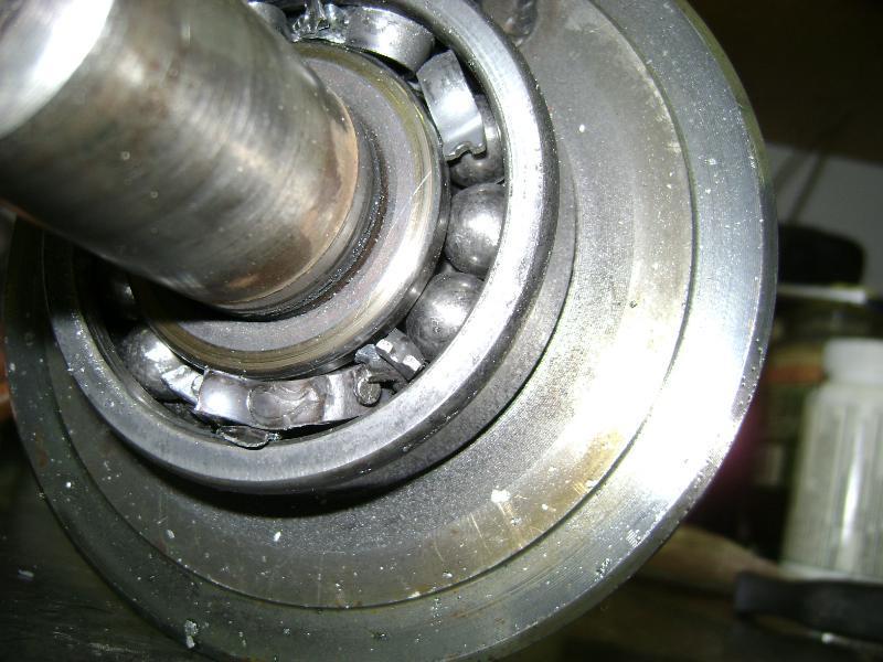

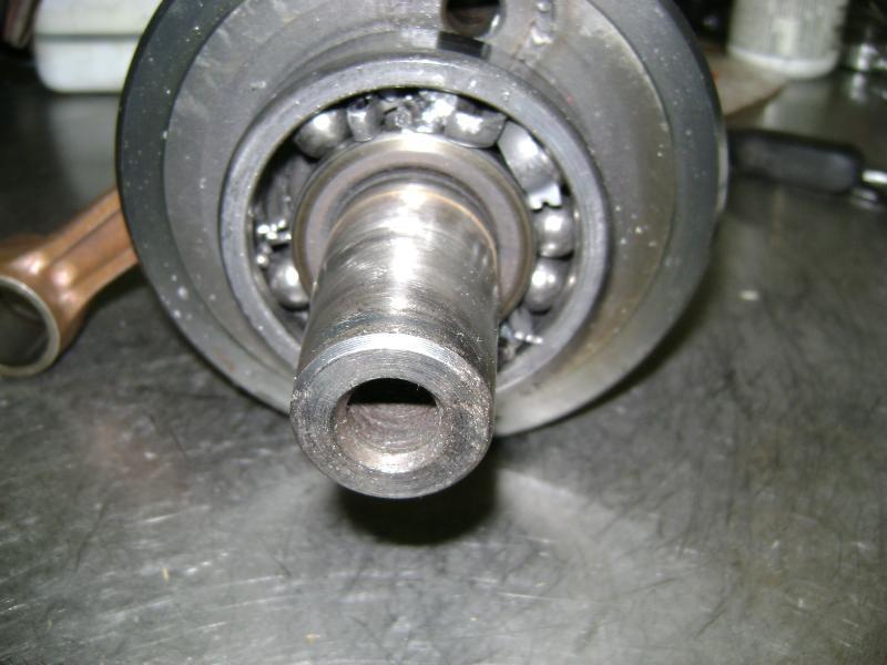

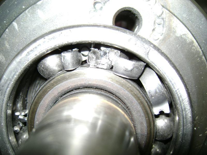

PostPosted: Sat Jun 06, 2009 4:48 pm
Bearing stuck on crank, I will have to grind it off, the metal ball seperator all bunched up and wrecked, the resistance felt when trying to turn the Engine over was all the metal rubbing on the cases, it cut a trench into the cases where it was rubbing.
 Post subject: bearing
PostPosted: Sat Jun 06, 2009 5:40 pm
Joined: Wed Feb 11, 2009 12:25 pm
Posts: 70
Instead of grinding the bearing completely off, we used to take a grinder and just cut 2 places in the outer race across from each other so that we could take a 2 jaw puller and grab the bearing in the notches with the puller and pull it off the crank...It's much faster and easier than cutting the bearing completely off with the grinder, and you don't risk damaging the crank surface....
