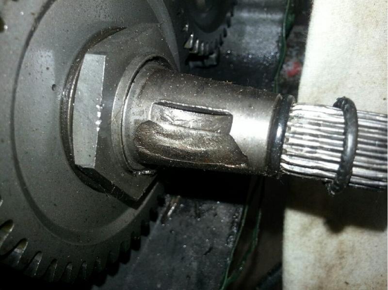

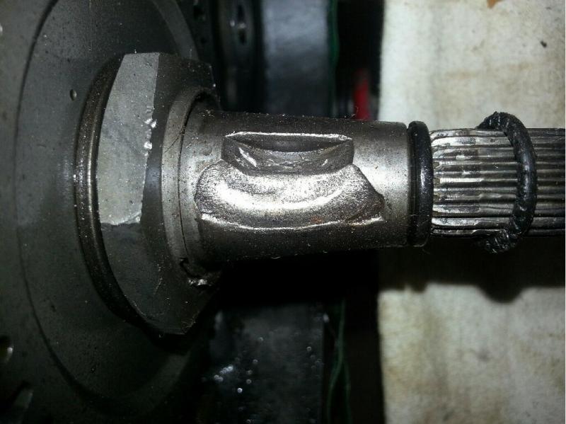

thanks for your quick reply. they sent me pics and it looks like the slot for the flywheel key is shelled out. How much would it be for everything parts-wise that I need to fix that? crank, bearings, seals, gasket?

 Post subject: Re: Pilot crankshaft
PostPosted: Mon Sep 17, 2012 8:30 pm
You should have it welded up and a new key groove cut in the other side
PostPosted: Mon Sep 17, 2012 8:39 pm
Joined: Thu Sep 13, 2012 10:55 am
Posts: 15
who can do that? Should i just have them remove it and send it off or could it be done local here in tulsa?

Is there something wrong with the splines also? Where the oring is at.
PostPosted: Tue Sep 18, 2012 4:12 pm
Yes the splines look damaged but as long as the recoil thingie will slide on and off and fully seat I would not worry about it.

All I can say is wow make sure that is not bent also first
can be welded but it going to make a weak spot in that area so keep that in mind it will never be as good as it was when new.
and yes what dose the fly wheel look like ? it's got to be trashed
a weld turn and recut key job like that will run you $60 to $80 plus shipping both ways
But make sue it not bent first

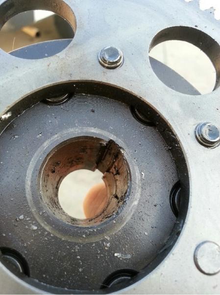

this is the pic they sent of the flywheel. fixable?

could a new key slot be cut 180 deg off on both the crank and the flywheel for a repair, keeping it in timing?
PostPosted: Thu Sep 27, 2012 11:04 am
The best way I can answer your questions is anything is possible given enough time and money. Did you read my last post? Did any of it make sense to you? Seems like it did not sink in and you just want to know if it can be fixed based on a picture a repair shop sent you. So here ya go - hell ya it can be fixed! I am only offering you advise in my last post based on my personal experiance with my 2 fl400 pilots.

Your going to have to pull the entire Engine apart to fix this or replace it. So your cost on the lowerend is going to be a couple hundred bucks just from having to replace all the bearings and seals and a new gasket set. Plus the cost of the repair/ new crank. Not including your pullstart parts. I have a friend with a complete lower end I can see how much he wants for it.

Your pilot has been in the shop since April?!?!? First thing you need to do is go get your pilot! Like yesterday. Should have done that months ago. These sound like some real morons. Why did you have to ask to know the flywheel was bad? Why didn't they communicate that YOU needed to find a crank?(they're unavailable new but they should have communicated this in case you didn't know.) I'd be asking the manager all of this. That's absolutely unacceptable. From the sounds of these chumps I wouldn't let them air up my bicycle tire. Let alone rebuild my Engine! Go get it back and ship it to someone who knows their shit. It won't be your local guy. Will cost to ship but if you had done this in the first place you could have been riding months ago. If they're quality of work matches their customer service you don't want them to lay a finger on your pilot.
