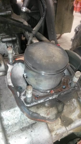

First few pictures:
I have not got the Engine out of the buggy yet, I have removed the seat and the pipe.
It looks like the piston is still one piece but with some serious scaring.
The cylinder wall shows some scaring and you can see the hatch pattern from the honing.
It’s only a guess but I would estimate the Engine only has 10 to 15 hours on it.
In the future I think I will try to keep better records.

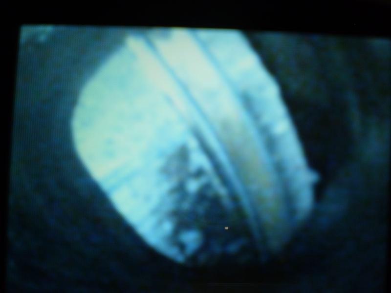

I dropped the bore scope in there to have a look around.
The bore scope doesn’t talk to my digital camera so I don’t have good pictures.
I tried taking pictures of the screen on the bore scope – the quality was not good.
After I get a pressure test I will pull it apart and take pictures.
First picture shows the piston looking up the exhaust.
This gives some idea of the damage to the piston.
I think the con rod big end bearing is what died, as the parts passed through the Engine they did quite a bit of damage.
Second picture shows the material lodged in the spark plug.
I thought it might be aluminum based on the rounded shape.
I have not pried it out to find out.
Third picture shows the crumbs that came out of the expansion pipe.
These particles are magnetic, so I assume I have a bad bearing.
More info when I have more time.

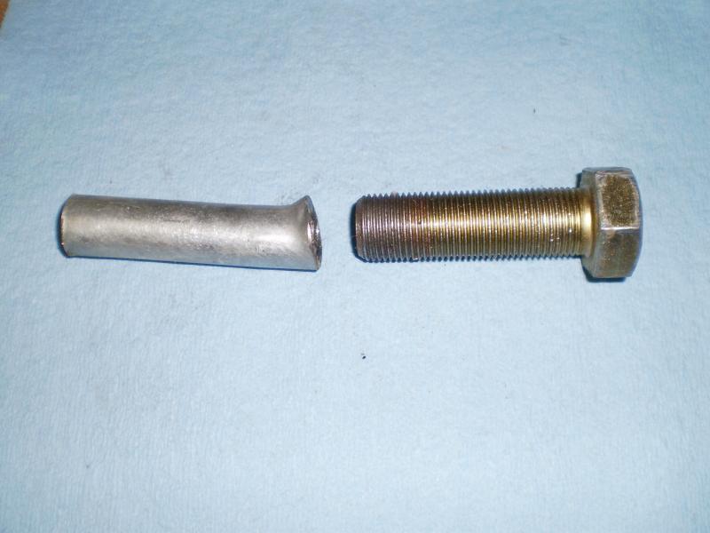

The driven clutch gave me fits.
My crank has some damage inside the nose, there last few threads have been buggerd up and reworked.
So I thought I would use a pipe to push on the crank (insert pipe, push with big ass bolt).
It’s not what is recommended on this web site but what could go wrong?
Hey I’m a big boy, I work in the R&D lab for the largest motorcycle manufacture in the world.
I used the impact to thread in the bolt, when it hit the pipe the rotation slowed down.
But the clutch didn’t pop off and the bolt kept turning ever so slowly.
I have enough mechanics skills (6 years as a body mechanic before I went back to school) to know this was an issue and stopped.
But it was too late, the end of the pipe mushroomed over and it was not coming back out.
So, back to the web site to see exactly what Hoser said to do.
I went and got a Craftsman punch as large as would fit in the nose of the crank.
Cut it off so the end of the punch was shorter than the threads in the driven (to keep the end of the punch from messing up the threads).
I would have preferred to make the skinny end as short as possible but I needed to snake the punch threw the pipe lodged in the clutch.
With this arrangement the driven popped off with no drama.

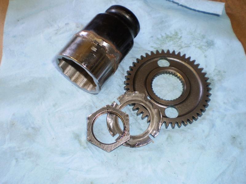

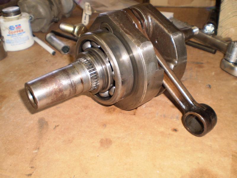

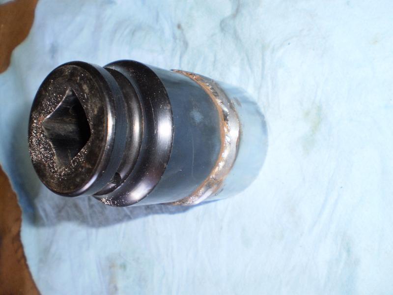

So I have the Engine stripped almost ready to split the case.
I don’t have a 41mm deep socket so the crank drive gear for the balancer is not off yet.
Of course I have a regular 41 that doesn’t help any.

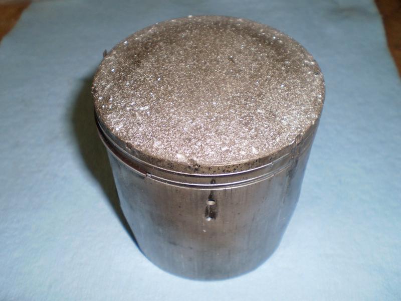

The big end rod bearing is the primary failure for the Engine (this is why it stopped).

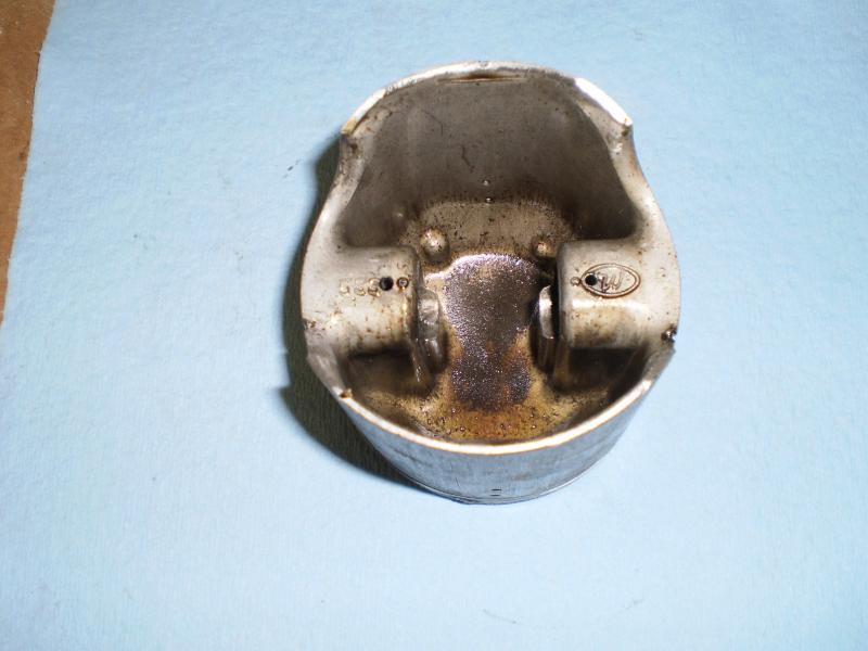

As a secondary issue, the cylinder base gasket is blown out and the Engine was running lean.
The piston has ‘death ash’ across the top and the underside has a huge black smudge from the oil burning under the crown.
Both are indicative of immanent failure (piston melt down).
I don’t like saying there are 2 causes of a failure.
If one of the punk kids that workes for me told be there where 2 problems in a failed test I would tell them to go back to the desk and figure out what really happened.
Apart from that the piston is scored pretty bad and the cylinder has a few gouges from bearing parts in the wrong place.
I assume I will need to bore to the next size up but I have not measured to make that determination yet.
Looking at the wrist pin bearing it looks like some of the rollers have cracks in them.
I assume this is from the forming process.
I need to look in to this some more.

Also, as a side note, the piston has oil holes for the exhaust bridge and the intake bridge.
I think the PO forgot to install the intake bridge!
See the photo above.
 Post subject: Re: Lee's LS Carnage
PostPosted: Mon Jun 09, 2014 11:19 am
As they say seeing is believing I am seeing and still having a hard time believing, DID I DO THAT? seeing this has renewed my interest in finding the rest of this engines build pictures I have searched again and cant find any more than whats on this page viewtopic.php?f=5&t=8672&p=76617 I downloaded the piston pics on that page and brighten them up and zoomed in tight I cant see the locator pins in any of them, I don't see any locater pins in the last pic where the piston has been cleaned up I would expect to see the pins in the clean piston pic if that is the case then the PO before bubba66 drilled the holes? I assume I reused the supplied piston that came with that Engine since it was discussed and was low hr, but what is important (important to me) is how did I miss the holes being drilled on the wrong side of the piston in the first place? Then usually the keen eyes we have on this site catch a missed detail like this the piston pics had 193 views, this really concern's me I already second guess myself on everything and triple check everything during my builds yet I missed something so simple and stupid, I have often said nobody is 100% this is common knowledge and most everybody realizes that nobody is 100% so action is taken or procedures has been created to minimize the chanced of something like this happening, you should see all the steps taken at a nuke power plant to ensure something like this is not over looked.
I can see now I need to make changes in my shop to ensure this or similar things cant happen I already have procedures in place to combat most problems created by distractions, no music, no TV, NO PHONE, anybody comes in to the shop ALL works stops and does not resume without reviewing about the last 10 steps I had performed before someone came into my shop or a distraction happen, (knock on the door, thunder etc.), I NEVER work on anything unless I am in the mood, if I am not 'feeling it' I simply don't work on engines that day, its been too long since I done this Engine I cant imagine what the distraction might have been for sure so I can take corrective action to ensure it does not happen again, right now I can only assume it was complacency, meaning the piston was already drilled when I received it then I didnt make the the double checks I usually make when installing the piston in the cylinder to be marked for drilling.
Before I drill these holes I install the piston on the rod with the bearing and wrist pin (no cir clips) when I pick up the piston to install it on the rod I put one finger on each of the locator pins (touch is one of the things they taught us at the nuke plant to self check) to ensure the intake side is facing the right way, then the cylinder is installed and the marks made on the piston with a pencil, the cylinder is removed marks are made on the piston where the holes go before the marks are center punched and before drilling the locator pins are verified again by touch then the piston is drilled.
I think its time for me to switch to written procedures to follow on my Engine builds so I cant be distracted again in the future and to combat things like the complacency trap that seems to have happen in this case, I also need to figure a way to sharpen and hone the skills of this sites users to spot little details like this, one thing I feel has helped to contribute to this failure was the SHITTY pictures I presented to this site and its users MORE pictures should have been taken until details like the locator pins were clearly visible in the pictures I gotta find a professional grade camera to take detailed pictures in my shop.

First, when I pulled the cases apart one of the main crank bearings stayed with the crank.
The case looked like the bearing had spun in the case but not too bad.
I need to measure the case to make sure the hole is still round and in spec.
I went all out and ordered a bearing puller from Tusk.
I have been wanting one for a while so this was my chance.
While I was looking for information on what to do I did find some information on the Harbor Freight variation:
viewtopic.php?f=26&t=13605
Look about ¾ the way down, date Friday Mar 7, 2014.
The Tusk bearing puller made short work of removing the offending bearing.
It looked like there was just a little lock tite on the shaft, kind of a flaky skin that I could scrape off with my finger nail.
It could have got there accidentally but I will check the shaft size carefully when I check the run out.

I also needed a work around to get the balancer drive gear off.
I didn’t want to chisel it off, besides I’ll need to torque it back on later.
Found a few references for making a 41mm deep socket – they are not available at Lowes.
viewtopic.php?t=10357
And here:
viewtopic.php?f=1&t=10362
I found a 1 5/8 socket at Tractor Supply for less than $8.
Some made in China forged chrome vanadium steel.
Apparently Chinese chrome vanadium is easily cut with a metal band saw.
I welded the stub on to a random socket from Harbor Freight.
It’s not perfectly aligned but it works.
File comment: A little impact gun action and the gear is off

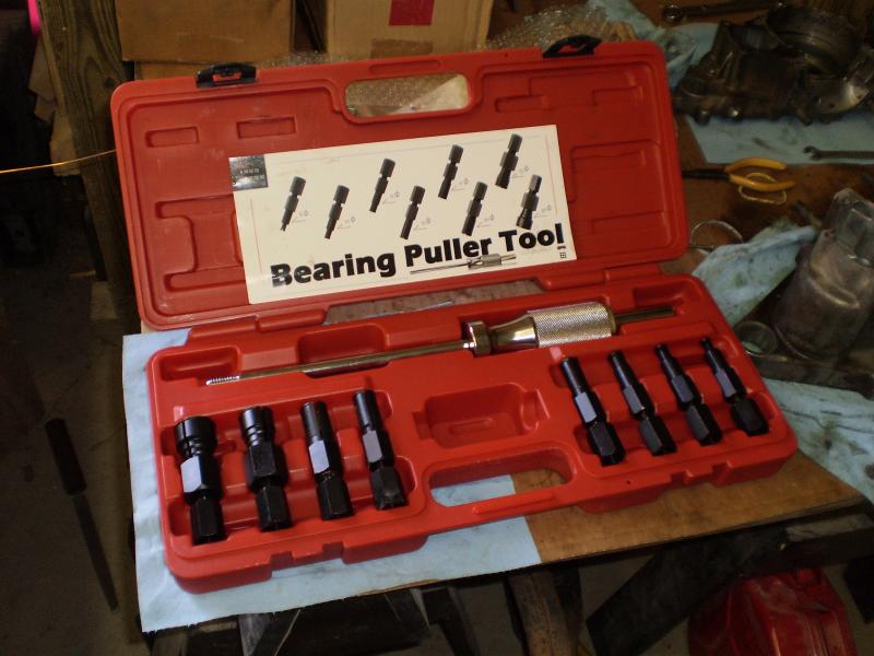

Long story short, I was authorized to purchase a blind bearing puller.
I went with the one from Tusk, I have been having good luck with there stuff.
Bearing came out without a fuss.
File comment: Balancer bearring deep in a blind pocket
File comment: Bearing poped right out with the propper tool, note grease packed in there from my failed attempt to extracate the bearing.
File comment: Another pretty box with tools in it. I seam to have spent quite a bit and I havent bought any parts yet. Puller set covers 8 to 30mm internal shaft sizes.

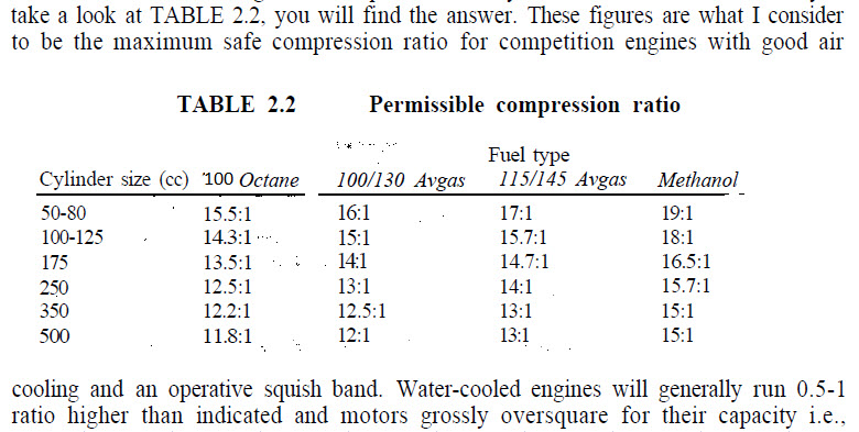

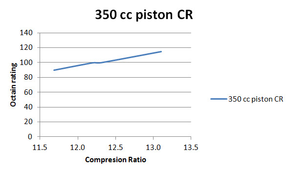

Below I have a graph made from Bells information that predicts the limits of compression ratio vs fuel octane.

File comment: So with 91 octain I should be OK at 11.7:1 but stock is 6.5:1. This seams like a huge jump - not sure I belive it yet

My brother and I just run avgas now. I feel it has saved us a lot of grief. My brothers machine has 170psi compression and mine is at 125psi. We have had no issues since we have switched to avgas. I blew up my brothers machine 9 times before I finally got it all right. On a side note because I am a cheap bastard I was making my own base gaskets. Bad idea. You MUST run a metal base gasket.
The first two are my machine and the next two are my brothers. Both happened the same day.
Blown cylinder gasket
