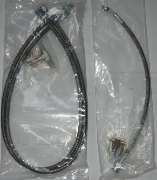

Pic of parts, ?
PostPosted: Fri May 12, 2017 12:23 pm
TexasDirt wrote:
I'm in northern Cal for now but my home is in Wood County about 20 miles north of Tyler. The buggy is with me. I don't have anything put on the car. The brake lines are too long to run per the stock routing and the supplied T fitting, while screwing into the provided lines, does not thread onto the stock hard line. The lines themself are long enough to run to master cylinder but the T has different theads than the master cylinder. Looks like tight quarters to run lines to T at mstrcylnder. I can post pix of the components if you think it would help. I did call and email chucklenuts at aftershot motorspurts to try and get instructions or help with the process...no return call and haven'/t seen an email response.
I put this kit on mine and I remember being confused also but unfortunately I cant remember exactly what the problem was.I think that "T" that comes with it replaces some part on the pilot,I thought mine came with instructions but it was very confusing.I did get ahold of him on the phone but it wasn't easy,he did help explain it to me.I don't have easy access to mine to look at it,i'm going to try and pull it out this weekend if I'm feeling up to it{been sick}and I'll see if I can remember what I did and snap some pics

adnoh,
Thanks that is the complete kit (fronts on the left and rear well....on the right), except that the fronts pictured do not include the adapters to replace oem banjo fittings at the backing plate. That T fitting in my pkg does not screw into the master cylinder (incompatable threads/fitting end). Re your pic of the rear...I see a brass fitting (adapter?) that was not in my kit. Mine contained just the new line, a banjo bolt and retainer clip.
T.D.
PostPosted: Fri May 12, 2017 2:04 pm
Joined: Mon Oct 10, 2016 2:11 pm
Posts: 4
I stand corrected re pictures of the fronts. I see the adapters for the fronts are on the ends of the lines.

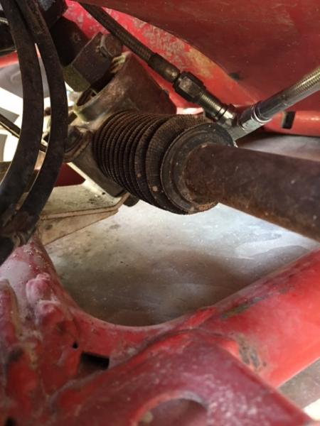

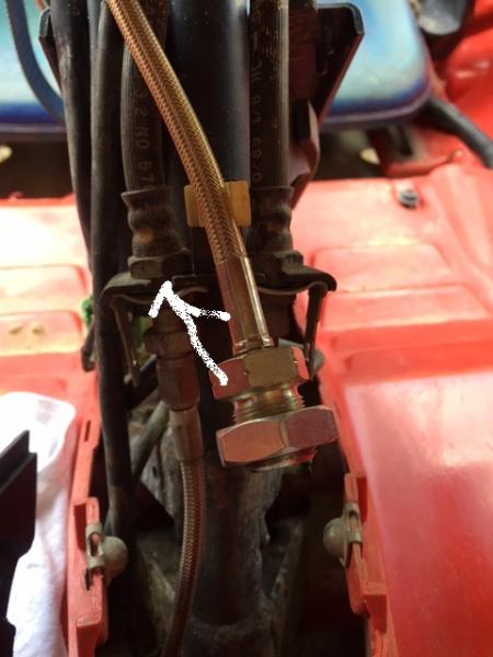

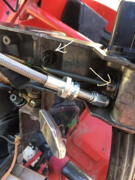

Looked at my setup today,apparently I only used part of his kit because I couldnt get it installed correctly either.
File comment: This cable is supposed to replace stock rubber cable and screw into master cylinder,but I could not get old cable out of master cylinder so I didnt use it

PostPosted: Sun May 14, 2017 4:57 pm
I only used his cable that went to the wheels,cant remember if that "T" came with it but I was able just to screw mine into existing cable,but like I said that one cable is meant to replace stock rubber cable and I think that "L" bracket is to hold the new cable on the steering column.
