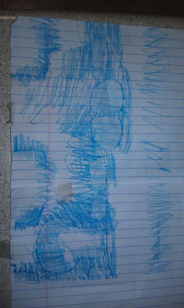

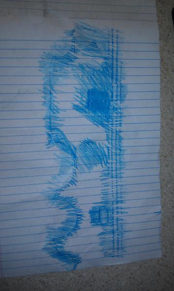

Woohoo...I switched to Firefox for Android and can upload pics from my phone now.
The port transfers...no dimensions yet.

Notebook paper port maps were so-so, but I was able to get some numbers off of it. Some inconsistency since the the paper moved a tad on me...and...I used effing crayon. LOL!
Planning a second go using some fine graph paper and masking tape AND not sitting on my basement floor at 11pm. :shock:

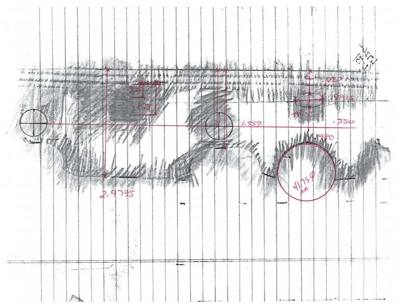

But here's a rough look at the Pete Garrison cylinder...

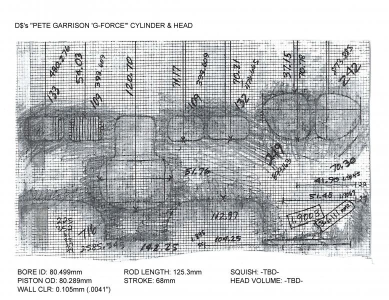

Second go at the port mapping...

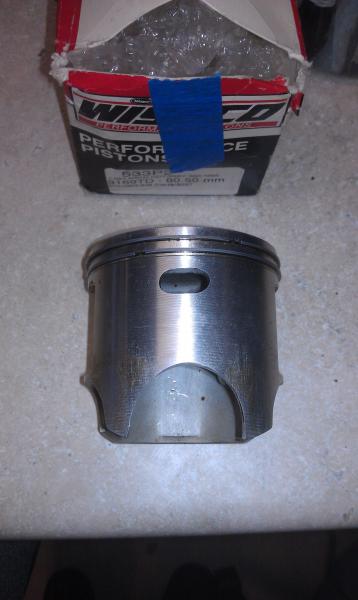

Here are some pics of the piston per the request of a fellow member. The piston has the intake oval hole plus the 2 exhaust bridge lube holes. The map dimensions of the piston oval hole are on the 2nd sheet on my Apr 1 2013 post.
-Dan A.
