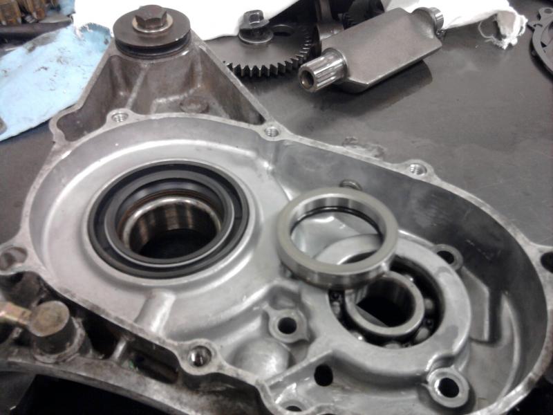

When ever you put seals in something, you usually make the face of the seal flush on the side you are putting it in. Hope this helps.
Many times there is no back stop for the seal to bump up against, so you just make it flush.

No your good to go.
If there is a lip for a seal to butt up against then it was designed that way. Sometimes there is no back stop.

A good example of what I was talking about is if you replace the double lip crank seal in the counter balancer area. This seal has no back stop and you can drive it right into the crank bearing. You install this one flush. Pics below.
