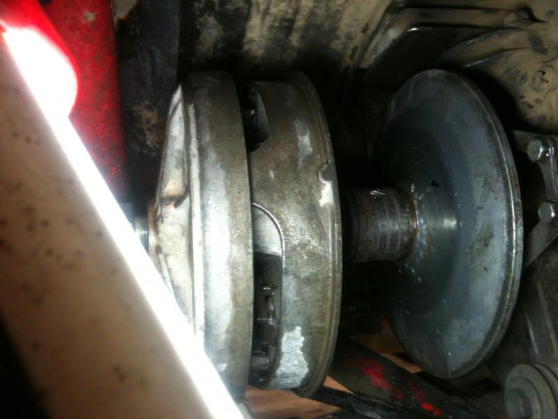

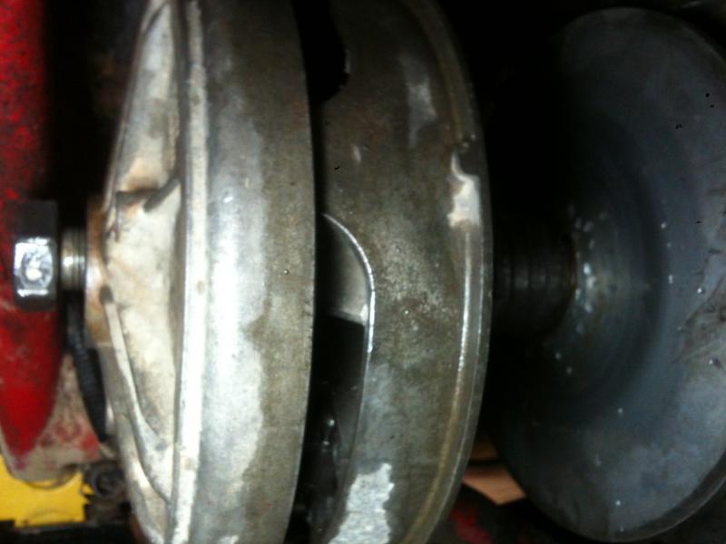

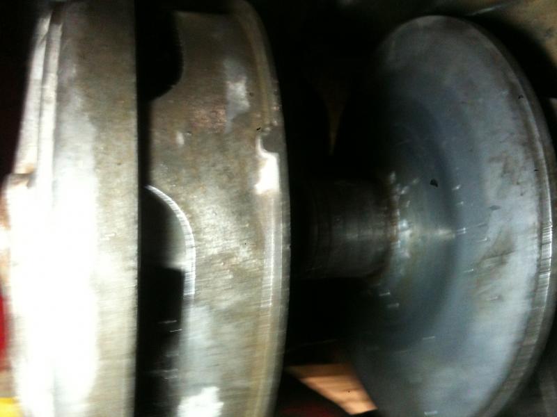

Ok i need your help with this f***** clutch. We(denuch and i ) are trying to remove his oem salsbury clutch from his 350 and it wont come off. I have removed the mounting bolt and the large nut under neath it. Next tried to place the remover in the hole and drive it in with a 1/2" impact gun and nothing... We have hit it with big hammer, bigger hammer, kitchen sink. We have tried heat at the Engine shaft contact point and nothing.... Pb blaster behind the pulley in the pulley and everwhere else too. The clutch outer cover is loose as is the outer clutch face but they wont come off because its hitting the frame. HELP.... please advise how to get the inner cluch face off the motor (( Internal Combustion Engine ? ))??????? We literally have spent 4 hours on this POS trying everthing under my roof with exception to the 9mm! I took some pics but its hard to tell really whats going on....
I pulled my oem clutch on my 350 2 mo ago and it was nothing like this, 3 hits with the 5# hammer and some impact and she was off!!!
PostPosted: Thu Jun 14, 2012 1:51 am
Please show pictures of the removal tools.
Another method is to pack the threaded area of the clutch with grease. Put as much grease in there until you can't get any more in there. Wrap the end of the bolt you are using to pull the clutch of with teflon (plumbers) tape. Thread the bolt back in and hit it with an impact gun. The bolt and the grease act as a hydraulic press will hydraulic force the clutch off.
It's messy but it works.
Caution: When it lets go, it does so suddenly and usually with a loud pop!
Good luck

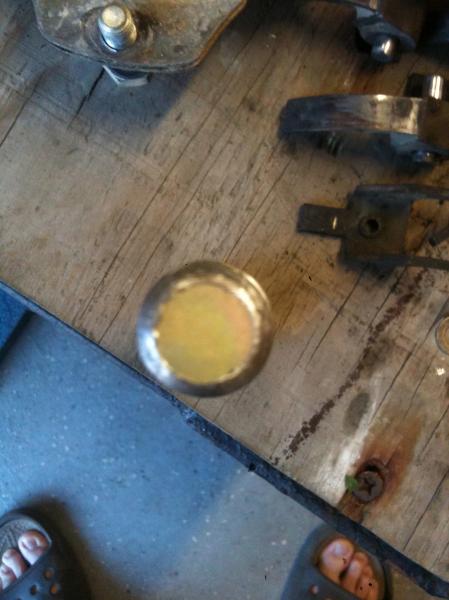

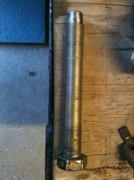

heres the pics of the puller.... Put grease in 2x now and still nothing....
whats next???
Randy

PostPosted: Thu Jun 14, 2012 9:25 pm
I think your missing part of the puller
Where did you get that puller?
I hope your not messing up the threads that go into the crankshaft.
Usually their is a pin that goes into the hole in the end of the crankshaft and bottoms out against the end of the crankshaft then the bolt in your pictures screws in and PUSHES up against the pin and forces the clutch off the crank.

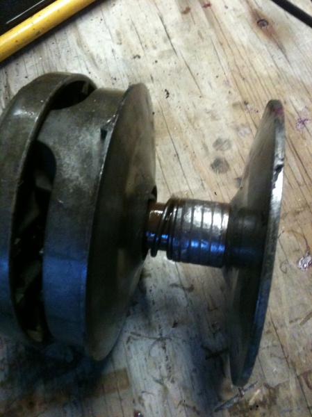

BOOYA....POOOF KABOOMM
ITS DONE!!
DENNIS TOOK THE POP AND ALMOST POOPED HIMSELF...LOL
HES SOME PICS
WE HAD THE TEFLON TO CLOSE TO THE BOLT HEAD
WHEN WE CHANGED IT TO FARTHER DOWN IT POPPED RIGHT OFF!!!!
That is the puller i used on my sals clutch too and it popped right off!
THANKS TO ALL WHO HELPED.
HOSER, We plugged the vac lin port behind the clutch and started it up and it runs alot better.... Now to hunt for a duster clutch!!

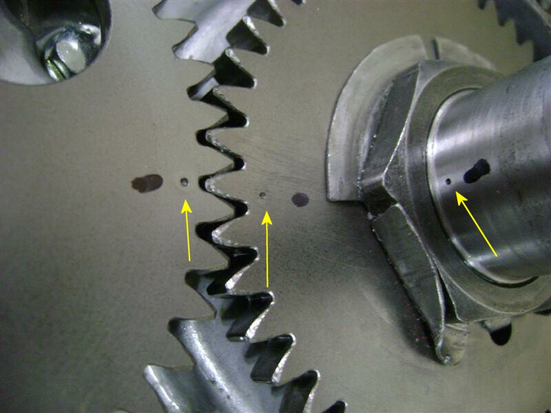

Here is the pic of the balancer timing marks.

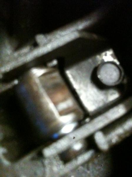

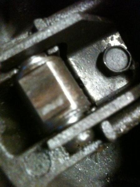

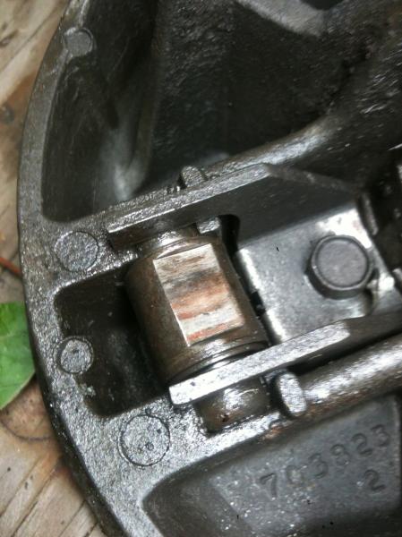

Pics of the clutch which has a flat roller.....Could be the source of vibration???
It runs much better now.
Anyone selling a 94c clutch for a 350???

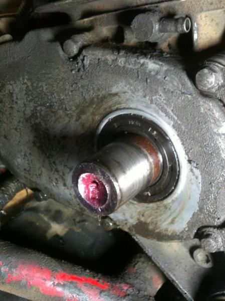

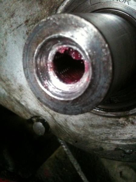

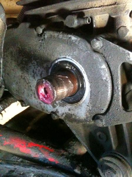

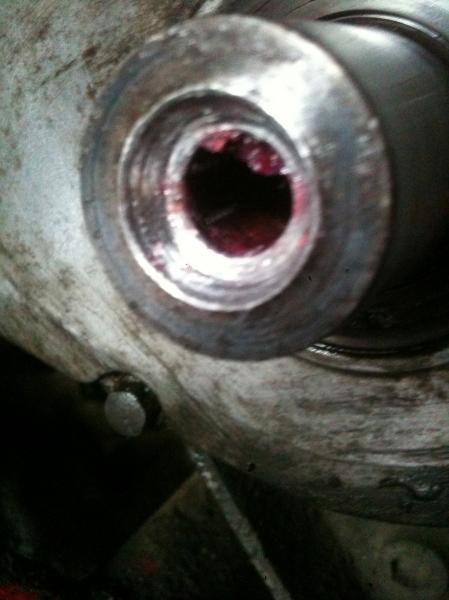

Here are some pics of the crank after the pull...
how would i correct this? A file and tap? File down the high ridge and clean the threads with a tap?
The bolt wont go in....
Thanks, Randy

PostPosted: Fri Jun 15, 2012 7:53 am
Thanks, Randy
Wow that's what I was afraid of yeah your going to have to see if you can chase the threads with a file and a tap.
You check the run out of the crank?

Guys, we checked the runout and it was borderline. Denuch is gonna run the season with it and then do a teardown and rebuild this winter. We took a reamer and cleaned out the extra material that got pushed in by the puller and ran a tap into it and just cleaned up the threads etc. Attached is a video of the Engine running with then new 94c duster installed and the vac hole behind the clutch plugged and its runnin fat but alot smoother than it was. So we have to lean it out a little bit and dial her in.
