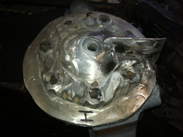

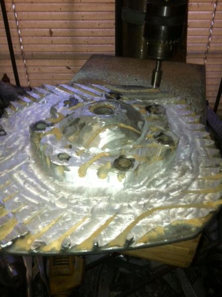

Today I am starting on the head, cutting the fins off and prepping for clean up. In the past how has it been done to route the water through the head and the cylinder? I am sure there has been some better than others, If you have done this or even seen it on one let me know how it was done. I have came up with a couple of ideas but not set on just one yet. Thanks Billy

Member "Canadian Oddy" converted a stock head recently on here, and they welded in a wall so that the coolant was forced to go all he way around the head chamber from inlet to outlet.
Here it is...http://www.pilotodyssey.com/PO/viewtopic.php?f=5&t=13009
The pic is attached, too.

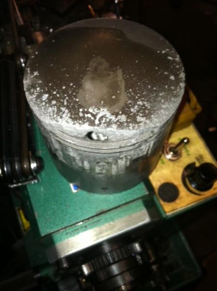

File comment: this is looking at the exhaust ports, all of the piston debris flaked off of the walls.

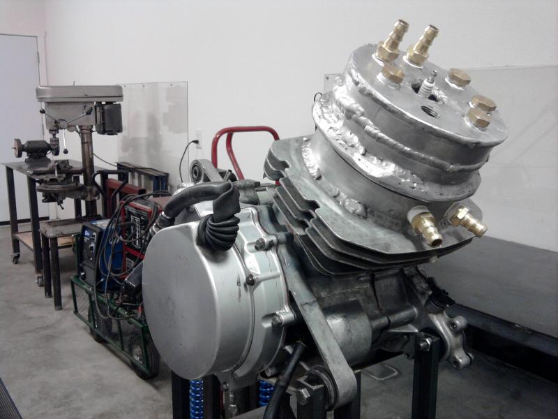

The project is not complete yet. I am still waiting for the water pumps.
The "plate" is so that the water flows around the head. If you don't put a divider in then the water will just go the easiest route and go in and straight out.
The cylinder is also water cooled.
I have two threads here - one is called making a fl350 water cooled head and the other is called making a fl350 water cooled cylinder. Check them out. Use the search box to find them.
That piston looks like two I replaced on my brothers machine. These machines just get to hot for various reasons everyone knows about already. I like tinkering with engines so I don't mind playing around and I have a nice heated shop attached to my house. Don't even go outside in the cold.

Will try to answer each question one at a time:
1) Water route: I have hose nipples screwed into the head and cylinder. I will go from rad to pump to cyl on one side then out cyl on other side to head on one side out of head other side to rad. You will need to look at the pictures in the other threads and I think you will figure it out.
2)What pumps will you be using: I will be running the Bosch pump. I am getting mine out of the states (Florida) from Auto Tech USA 1-866-841-7776. All the other pumps you are probably looking at draw to high of current. Oddy charging system is weak n not designed for a lot of draw. Everyone here seem to be running that pump.
3) Radiator: I am running a rad from a Honda civic I believe it is from. It's all aluminum, fits behind your head in the frame perfectly and only $90 Canadian, new. I am not running a fan cause more draw on electrical system.

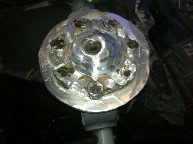

I got all parts ordered, cut the fins off of the head. I'm not sure how everyone else removed the fins but I tried a saw, grinder. band saw and found that the grinder with a cut off wheel works best and faster than any of the other ways. I hope to start removing the Engine tomorrow.

Since the snow/ice storm is over I got out to my garage today and finished getting my head ready to start the water cooling mod. Here are a few pics. Maybe my parts for the Engine rebuild will be in when I get to work in the morning.
File comment: I still have a little more cleanup before it is ready to start with the welding.

I got my divider welded on today, and the tubing for the head bolts and spark plug picked up. I welded it on with a stick welder using aluminum rods. Worked good, I tried to weld the divider on Friday with a square wave tig and couldn't get it to stick to the head beside of the plug hole. Here are a couple pics of it. It ain't pretty but it is on good.
