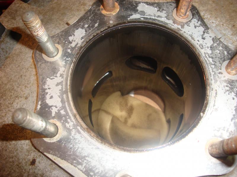

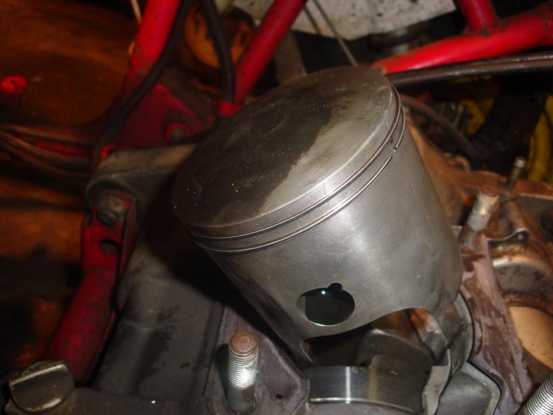

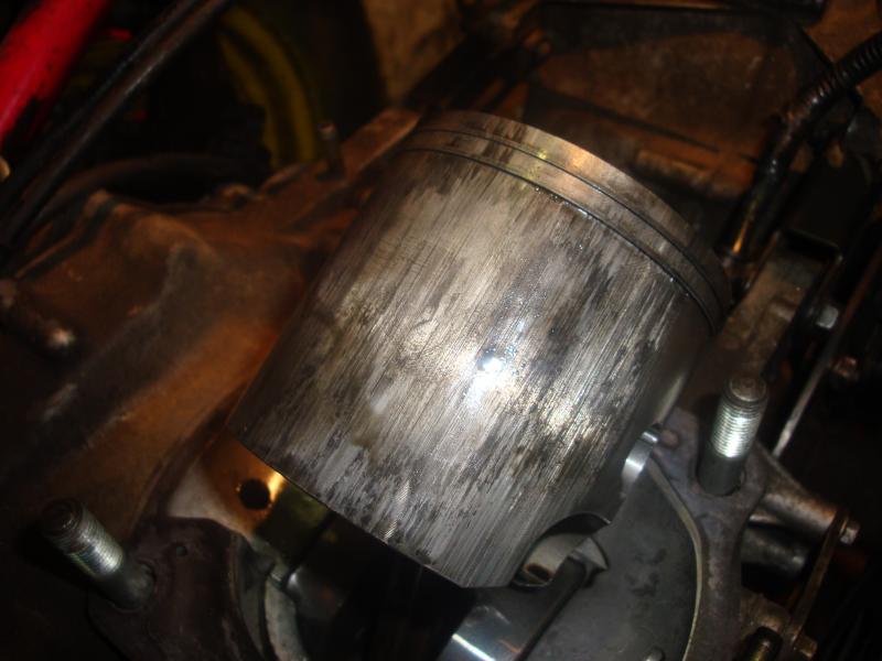

so today after I read hosers mini-essay on Engine breakin, I decided to check to see if the piston was starting to get wear (to make sure that it wasn't getting destroyed). luckily I barely had it at WOT (Wide Open Throttle) and I did start out slow but changing rpms as I drove. also before that, I had it running a bit in the garage.
here is what it looks like now.... is this bad?

PostPosted: Fri May 24, 2013 1:38 pm
Those are pictures after the cylinder was machined and that is the new piston and rings after you drove it a few times?
If that's true - will someone else jump in - I can not take anymore.

PostPosted: Fri May 24, 2013 3:16 pm
Sorry but im out of this one. Stupidity!!!!!!! Its blown up again. Looks like the old piston was just sanded down and pit back in. No oil holes drilled. Nothing cleaned up. And your worried about tires? Lets see the rest of the odyssey.
PostPosted: Fri May 24, 2013 3:17 pm
Time to sell it and buy a tractor

look honestly I just trusted my friends dad (the mechanic) cuz he knows what hes doing. he said hes dealt with a lot of this stuff and a little scoring is ok. I don't know if it is but he said it was and I trust him. and its very deceiving in the pictures. the little streaks of oil that look like big scores in the new piston actually aren't that bad. that are barely noticeable when your finger over it. it looks worse than it is.
and if it is all wrong then what am I supposed to do differently? i did almost everything hoser said to do in a breakin, ive put a little extra oil in the gas to let it get more lubrication as the piston and cylinder "meet" and idk what im supposed to do differently. im following the manual perfectly. it still runs fine so now, so what can i do to prevent it from getting worse like you guys say? i don't see what im doing wrong!
PostPosted: Sat May 25, 2013 9:54 am
No lube holes were drilled in the piston you or your guy even bother to read the instructions that came with the piston?

there aren't any lube holes in the piston because the guy who bored the piston relieved the exhaust bridge

PostPosted: Wed Feb 12, 2014 5:21 am
kiwi wrote:
I just got the block and piston off and here are some picks. the piston has been worn and its so bad that the rings wont even come off because the metal has either melted together or its just meshed together from the heat/pressure. im going to try to find a shop that might have a new piston and can resurface the insides if the block before I go looking online.
hopefully a new piston wont cost much?
also the last pic is of a wire I found. not sure where it goes...
Kiwi I just want to chime in here one time maybe two at most.
I see in the pictures the vacuum port for the fuel pump is not plugged !!! and you are running gravity feed. This will lean out your new rebuild and poooffkaboom Engine shot. So my question is was this vacuum port plugged after you did your rebuild ?? Yes or No please.
