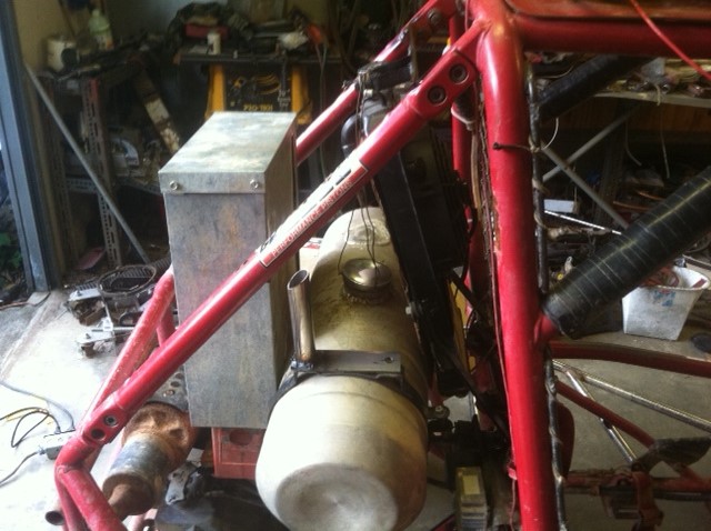

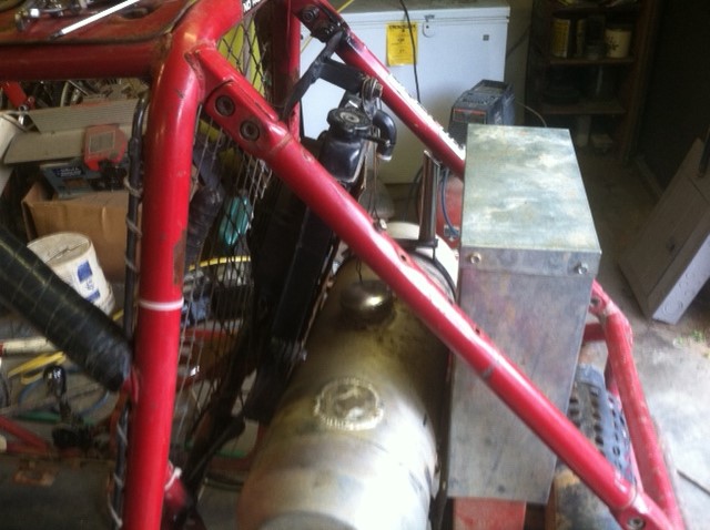

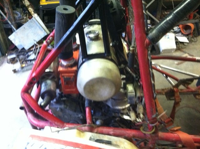

I got my tank position about figured out, I am hanging it in between the radiator and the pre filter. about the best place I could find. Thanks Billy
File comment: There will be about 1-1/2" in between the rad. and the tank when mount bolts are tightened.
File comment: The tube sitting on the tank is a hanger bracket to hold the tank in place.

Holy F*** bud. With that gas tank there you can't even see the Engine.
How the F*** are you going to change the sparkplug ??
Have you thought about mounting a fuel cell at the very back of the machine
and protecting it with some tubing ??
If I ever get my machines running I plan on mounting extra fuel can holders there.

Hey Bud what's up? The tank will be raised up when finished to get to the plug if all measurements are correct. I did think about the back to mount the tank but didn't like it. I have backed into enough trees and been bumped enough that I just didn't like it. I plan on maybe getting the tank installed this evening if I have time. Once that is done then I will install the Engine and post a few picks.. I have to repair the A/C in a rental house that has more priority than the tank. It makes money and the Oddy Takes it. LOL Thanks Billy

My bad, I thought that was the placement. Didn't realize it was just sitting there as a mock up. LOL.
You have a good point that I didn't think off and that was if you have fuel tanks at the back you can puncture them if you back into something. That was something I didn't think about and thanks for the heads up.

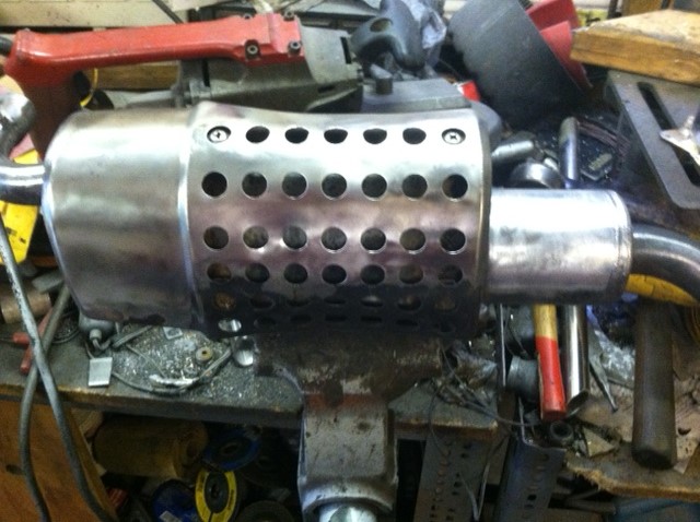

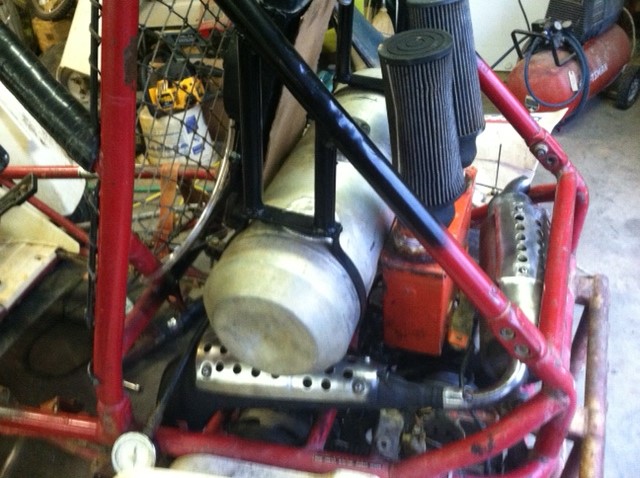

I got both fuel tank brackets finished today and the silencer out of the electrolysis and partly cleaned up. would have installed the Engine but waiting on the bolts and mounts to dry from cleaning.

Ok I got to install the Engine this morning and plan on starting it today (hopefully)!
File comment: plenty of room for plug removal and to work on Engine.

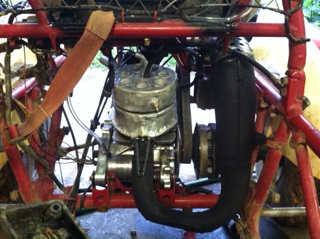

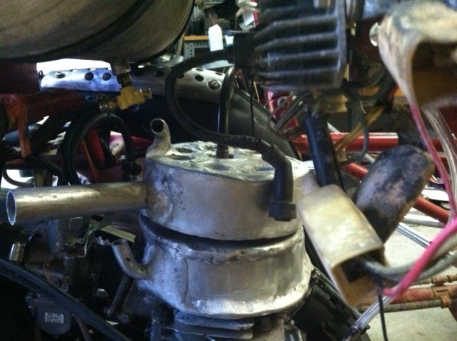

I got a small wear in done today, I rechecked the compression and it came up to 130 psi. I have plenty room to get to the plug, the choke is a different matter. But I think I have it figured out. but that is a small problem. I think. lol I have a few pics. to show but I haven't ran the cooling lines yet.
File comment: This is the front view.
File comment: This is a closer look.
File comment: Right side view.
File comment: left side view.

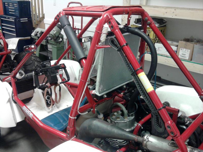

That's still a sexy lookin Engine to me
Don't tell anybody but I have had "a few sexual events" with it. LOL If you look at the close view you can see that there is plenty of room to get to the plug or the top of the head. You won't be able to look at the Engine compartment and see much but I think that's ok. I'll be glad to ride it again but time is kicking my butt, but Hell I got time. I plan on getting the water hoses today and may get them installed today I hope.
Where did you put your temp gage? I am thinking about on top of the steering wheel above the light switch. That was it is easy to see and can flip on the fan as needed. Thanks Billy
When I had my 350 I mounted my water temp gauge just above the key switch, I used one of those Auto Meter automotive type gauges, like a 2" diameter or something. I really didnt need to look at it much so "in view" wasn't that important to me. The Engine always ran at a normal operating temp, don't remember the temp right off hand though.

canadian oddy wrote:
If you zoom in on the picture you can see the temp gauge mounted on the roll bar. I put the gauge into a tuperware container LOL. Its a real good spot because you are always lookin at it.
With regards to the water hoses I suggest you run from the bottom of rad into the head first then to the cyl and back to the rad. I found some cold seizure on mine when I pulled the exhaust. I was running mine the other way and as others have suggested here I am going to re-plumb it all. Also put your temp probe into the cyl. It gets hotter there first. At least that's what have found on mine. I screwed up by putting mine into the head because it was convenient. I am in the process of doing it all over again. It's a learning curve and you can learn from my mistakes.
Thanks for the heads up on the plumbing. Did you run the water pump all of the time that the Engine was running? The reason I'm asking is that I am not going to use a pump. Or not if I don't have to, just one less thing to fool with. I am using a smaller radiator on mine then you are. I also choked the water coming from the cylinder to the head by using a smaller pipe and then going back out with the larger pipe. What I am trying to do is move the water slowly to cool down the cylinder and then head so I won't have a fast cooling of the cylinder or head. In my way of thinking it should work but time will tell. But I appreciate the help on it. Maybe this time you will have a better shot at your build. Thanks Billy
