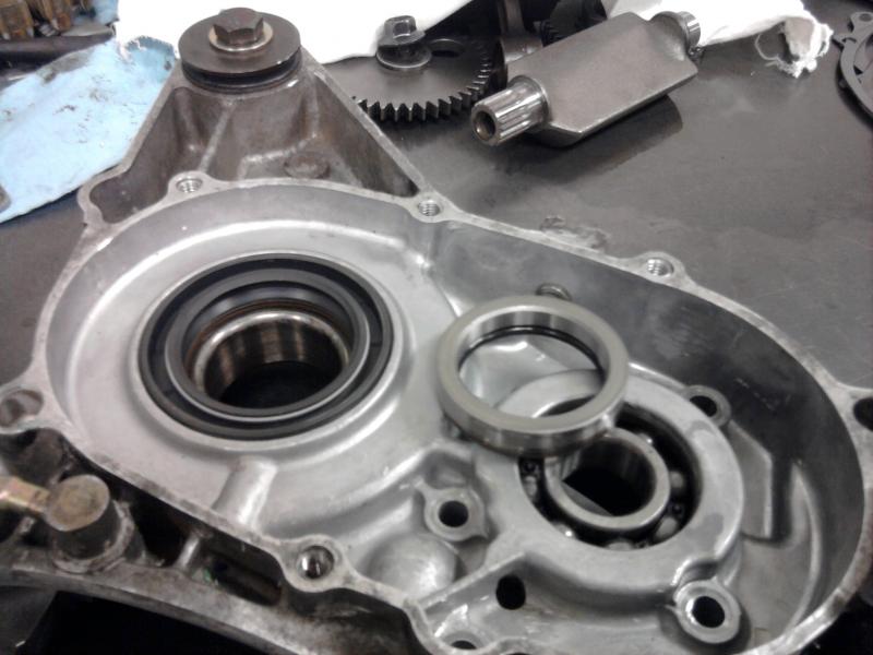

Ok I have a new problem, I have ran my 350 quiet a bit and have started smelling oil burning. I checked the balancer oil and it was low. I checked for leaks and found none. I pulled the exhaust and checked the piston for oil and it was oil on it and in the exhaust port. I installed a new double-lip seal when I built the Engine, but I have not pulled the clutch yet or the side cover. I plan on tearing into it maybe tomorrow night. I checked the manual and it doesn't say which way the seal is installed. Could I have installed it backwards? Thanks Billy
PostPosted: Thu Jun 19, 2014 3:08 am
Which seal did you put in, was it an original Honda 8mm or the U.K 11mm seal ??
I am not sure if it would make a difference but here is a picture of mine when I installed the
U.K 11mm seal.
My money says you damaged it at install.
U.K 11mm seal.
I put the 8mm seal in and I don't think that I damaged it but there is always that possibility. I will find out tonight, and let you know. You were having problems with oil also wasn't you? At first I thought that I was pulling in the oil from the foam filter and that was why I was smelling it burn, but when I seen the amount of oil I knew it wasn't that. so the only thing left is the seal. Thanks Billy
PostPosted: Thu Jun 19, 2014 8:37 am
Did you install the seal correctly meaning what direction was the spring on the seal facing?
PostPosted: Thu Jun 19, 2014 11:56 am
Posts: 363
Location: Anniston, Al
I should know tonight, I forgot since it has been over a couple of day's. LOL But one other thing that has been tumbling around in my hat rack is could it be the Mod that I did to release the pressure from the balancer? Could it be building enough pressure to be pulled thru the seal if it is not releasing enough with the mod? Thanks Billy
