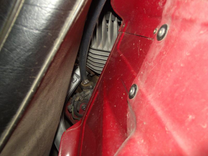

I modified the Ford F150 drain plug to accept a female brass barbed fitting and run I believe it's 3/8" hose to a bellows unit at the end of the hose. The bellows that I used for my final version was from a Can Am Outlander. To hold the upper end of the hose, I ran it through an old torn up FL350 factory exhaust mount with the rubber part punched out of it.
If you are interested, I can take some pictures for you. Seems the old post lost pictures after the site hack.

Did you install the plug in the stator area? If so, what did you use to plug it? I use a sheet metal screw dipped in silicone for the plug. Make sure if you use a silicone that you clean out the hole with a solvent to assure all of the oil has been removed.
Here are pictures of the vent installed.....
The first three pictures are of the wife's mounting in her Ody.
The last picture is the upper hose mounting bracket for my Ody. If the part looks familiar, it is one of the muffler mounts with the rubber part punched out.
File comment: Hose installed in fill plug (dip stick) hole
