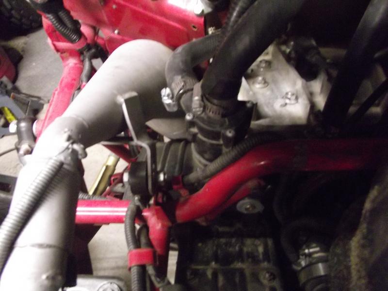

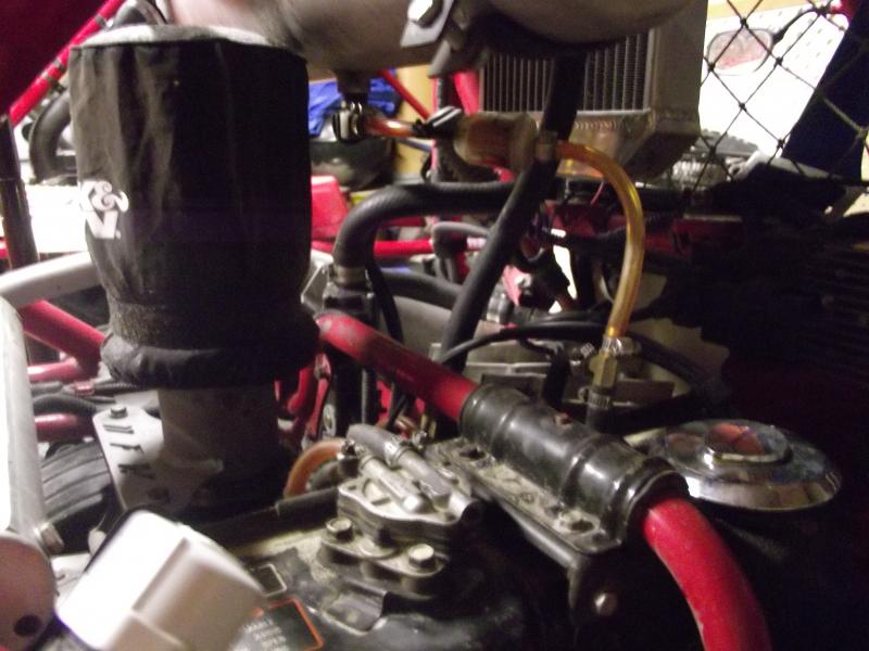

Current set up and works real well.

Can you post pictures of your Ody's intake and exhaust?
Each and every Ody can be a little different on jetting so you will need a few main jets to find out which one is the right for your Engine's needs.
You mentioned picking up an air filter also so that will also effect your jetting. I would suggest having a 142, 145 and 148 main jet on hand.
AFTER THE PROPER HEAT CYCLES AND BREAK IN WITH THE NEW BORE AND PISTON.....
If you truly have no other modifications other than what you mentioned, start out with the 148. Go out and warm it up for at least 15 minutes then do some plug chops to see how she runs and what your plug looks like. Remember, start out way too rich and work your way down to the proper main jet. You are after a nice dark UPS truck brown coloring of your spark plug. Remember, jets and plugs are cheap! Start too fat and work your way down.

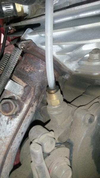

By the way if you blow a u joint it will take out the shock. You need something like below, it called a shock saver. Chains with shrink tube over the top to keep them from slapping around. Works great.

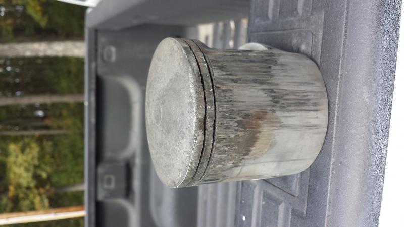

Here is a pic of the latest piston
Check your mail box.
That's detonation !! Shitty fuel.
I see that the edge of the piston is "chipped" away and not melted.

We all ready know that your Ody was extremely under jetted (120 main when you should be running a 142 at minimum). I have seen this same thing happen to Ridindirty's Ody when the three way valve failed when he was pushing it hard in the dunes.

Yelp underjetted, low octane and air filter junk. Im doing my homework and i appreciate all the help fellas

By the way your piston is not drilled -- another boo boo.
