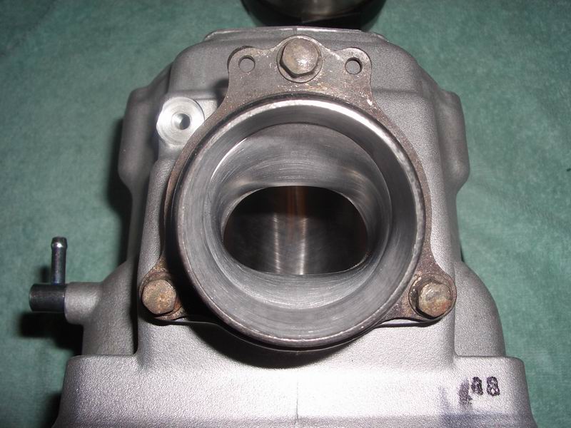

Stixs heres a pic of a factory cylinder look at hte casting flaws,miss alignment on sleave and hone in cylinder as well as port chamfer.
File comment: This is a stock cylinder before clean up
File comment: Same cylinder cleaned up and taper bored exhaust port before porting. look into cylinder. This increase flow
Resize of same cylinder but reworked ( cleaned up and taper bored.jpg [ 115.02 KiB | Viewed 1643 times ]

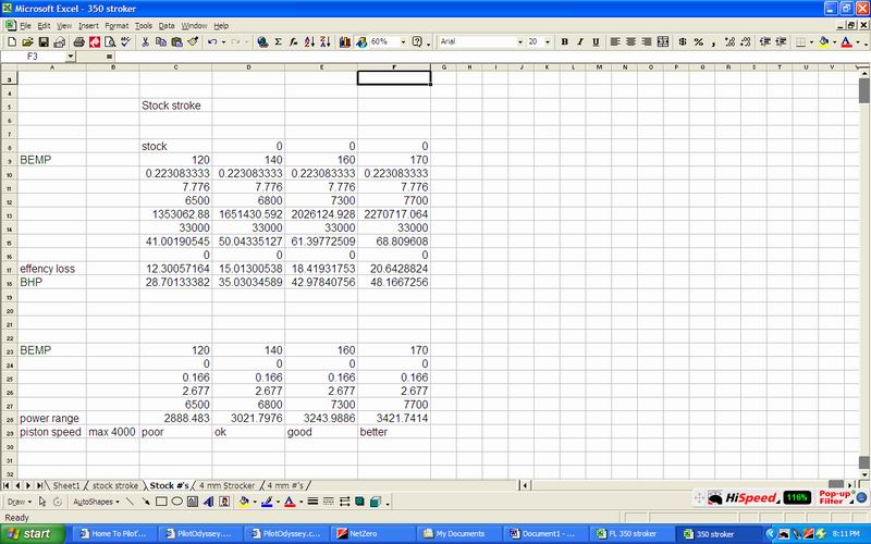

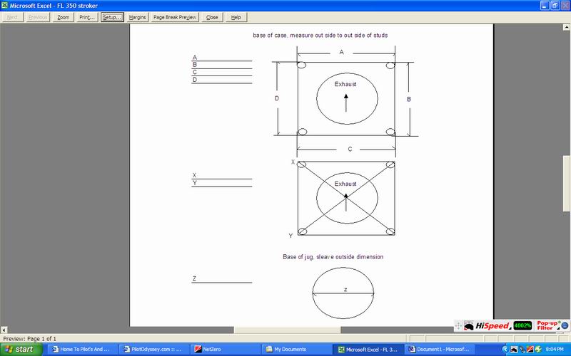

Remember these numbers are from DS#1(Zac's). DS#2's jug is still mounted and running.
A-108.05 (4.52)
B-114.95 (4.53)
C-113.06 (4.45)
D-114.90 (4.52)
X-154.5
Y-155
Z-86.46 (3.40)
Stock stroke is 68(2.677). Yup Im liking the numbers, looks like 70% increase in HP with 170
