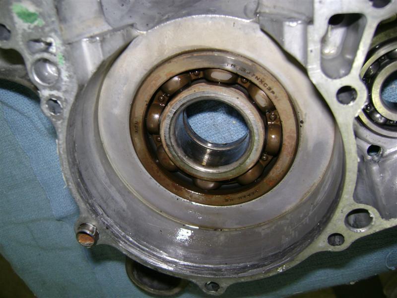

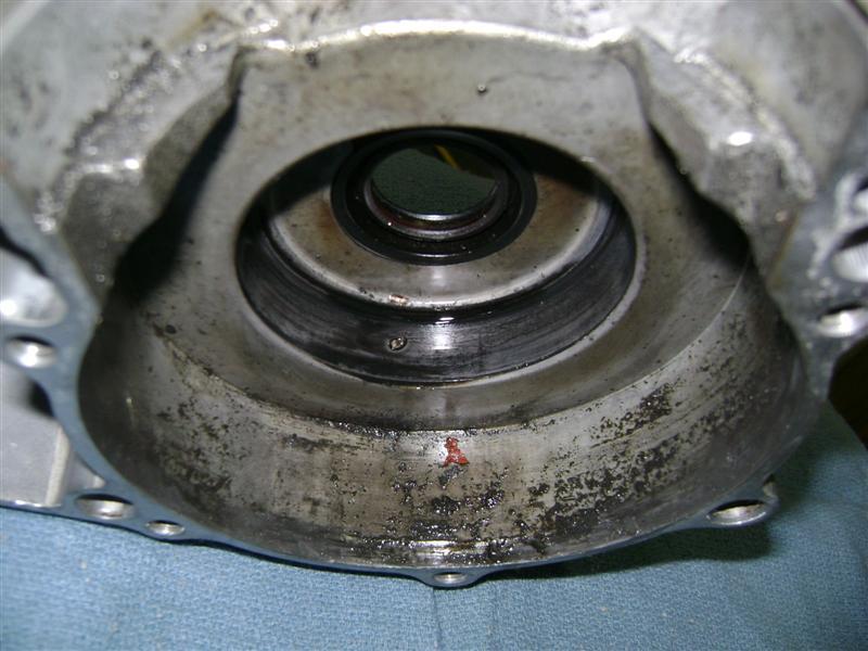

The cases took a pretty good hit, I need a new crank case gasket so I can see just how far the cases were pushed out and if they will seal again (the gasket match the cases where they were pushed out) if that's ok then lapping them will make them usable again..

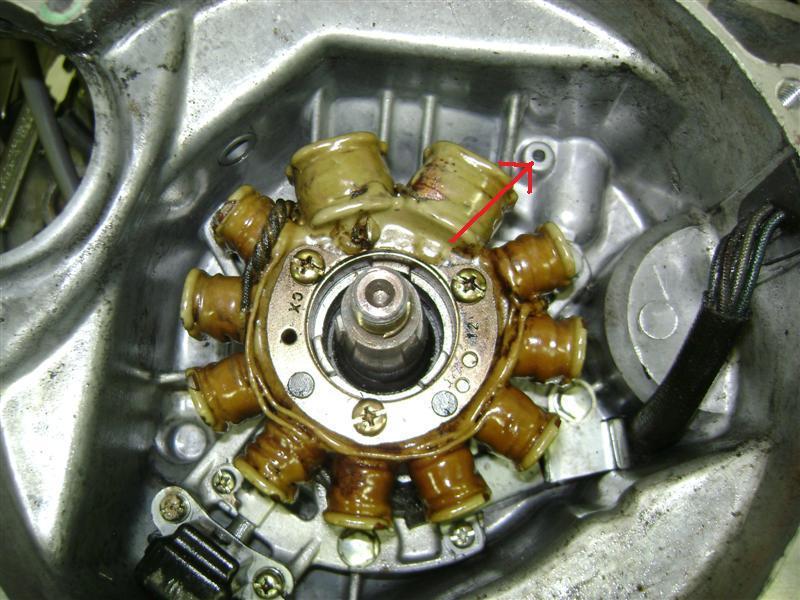

Weed has complete 350 Versah gasket kits. Anybody used Versah?, they any good?, good fit etc...Randy said Honda base gasket and case half gaskets are all gone. He gets some of his parts from Service Honda. You might check with Hillside or Mario at Palmetto Motorsports in California for Honda gaskets. Also it doesnt look like ATVR did any starter mods. The pic with the arrow shows the hole they were supposed to seal up,I wonder if they at least vented the counterbalancer oil side of case?

I will take a closer look but I don't think any part of his oil venting was ever changed or modified.

Yup cases are good thought I told you that before I left on my last trip?
