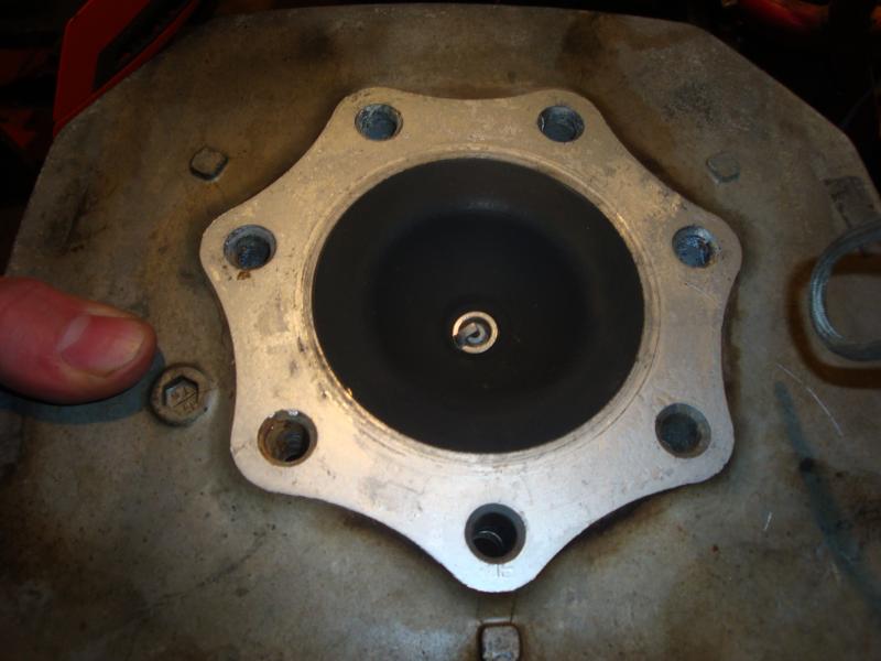

idk if these help

PostPosted: Sat May 11, 2013 12:09 pm
So what is the compression?
See the rust on the cylinder walls, see the vertical scratches and scuffs in the cylinder wall I bet the rings are stuck.

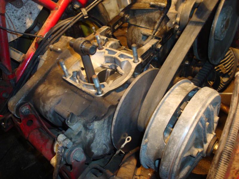

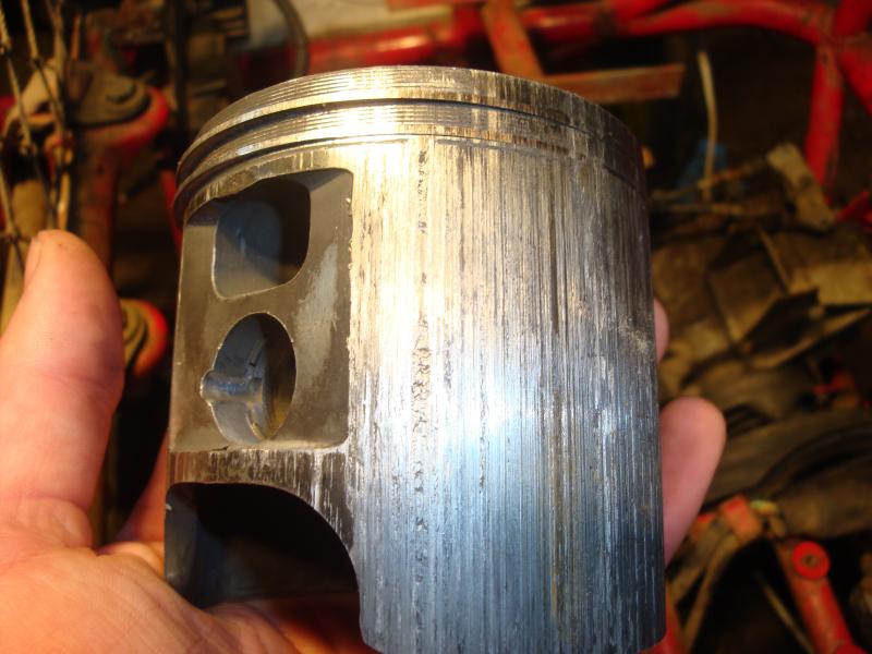

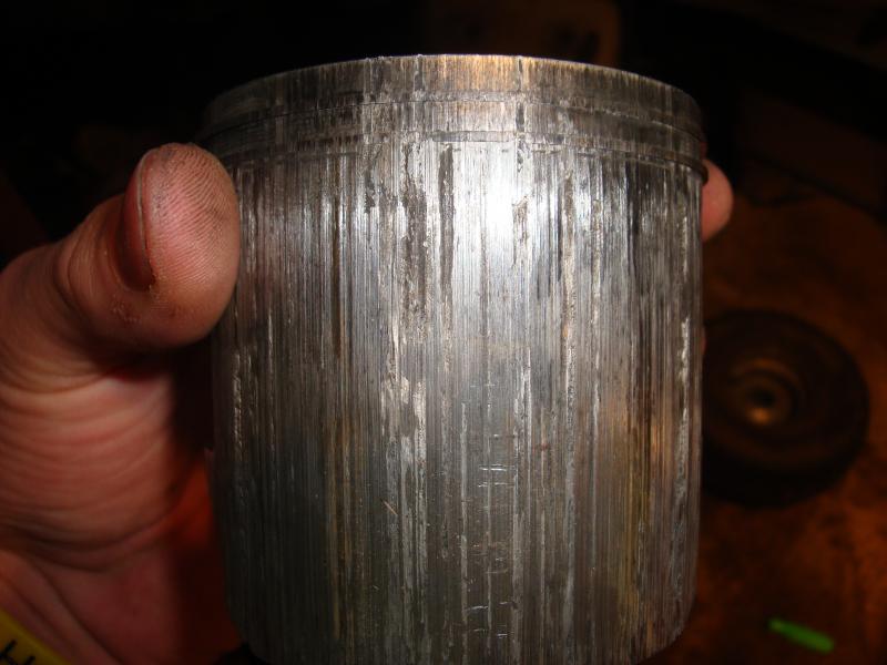

I just got the block and piston off and here are some picks. the piston has been worn and its so bad that the rings wont even come off because the metal has either melted together or its just meshed together from the heat/pressure. im going to try to find a shop that might have a new piston and can resurface the insides if the block before I go looking online.
hopefully a new piston wont cost much?

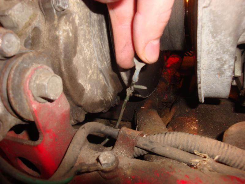

also the last pic is of a wire I found. not sure where it goes...

PostPosted: Sat May 11, 2013 4:25 pm
Like I said in the begining it was blown. You need to bore the cylinder and put a new piston kit in it. As well as get a fuel pump set up back on your machine to run properly and mix oil into your fuel. Pull your starter apart and soak it all in gas for a day or so.
Cost will be
bore job is 80
Piston kit 165
Top bearing 18
Topend gaskets are 35
Carb cleaner and oil 10
Fuel pump 30
Fuel lines and filter 10

and what about the wire?

The wire is a ground wire that goes to the frame I beleive or the Engine by the clutch(exhaust side).

So the question was why cant I just get a piston?
Wiseco makes the piston you need. take the cylinder to a bike shop ask them what the bore size of the cylinder is
if it is at 80 mm you will need a 80.5 mm piston they can help you with this.
They have to have the piston first so they can bore youre cylinder to that piston. There are other
thing that need to be done to the piston here is the clues piston prep and bridge relief. When the cylinder
is bored it needs to be bored .004 to .005 more than the piston.Correct me if I am wrong here guys
.[color=#000000]
[/col
Now if you are on a budget start saving or buying parts a little at a time known as hording . When you have enough parts to put it back to gather next step. Also the bearing is in the rod which connects to the piston via the wrist pin the wrist pin is held in place by the circlips. Talk to the guy at the bike shop ask the right questions he will help you , heck if you have to tell him the truth all
of this Engine lingo is greek to you and you need to be educated a little you want to learn. Swallow a little pride.
If you are young these guys are a little more inclined to help you . a Manual will help a lot if you can afford it .
The wrist pin bearing needs to be replaced because it although you cant see it got hot and distorted getting really hot
with no lube like youre Engine is not good and destroys parts. Kind of like youre rings and piston and cylinder you can see that.
