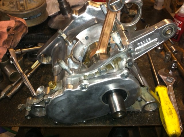

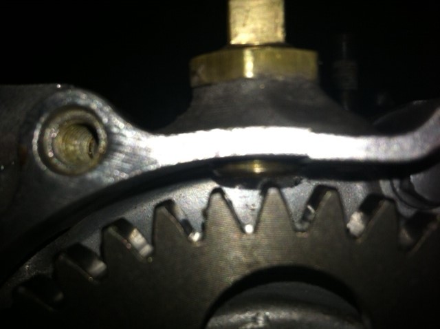

Ok got the bottom end put back together yesterday. Here are a couple of pics.
File comment: This is the back up for balancer mod. It has about 1/8" clearance between the balancer gear and bottom of the fitting.
File comment: This is when I installed the crank. Notice the condensation on the crank, I had to place it in the freezer to get it to drop into the bearing.

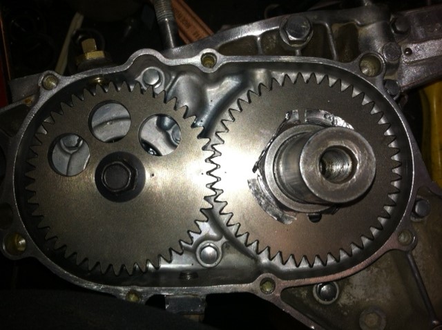

And some more pictures. Thanks Billy

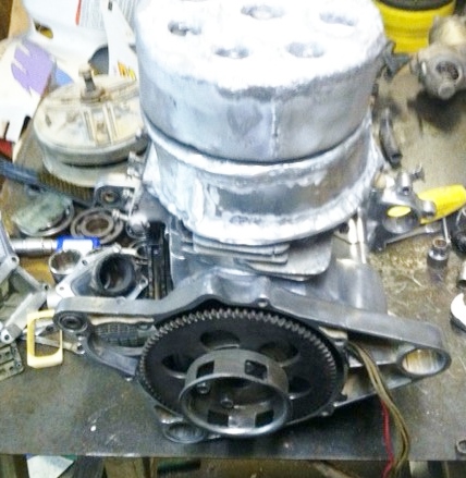

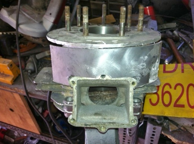

I finally got the cooling fins removed the way that I wanted, so I started on the outer shell of the cylinder. This is just a test fit but, I think around the intake and exhaust ports will be the hardest. The rest should be easier.

I got my divider installed on my cylinder last night, and the outside jacket above the intake side of it also.

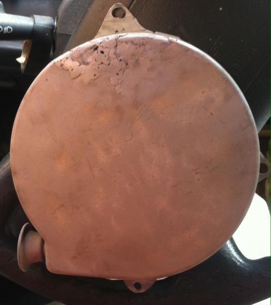

Location: Anniston, Al

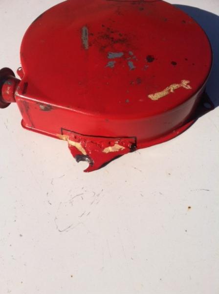

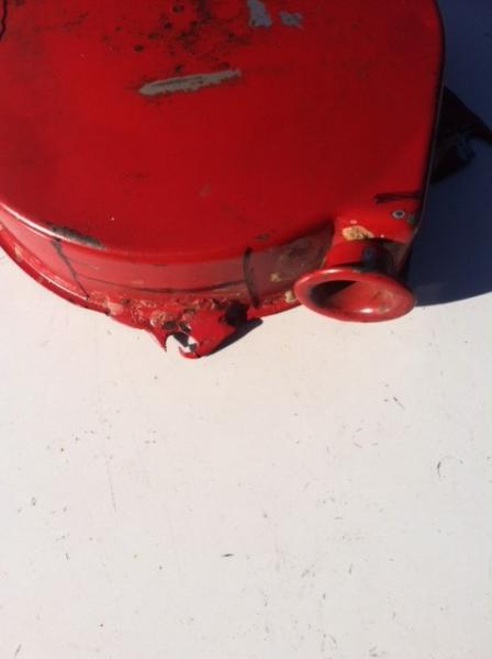

Update I have everything ready except for the piston and bore. I have a piston and when I took it out of the box, it was the wrong size. To make a long story short I had to order another one from another place to get it here this week and I will deal with the wrong one later. But it is out for delivery today so off to the shop in the morning for bore job. Also while this is going on I decided to repair my pull start cap it has always been in bad shape so now is the time to "Get R Done". Here are a few pics of it and after I get it finished I will post some more of it. I haven't heard anything back about reeds or stuffers so I guess I am on my own on that one. LOL Good enough! Thanks Billy
File comment: at one time it was tried to be repaired but not right.

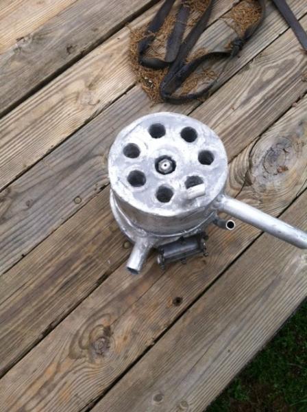

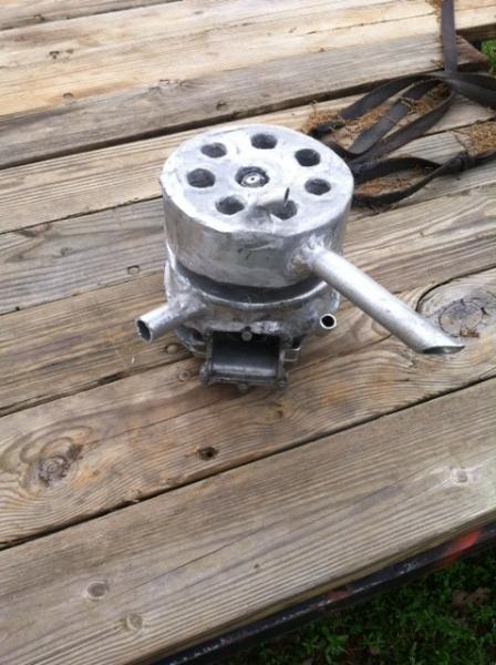

Can you post a couple of pictures of the head and cylinder in/out water ports ??
Ok this is the first pics that I have tried since the phone dumped. I haven't cut the inlet pipes yet. I'm waiting until I sit it in and mount the radiator in place. Or I think that is what I'm doing. LOL

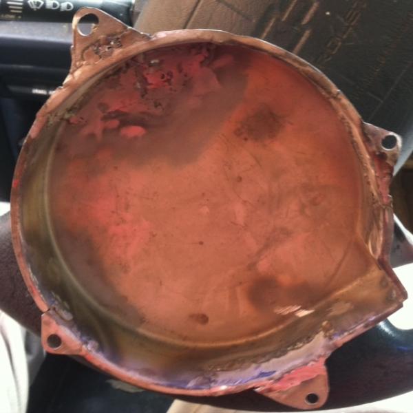

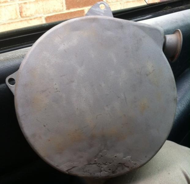

I've got all of the cracks and broken ears welded, but not finished. I am thinking of placing gussets on all of the bolting points.
