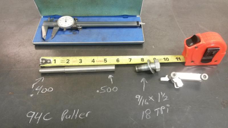

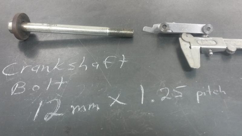

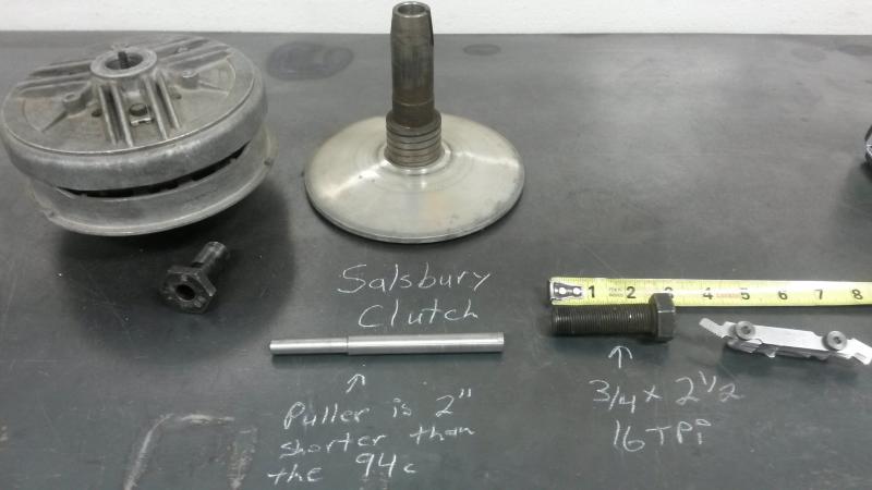

Clutch pullers -- make a push rod out of round stock and grind it down on the grinder if you don't have a lathe. Don't be cheap on the grinding. It must be smaller than the threads or you will damage them. It must also be able to go deep enough to bottom out in the crank.

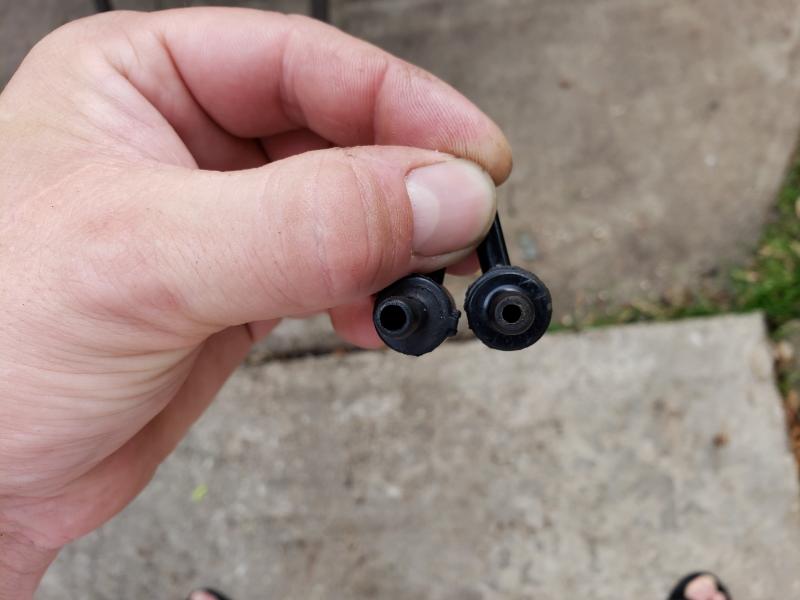

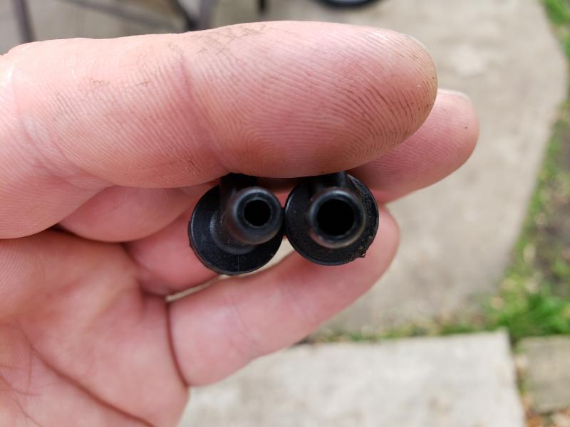

I replaced the check valve on my sons fl250 and kept the old one. It doesn't seal like it should but I was comparing to the one that came on my fl350 and the hole is a lot smaller on the fl250 one. Maybe that's why the fl250 ones work?

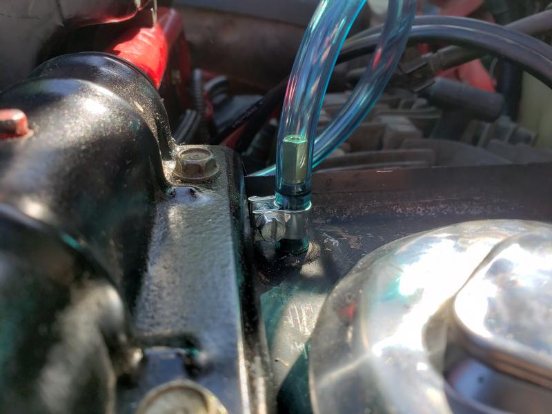

I installed the 190 main jet, it sorta screwed right into the port going into the gas tank. I slipped the hose over it and clamped it. I'm going to try the fuel pump test again just to make sure I still get 4.5 oz with the 190 jet.

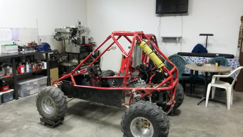

Front tires are now on, went with 23" tall sunf tires. Just waiting on seat belts for my other sons FL250 and then their wrist restraints before heading to the bad lands.
Fuel pump test passed with the 190 main jet instead of the honda check valve.
I'm also thinking of buying a fire extinguisher and mounting it to my FL350 before we go.

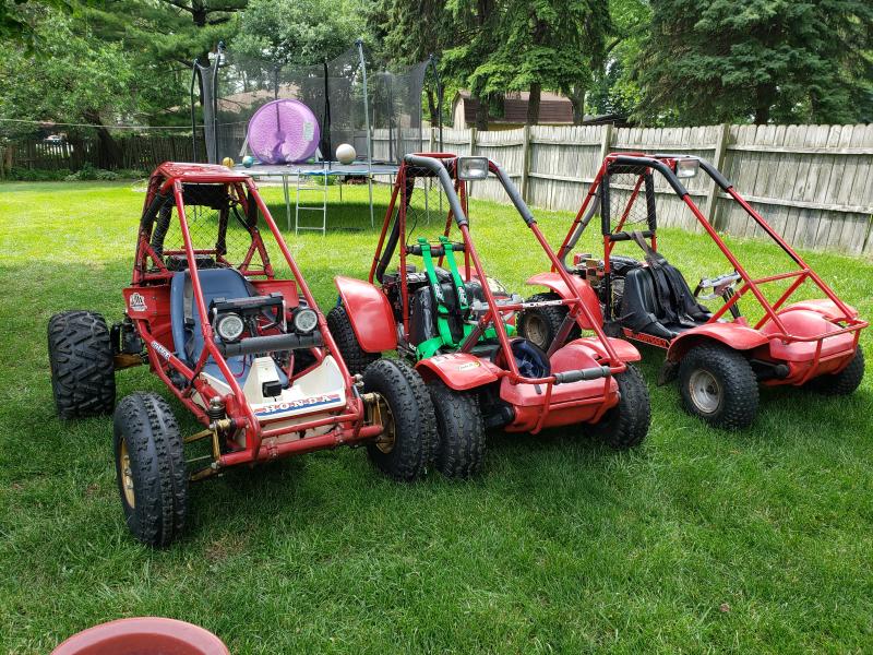

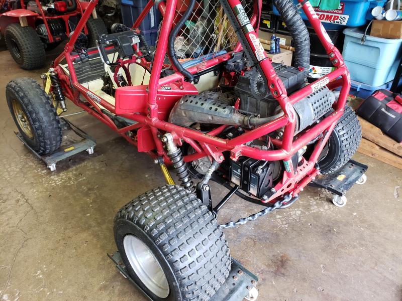

I took the kids to the badlands on a Wednesday so it wouldn't be so busy. We had a great time, all three machines ran great.... I need fenders.

PostPosted: Fri Jul 26, 2019 4:37 pm
Looks like you're a great dad. Doing what a dad is suppose to do. Good job.
NO you don't need fenders. All you need is skirts like I have on my machines. They are light because they are plastic.
Please keep an eye on your pump fuel flow.
I have had a lot of trouble lately with that issue and now have switched to electric pumps on all my machines. Have not test run them yet but will probably get to that next week.
If your Engine has great bottom end and then suddenly at mid throttle or full throttle it feels "flat", that's your fuel pump not putting out enough fuel.
CO
