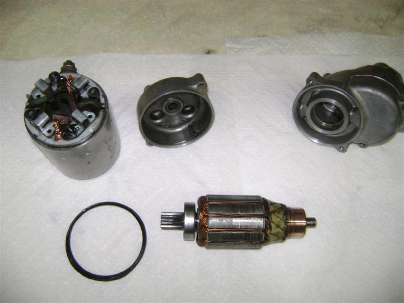

Everything cleaned ready for assembly, I put the armature in the lathe and polished up where the brushes ride.

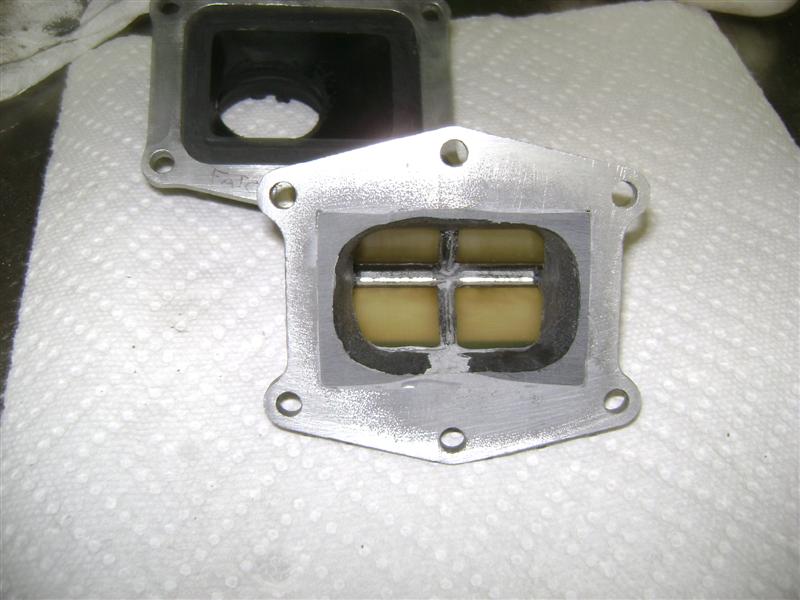

Finished the FMF reed cage and installed the stuffer was warped I have repaired these before with JB weld, not perfect but 100% better also much better than the stock reed cage with after market reeds.
Before
After

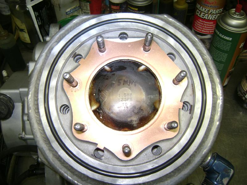

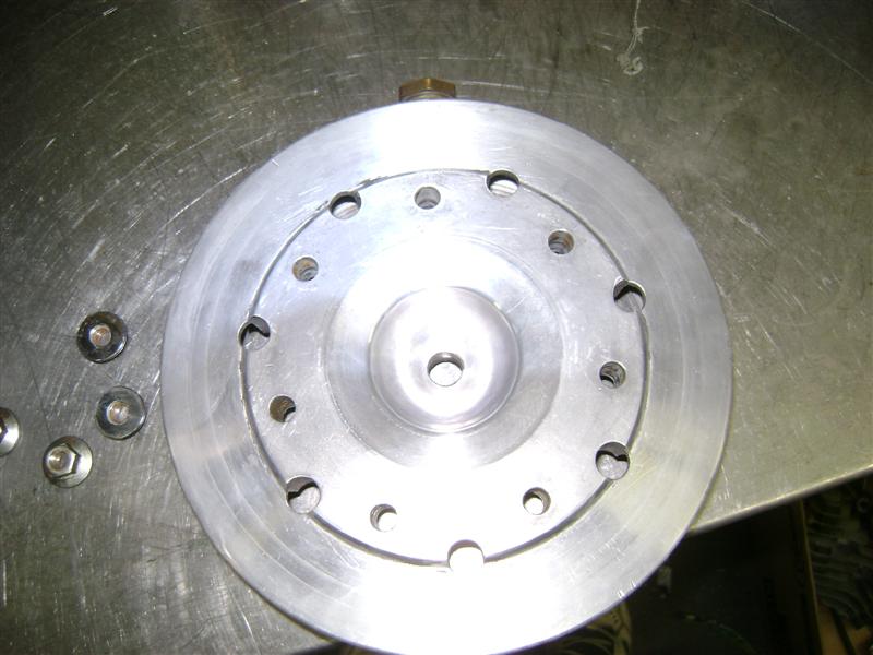

Your after market cylinder and head install went off without any problems, I cleaned up the used piston and installed using the new circlips and used rings, honed the cylinder, relieved the exhaust bridge just a little more, the piston you supplied was very low hour and should not give you any problems, run it a season (30-50hrs) then pull the top end off we will inspect it again.
I only have a few pictures of the assembly I took all kinds of pics but cant find them I wonder if my camera or memory card in the camera is getting flaky this camera has taken thousands of pics over the years I have read where the memory cards start giving errors as they age or used a lot?
Anyways I used your supplied cylinder gasket that was already copper coated perfectly, then before installing the head installed a single layer of a used head gasket and measured the squish clearance and found .040 clearance, then assembled the head using your supplied single layer gasket.
I cant wait to see this thing running I bet you will be happy.
