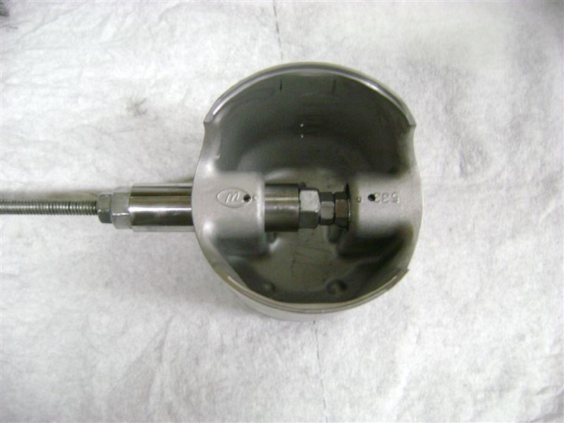

Got your piston last night, the wrist pin was tight as hell their was some scaring in the wrist pin bore, scratches and gouges making it stick and tight, I had to go a little MacGyver and took an old wrist pin and put it in a battery drill on low with plenty of oil and lapped the high spots off so the pin now moves as intended, had to run 2 battery s completely dead to lap it in, oil is not very abrasive lol.
The gouges on the outside of the piston wont hurt anything once they are sanded and filed down I would not hesitate to use this piston in this condition the damage was only cosmetic, you didnt send the rings so I cant speak for them I would have to check them before I could give you the two thumbs up.
You will need to buy new circlips you can get them at a local shop or from rockymountainatv try this link

The wiseco clips are a pain to install and are easily damaged so spares are a must!

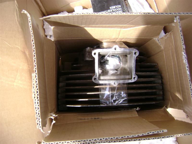

Cylinders are here UPS came early, not impressed with the packing don't look like their is any damage.

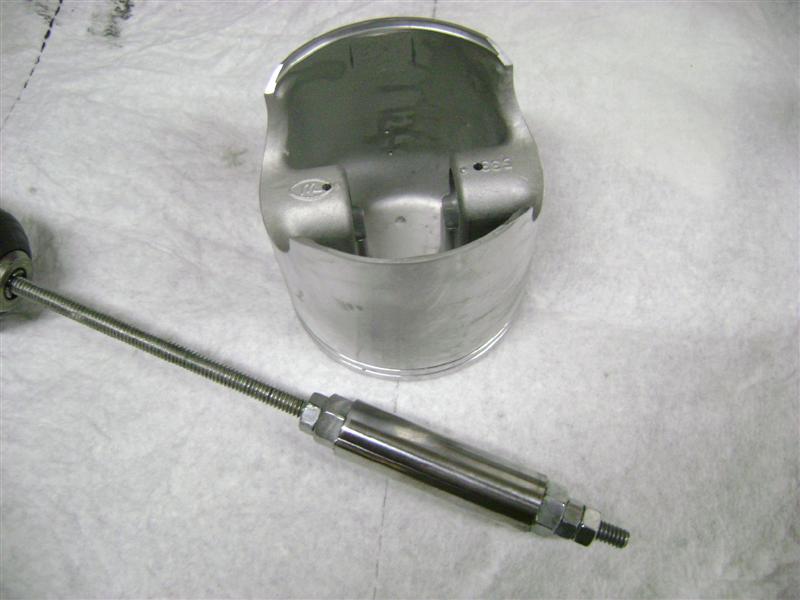

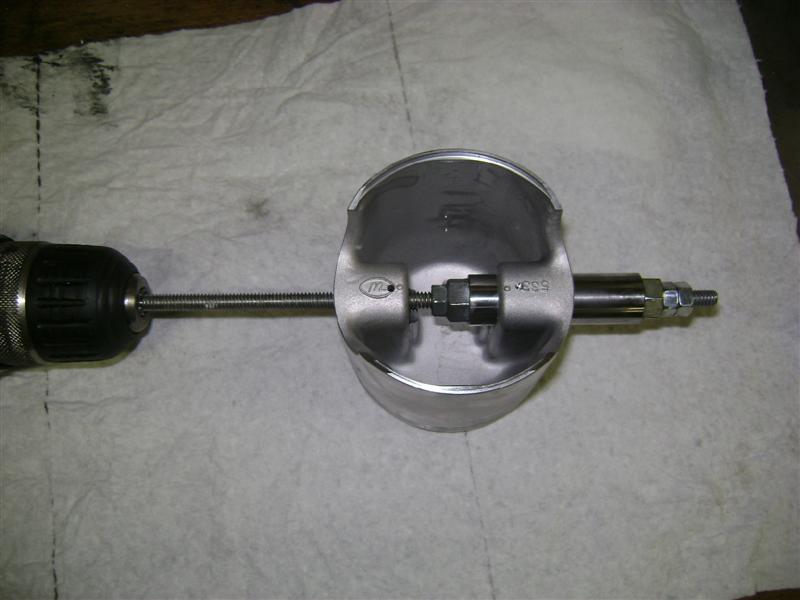

Not sure why they added peanuts to the box their is not enough their to do anything, only thing I can think of is people think packages set static during shipping like boxing it up and setting it on your kitchen table, not much padding is required, at UPS the first thing they do it toss your package 10' into the air and land it on concrete to break in the box for shipping, then it bounces up and down 100 times a mile while its on its way to be delivered where the UPS guy will just drop it on your front step from the waist (seen it done dozens of times) then claim it was not packed right lol in my case the front step is concrete.
See in the one picture how the head studs pushed through the cardboard? Take your old broke cylinder and try to duplicate that, see just what it takes to push them through cardboard, a few thousand bumps will probably do it, wonder if them studs are still straight?

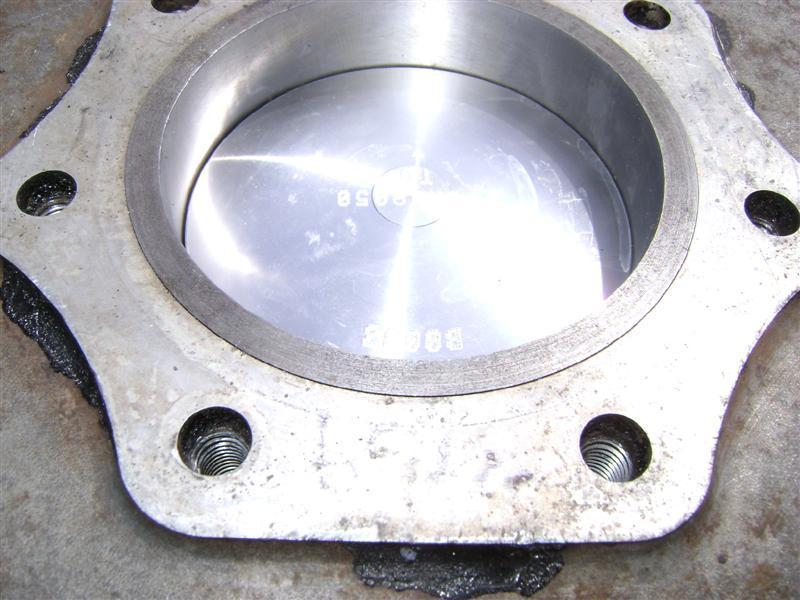

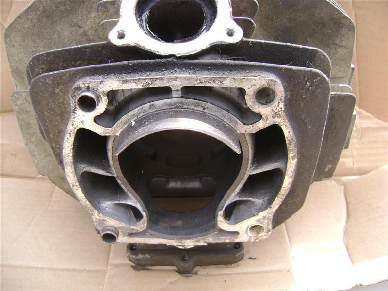

Here is the first one out of the box. it looks like it suffered a nice death blow their is aluminum smeared all over the cylinder walls, I will clean it up and measure the bore, the bottom of the cylinder looks ok.

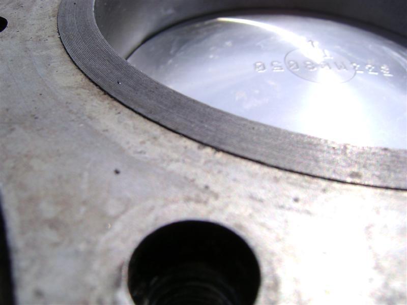

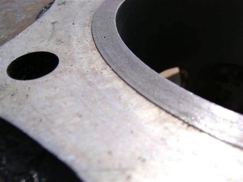

PostPosted: Fri May 08, 2009 4:17 pm

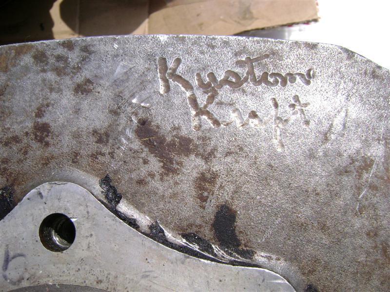

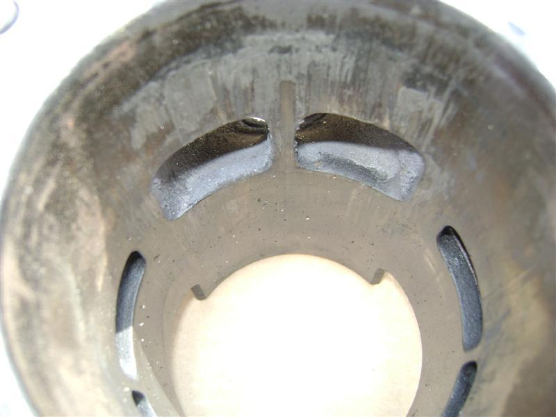

Cylinder two came with a piston, cylinder says Kustom Kraft on top, looks like it had the sleeve replaced, if Kustom Kraft did the sleeve your in luck I have never heard anything bad about his work and the sleeves he uses are said to be better than Honda's
Noticeable right away is the top of the cylinder is not flat, I will have to take a close look at this to make sure the liner has not shifted up, then lap it flat so the head gasket will seal.
More later after I clean them up and take a real close look at them, the piston is the older style with all the machine work done, their was no holes drilled in the piston so I will drill them.

Bored one looks good its set for .0045 clearance, I need to drill the holes in the piston.
The other one will need bored for sure I will try to get it in the boring machine this weekend and make a few cuts to see if the piston you sent can be used or not.
