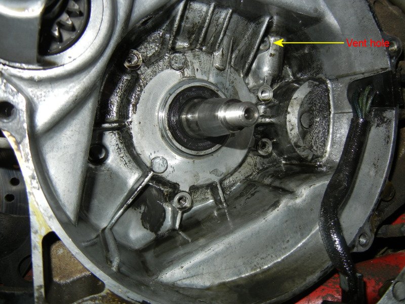

The oil seal was leaking so I replaced it with a new OEM Honda seal last week. Took the 350 out yesterday for a day of riding and found that it was leaking again. It looks to be seated properly.
Did I install the seal incorrectly?
PostPosted: Tue May 29, 2012 4:19 pm
Did you pressure test the Engine ensure the seal is in fact leaking? Looks like oil coming from the balancer case vent to me.
Did you install the seal flush with the cases?
Did you grease the seal before installing?
Was their a grove in the crank shaft where the seal rides?

Looks like the vent mod has not been done.... I would say that is were you are getting the balencer oil from....
I would leak test the Engine and perform the mod to the balencer vent breather.....
PostPosted: Tue May 29, 2012 5:01 pm
I second that. The seal isnt leaking its your balancer oil from the vent hole.
PostPosted: Tue May 29, 2012 7:26 pm
Vent hole they are talking about

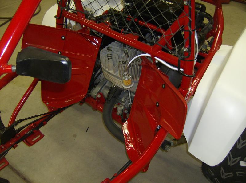

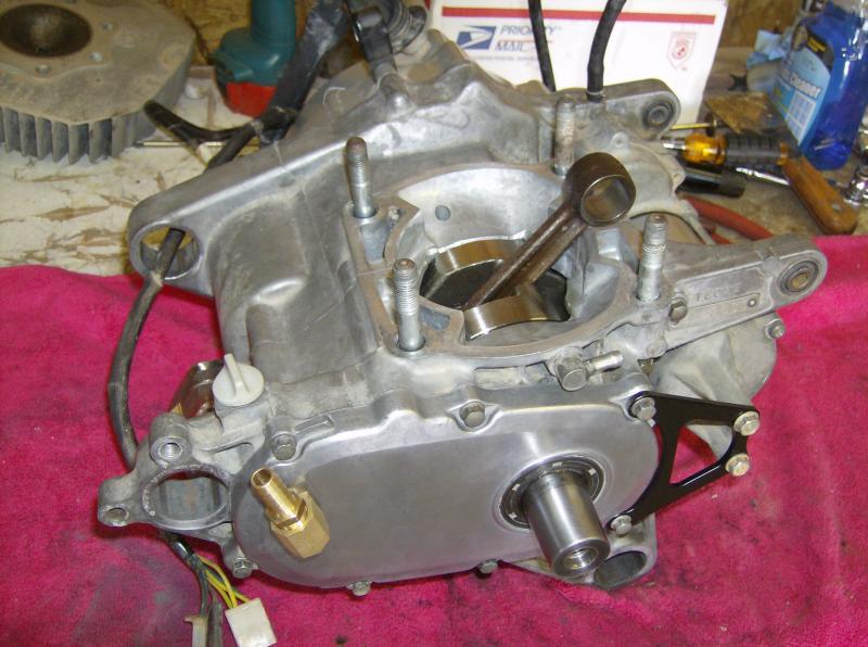

You put a screw in the vent hole and then add a vent to the balancer gear case as I did or others are modifying there dip stick.
File comment: The vent hole is blocked with a little silicone and a sheet metal screw
File comment: added fitting for the new vent hose that I have connected to a fliter
File comment: here is the vent hose hooked to the filter. I have both of my Odys set up this way and it has worked well for me

Mine has a brass threaded fitting with a hose barb coming out. You'll want to run a long hose with a fuel filter high on the frame. Some guys actually mod the dipstick. Either works fine but I'm not sure exactly what they do to the dipstick. I carry my dipstick in the toolbox so I can check my oil level any time. Good luck
Edit: if you look at the first pic in this thread you can see the fitting I speak of. I recommend using one with a 90 degree bend. You can use the hose barb as a lever to remove without tools for ease of checking oil.

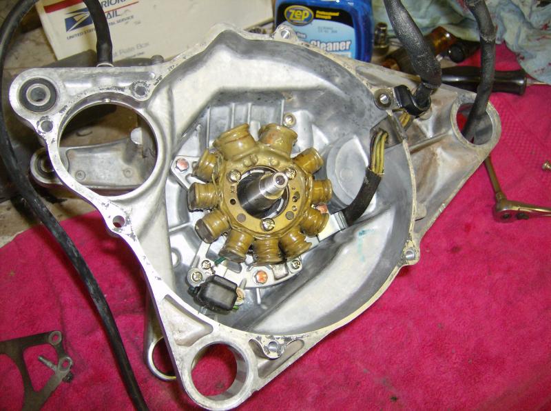

Doing this mod, does the air vent above the starter have to be plugged?
PostPosted: Fri Jun 01, 2012 1:59 pm
No, the only vent you plug is this one

PostPosted: Fri Jun 01, 2012 9:55 pm
That looks very nice. Good work
