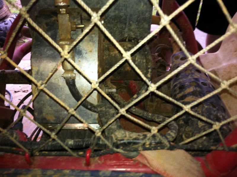

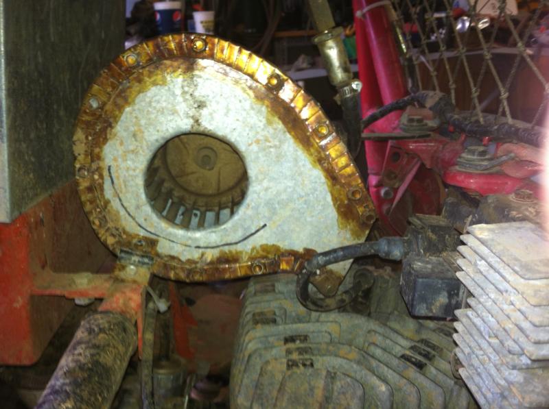

Ok I finally got some pics of the cooling fan that I made. It looks rough but paint will (help) on that. I will get the amp draw and cfm's or velocity tomorrow I hope. I have it blowing across the front of the head and then off of the back of the seat to the cylinder and head. I will find out how much it cools it down also, and how long it takes.

That's a manly fan! You may need a deep cycle battery on board to run that sucker a lot.
Not at all, I run it alot and have never had any problems "YET" But it works good and has a small amp draw. I am going to check it again and put the #'s on here. Just haven't had the chance yet. I work out of town all week. Thanks Billy
