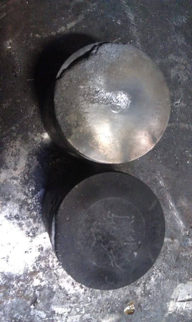

I bought these cylinders and I was wondering what happens to these piston's
Left is an 81mm weisco. Right 78.5mm art
I'm thinking head gasket leak ?

Looks like they over heated to me.

i have a 79mm art piston that looks almost the same..i believe i was a touch on the lean side and was riding it hard and to many WOT (Wide Open Throttle) runs

Looks like they were leaned out and started to melt down.

They blew up.

could a head gasket do that?

Either jetting was lean or you had a air leak and it ran lean
