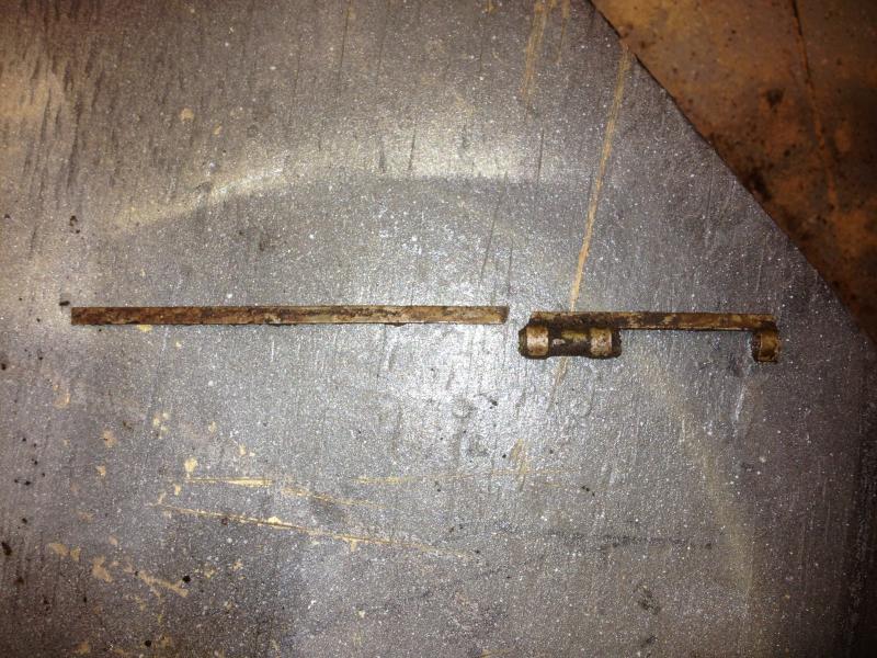

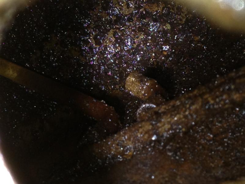

Ok I have a spare fuel tank from a parts fl350. I'm going to
Use electrolysis to clean out all the rust and use por15 to reseal it up. Upon finally removing the gas cap with a d23 key I had made
From the ignition sw code( thanks-BS, NITROSPORT). Looking inside the lower line has a few pieces that fell off upon shaking out all the rust and junk. The upper line goes to the bottom of the tank and looks like it may be plugged at the bottom? Do I need to somehow try to reattach these pieces or don't bother?
Randy
File comment: Bottom of tank

File comment: Where part fell off
File comment: Parts that fell off

Wow that thing is pretty rusty... Can't wait to see how the por15 takes care of it...
This is a very common problem with the pick-up line... You can leave it like this but you will have to run the petcock on reserve all the time....
The line that goes all the way to the bottom of the tank is the reserve line, you will want to take off the petcock and blow air thru the lines to make sure there is no blockage, if there is run a piece of wire thru the line... You will want to do the same thing when you por15 it to make sure the line stays clear... Hope this helps Dune Dart

Can I put a short piece if hose onto the pickup to extend it down?
Randy
 Post subject: Re: Fl350 fuel tank
PostPosted: Thu Dec 13, 2012 6:22 pm
I think that would be more difficult than drilling out the drain plug but I don't see why it wouldn't work with some effort.

When I looked inside my other 350 tank these parts that fell off don't look like they draw fuel any lower with them on! I also think my res line is plugged! Ill wait and see how the electrolysis works on it!
