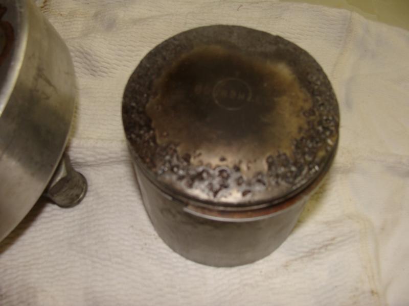

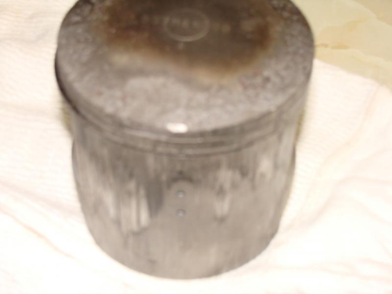

This came with the oddy I bought it was on the extra Engine.what caused pitting in piston and head
to use the head does it need to be cleaned up or can I use it ? If need new one, can anyone identify
and do they make it still?

looks like an chucklenuts at aftershot motorspurts head. and it almost looks like the bearings from the the bottom end went up through it. do you have the bottom end? what shape is it in?

it is motorspurts head just found it. Yes have bottom end doesent seem that bad. Is the head pretty much done? And since its chuckelnuts is it even any good?

Id say the head could be re-used, but since they are still being made i would see if you could order a new combustion chamber from chucklenuts at aftershot motorspurts. As for quality, i am unsure. I know there was a member that was running one without issue. I forget off the top of my head who exactly it was. Maybe start a new thread asking about it?
How do the cylinder walls look? If the piston top is that bad i would assume the walls would be destroyed. Unless the prev owner re-used the piston with just new rings for some reason. Looks to be a wiseco piston? I would make sure to inspect the bottom end very closely if you don't plan on splitting the cases. wouldn't want an unknown bottom end destroying a new rebuilt top end.

Any more pics of the piston?
Checked the ring gap locating pins?
If all is there on piston,then maybe something got sucked in via inlet? Reed petal screws?

I will get more pics tomorrow. So you are thinking some object was loose in the combustion chamber?
I guess that could be, the walls of the jug doesent seem too bad. I will get more pics and post em.

Looking at the indentations,they are round like.If it was from broken rings etc they leave sharp edged marks.
Think of the marks like footprints in mud.....no NOT THAT Mud! :-)
If you have some blue-tac,or plasticine,push some on to the marks to make a reverse shape of the UFO,make sense?
Post pics for us lot to have guessing game?
Might be a round head reed screw?
You need to make sure it's not in the bot end still,otherwise future damage will result.
If you can't find the culprit,hopefully it's gone out the exhaust,check that too,don't want it pulsing back in hey? :shock:
