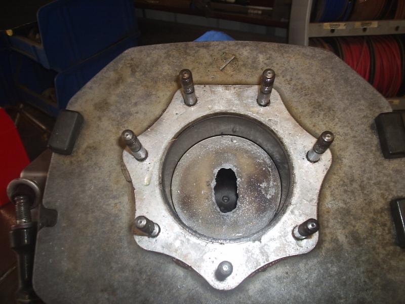

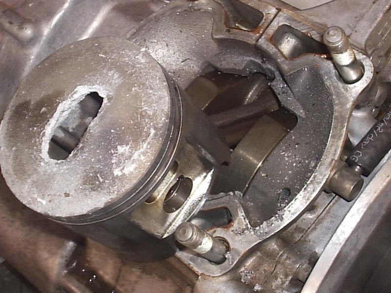

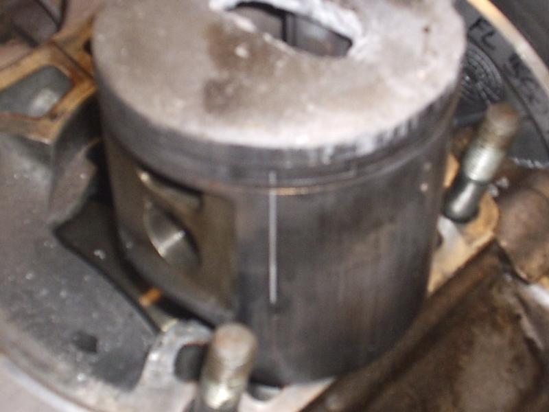

Well I got it torn down this weekend and it's not as bad as I thought it was gonna be, melted a sweet hole in the top of the piston but the good part is the cylinder came out without a scratch, all I'am gonna have to do is a lite hone and cross hatch,new gaskets and a piston. But I will go ahead and reseal it,just hope I can find the seals

WoW... Nice hole you have there in your piston, sorry about your luck.... looks like you leaned it out... looking at the pics were is the hose clamp for the pulse line for the fuel pump ? Or did you already take it off while take the top end apart.... Did you do a leakdown test prior to taking it apart ? Dune Dart

yea that was the hose to the air, the seals are good still but I think Ill swap them out anyways thet're pretty old
