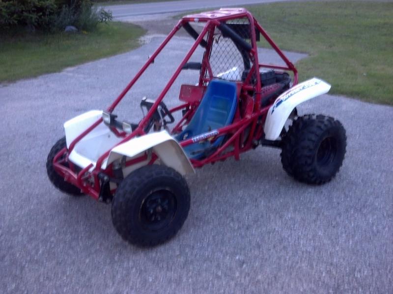

Has anyone ran there oddyssey in the winter. I have a stock fl350 rebuilt top end and k&n filter. I want to run it in the winter and I couldn't find any information on it (probably should have started with the manual) but i was wondering if anyone has run one in the winter. I was planning on just changing the main a few sizes bigger, any thoughts would be appreciated. Experience in cold weather running preferred.

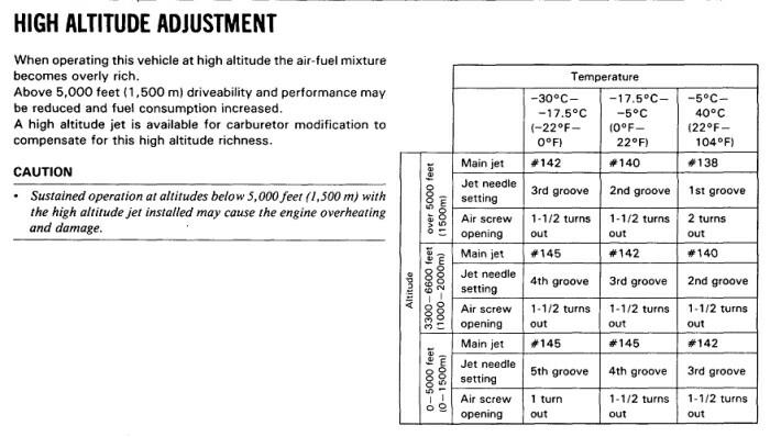

white is lean, wet is rich. I know that just trying to get a rough idea on what Ill need when it comes off. Judging by this chart I should be good with a 145 main, 4th groove, 1.5 turns out. Im at about 200 meters. Also what do you mix your gas at? It says 20:1 but i mix it about 30:1 with a good oil.

That chart is for a NON MODIFIED factory intake system. Yours is modified with the K&N.
