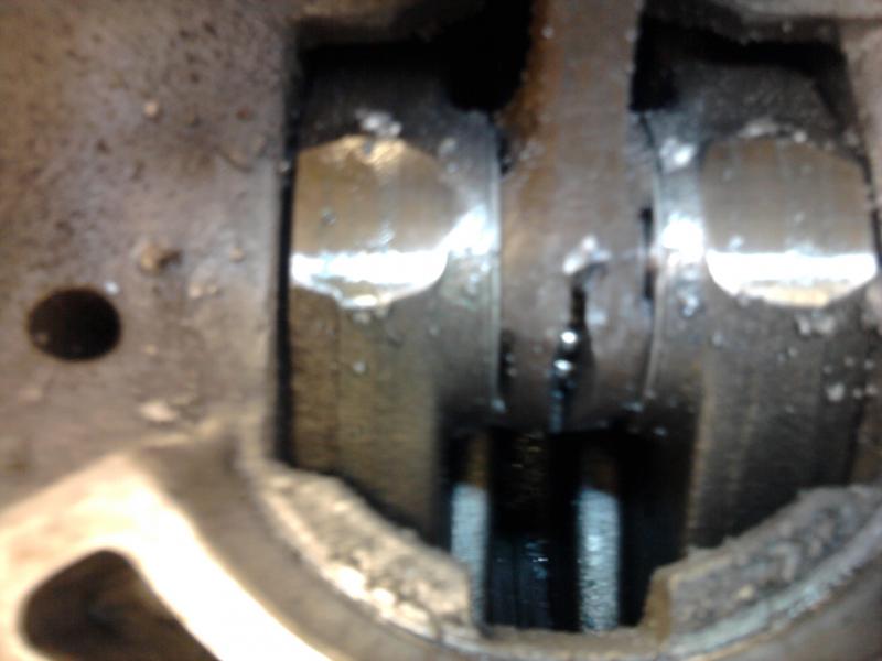

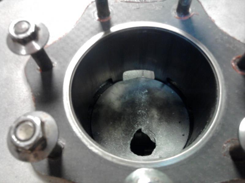

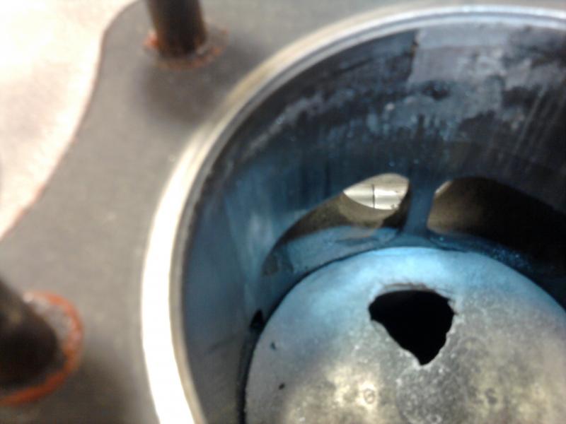

Getting very frustrated now. What am I doing wrong??

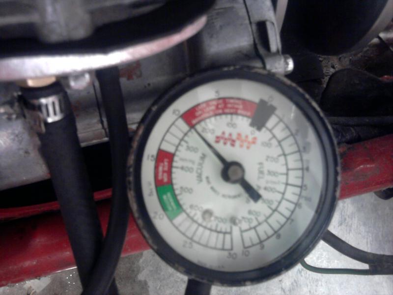

Some facts: Engine had 170lbs compression (measured with a good guage-checked it using my air compressor). Don't know why it had this much compression I just assume the previous owner shaved head. This is the second time this motor (( Internal Combustion Engine ? )) blew up and both times it only ran about 3 miles. Before running I did a positive pressure check - it held pressure for several days. Then did a vaccum test and after 2hrs it was still holding 10 inchs of vaccum (no drop) so the seals were good. I did these tests with the intake boot in place, I just put a plug in. Wanted to make sure the boot wasn't leaking. New 38mm Mukuni with a 330 main jet. We are about 150ft above sea level here. After the motor (( Internal Combustion Engine ? )) blew up I did another vaccum test. Same result as above so seals are good. When I took the main jet cover off bottom of carb lots of fuel ran out so the float bowl was not dry. Does anyone have an idea why so much damage in just 3 miles?

my intake boot where the carb hooks in had a hole on the bottom of it and my piston looked just like that but the hole was more in the middle

Looks like detonation to me.
What head gasket were you running how thick is it ?

Not that I know what I am talking about but I was thinking someone maybe did some bad work on the head, what made me think this is the whole in the piston being off center.

If you all look close at the one photo you will see the piston in the up position. The top of the piston (before the crown starts) was flush with the top of the cylinder so the only gap was the head gasket. I don't know what my squish was because I didn't measure it. I guess I should have done this after the first blow up. I did a vacuum test before I ripped this thing apart like everyone on this site has suggested in past posts (yes I read them - good info at someone elses expense). I left the intake boot on because I wanted to check for leaks here too. It held vaccum for two hrs with no pressure lost so I know for sure everthing was good.

If you piston is even with the top of the cylinder then either the top of the cylinder has been decked or the bottom of the cylinder has been shaved down. Can you take some pictures with the piston at its lowest position so we can see what the clearance is from the top of the piston to the bottom of the ports. Just trying to find out visually if it can be determined which has been done.

Your problem was your jetting. 330 is way to small for you mikuni carb. Holed piston is due to a lean condition causing detonation. Combo of high compression with lean jetting. When you rebuild it put in a 460 main jet
PostPosted: Mon Mar 25, 2013 1:14 am
Sorry for all who swear by egt's but a plug chop is THE ONLY way to accuratelly read your jetting. I have seen more topends go with egt readings below 1150 degrees. It was your jetting and high compression. Get a vesrah gasket kit and use all 3 head gaskets. Try to get the comp. To 165. At 170 you will need to run closer to 100 octain to slow your burn rate. And your running a stock non watercooled head. That is going to be a hot running Engine
