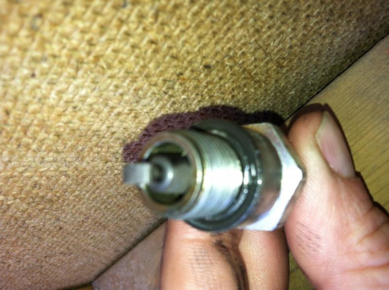

Just did some 1/4 throttle plug chops with a 138 main and the plug is still greyish. I turned the screw in about a half turn and no difference. Should I screw it in some more or get me a 150 main?

Correction my pilot jet is a 48 and the main is a 145. Did leak down and no leaks. Ill post pics of the plug when I get inside the house.

Yes it was a typo, its a 148 main. I put the air screw out 1.5 turns and the clip was in the middle. I screwed the air screw in about a half turn and the plug was still grey. I then moved the clip down one notch and no difference. I changed both jets up one size. I forget the pilot jett size but its one up from stock.

is it fully broken in yet? Its very hard to do plug chops on new plugs.
 Post subject: Re: Jetting questions??
PostPosted: Fri Jun 21, 2013 5:37 pm
its grey but is any part of the electrode wet?
