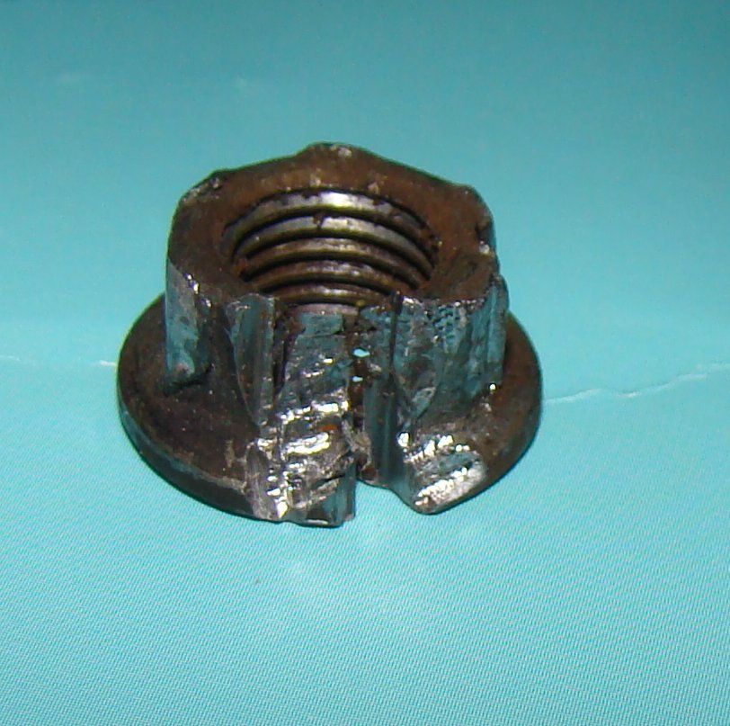

Ugh. One of the nuts that holds the cylinder jug on my FL350 is stripped. I tried heating it up, but there' just no purchase on the wrench and it's slipping making the problem worse.
Any ideas on where to start? I could probably get a dremel in there and grind a slot in it and try to knock it off with a chisel... I could drill a hole in one of the faces and try welding a rod onto it, but I don't like the idea of getting in there with a welder since I'm not all that good with it.

cut an slot in the bolt with an dremal and hit it with an chizel to see if you can get it to move
otherwise cut it threw to the stud on one side so you can split it open to move it
i would get one of these that wil fit it
its an nut splitter
harbor freight sell them
habe used them in the past they work pretty goot for breaking stripped nuts off

can you get vice grips in there? has worked for me in the past

I don't think there's room for a nut splitter or vice grips. It's pretty tight in there. I think it's dremel time. I can put a deep slot in it and work on spinning it off with a chisel. I'm not too worried about buggering the stud since Honda actually seems to stock them and they're only a few bucks.

Just chop it off if all else fails

I would use a die grinder or an air saw and carefully grind or cut down one side of the nut off to expose the thread then tap it around with a small chisel or centre punch .

PostPosted: Thu Jun 13, 2013 10:33 am
Posts: 341
Location: North San Diego
I drilled straight in a front face of the nut, working from 1/16" and worked my way up until I was at a bit the same as the stud diameter, basically taking the stud out
Remember to start high enough up on the nut so you don't end up cutting down into the jug as you move up in bit sizes
Also, don't poke through the back (at least try not to as much as you can) and damage the jug too much
Drill slow and steady, use cutting fluid, it should work pretty smoothly

Success!
I can't imagine life before Dremel's... I cut a couple of slots in the nut and with a nice sharp chisel, gave it a good rap and it was off. The other 3 came off without too much of a fight (although the left rear one took the stud out with it).
