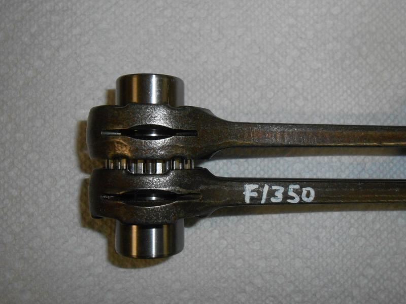

Ok I had some time in the shop today so opened up one of the rod kits I bought its the Prox Pro X 03.1315 I bought two of these to use in the future in my FL350 FL250 81-84 ATC250R Engine rebuilds.
The big end of the Pro X 03.1315 rod appears to be slightly larger than the one used OEM FL350 rod I have I tried to take pictures but they are so close its not like one is noticeably bigger than the other one, I will dress up the big end of these rods a little on a belt sander before installing in the future and will be ready to have to clearance the cases. Their is a raised area in the center of the rod I will assume that is where its rubbing.
The bottom rod is the OEM.
Edited this post to reflect the problem. viewtopic.php?f=64&t=10185
