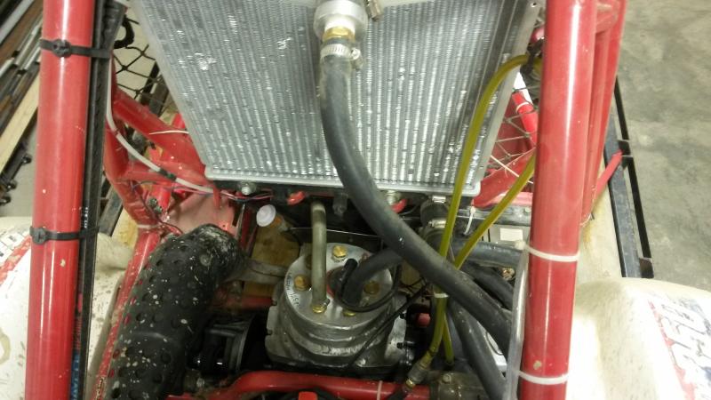

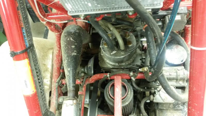

Hey Rand I have a quick disconnect on my breather hose/bellows setup. See pic.
Disconnect is real cheap and you can put it anywhere on the hose you want.
If you look at the pics you can see it on the with plastic hose right above the exhaust pipe.
One on each machine.

PostPosted: Fri Oct 10, 2014 2:32 am
On the setup I designed, its a short hose with a bellows on the end. You just twist the entire hose assembly off to remove it.
