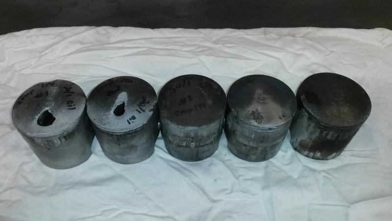

The manual tells you the min rating you can run on the oddy. It's 92 ron. When I ran that I burned my engines up. I drive from just above sea level to 4000' plus. Ever since I ran avgas I have not burned up a single Engine. I even run my machine lean. I run 50/1 oil mix and when you swipe your finger in my exhaust you get NO black on your hand. That's lean. I know for a fact if I put the crap fuel in that you buy for your car its over. Poofkaboom for sure even if I richen it up fat like I had in the beginning. I personally believe the fuel we buy today is not the same stuff they ran in 1985. I can't prove it but I believe it. I have nine piston blow ups to prove it. Here are some. Every man for himself.

I don't know but all I can say is what my experience has been with these machines. My engines held pressure and vacuum for days (no bull) and they went poofkaboom until I ran good fuel. That's all I can say. I think we are hijacking this thread.
