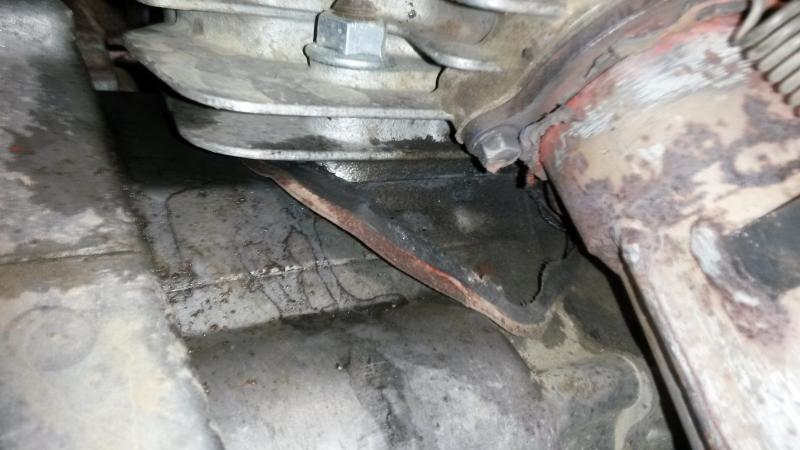

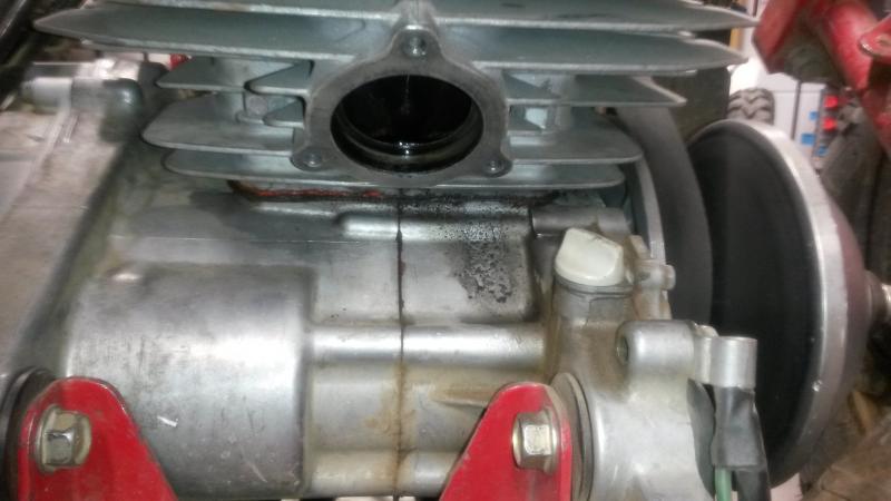

PostPosted: Wed Apr 22, 2015 2:18 am
This is what I am talking about when I say keep an eye on the base gasket.
If you ever have to do a rebuild do not use paper or cork type gasket material.
You must use metal type.
File comment: This happened on my machine once.
File comment: This is my brothers machine. We caught it just in time.

It looks like there is some kind of oil leak right below where the exhaust pipe comes out from the Engine. Is this what your talking about? I took pictures but can't seem to post them on here
PostPosted: Wed Apr 22, 2015 7:56 pm
If it is leaking right at the exhaust that's not what we should be worrying about right now. Look at the pictures I posted. You can see a blown out gasket on one and a bit of oily black running out on the other picture. Check yours. Most important right now is a compression check. That will tell you if the Engine is shot. A compression test is done with a WOT (Wide Open Throttle) (wide open throttle).
