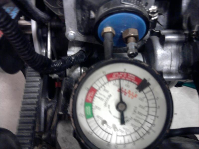

Here are a couple of pics of my test unit.
In the first pic you can see I put a uhmw plug in the intake with a vacuum/pressure gauge that you can buy at any auto store. Also you will see that there is a shrader valve (tire valve) on it so that you can pressure the system up.
In the second pic you can see that I am doing a vacuum test. There is a suction pump that you can buy at any auto store (They are used to remove or ad oil to a rear end on a car or truck). Also in that line you can see a check valve. That's so that the system can hold the vacuum. There is also a fitting on that plate to add a gauge.
Basically my current set up is - I just block off the intake with a plug and I now do everything from that plate on the exhaust. I use an aluminum plate with a inner tube gasket. It' pretty basic but you do need some basic stuff. Also keep in mind that when you do these two tests the pulse tube for the fuel pump must also be blocked off or the pump still hooked up or you will just suck air. Your piston must be at BDC or near the bottom to expose the intake and exhaust ports. I made the mistake of having the piston up once and couldn't figure out why the pressure was dropping. It was because the combustion chamber area wasn't pressured up yet LOL. This is not rocket science, it is fun or at least it better be fun.

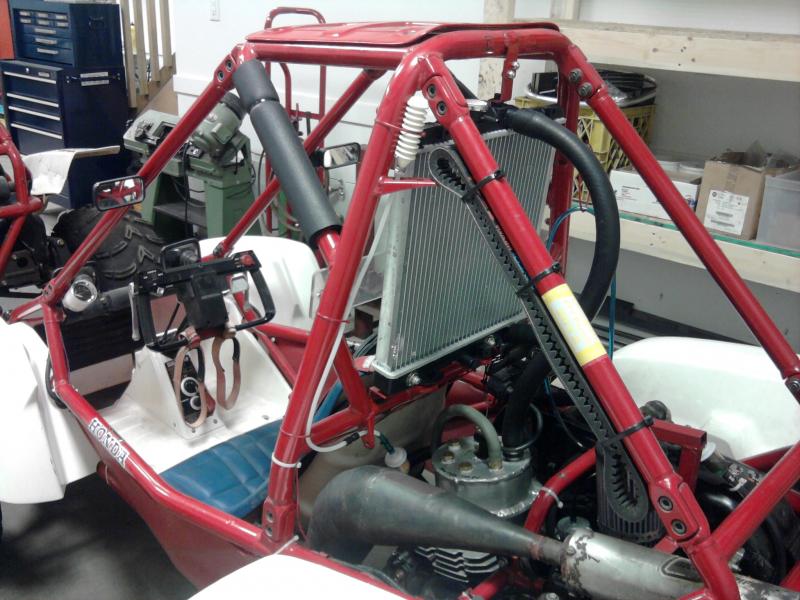

Yes. Counter balancer mod. It is not required but if you don't do it then your starter will fill up with counter balancer oil after a while. Below is a pic and you can see the white bellows and part way down you will see a fuel filter which is used for some expansion. The line is attached to a ford drain plug which replaces the original dip stick or you can screw in a quick disconnect fitting onto a modified dip stick. Your choice. I modified my stock dip stick by cutting off the stick, grinding off the top and screwing in a quick disconnect. The bellows which works well is a differential bellows from a 2007 Can Am 500CC Outlander part number 705400352. The ford part used is 2000 ford f150 radiator drain plug. See pics.
File comment: This was my first attempt with the ford drain plug. Didn't really like it as it came out once. So drilled and tapped a quick fitting into original dip stick
