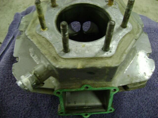

Here is where the cylinder skirt is broke.
I don't think the sleeve can be replaced since part of its broken off you would have to send to someone like LA Sleeve and ask, usually they over bore the stock sleeve and press in a new liner they usually don't fully remove a cast in liner like on this cylinder.

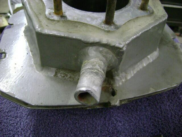

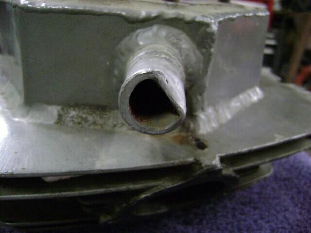

The tube that sticks out of the cylinder for the coolant hose is also bent.

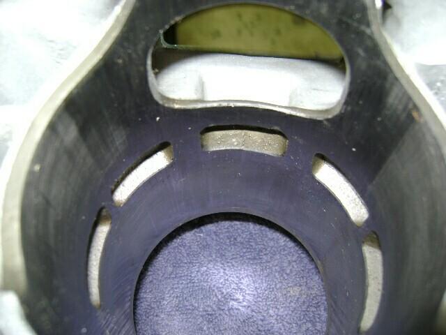

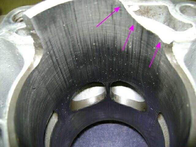

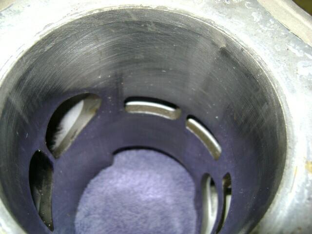

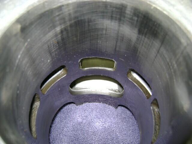

PostPosted: Thu Jan 03, 2008 1:24 pm

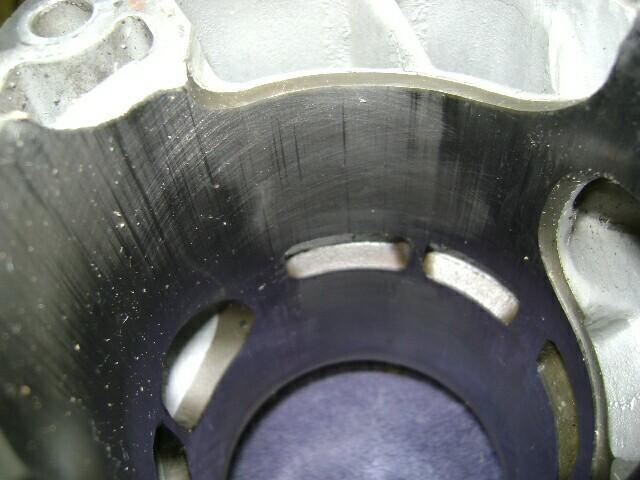

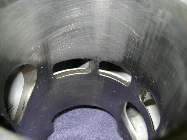

Some pics of the bore you can see uneven wear.

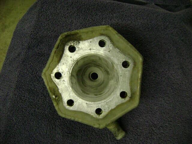

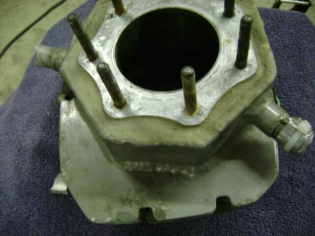

PostPosted: Thu Jan 03, 2008 1:25 pm
Some pics of the water jacket they welded on, looks like nice work to me.

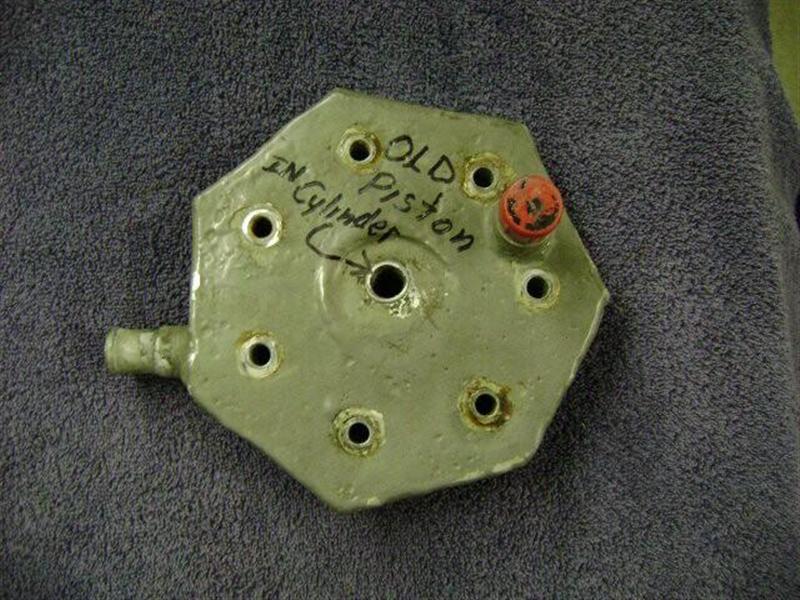

PostPosted: Thu Jan 03, 2008 1:26 pm
Pics of the stock head that was converted to LQ by cutting off the old fins and welding up a water jacket.

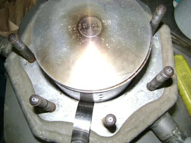

PostPosted: Thu Jan 03, 2008 1:30 pm
Its hard to see in the pic but that's a .004 feeler gauge between the cylinder wall and piston, I have not taken any other measurements other than this quick and dirty method of testing http://pilotodyssey.com/PO/viewtopic.php?t=3115
I cant get a .005 feeler gauge to fit, gut feeling guess is the clearance is .0045, I didnt waste my time taking precise measurements since the cylinder is broke if you want exact measurements let me know.

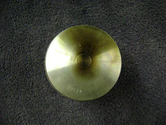

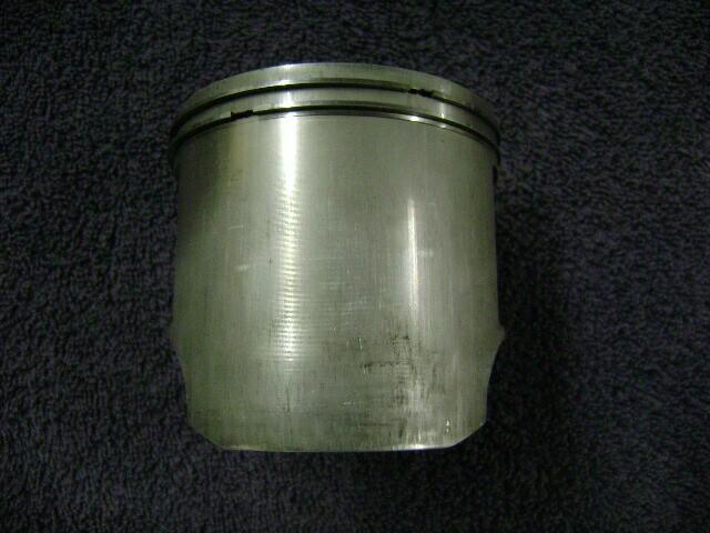

PostPosted: Thu Jan 03, 2008 1:34 pm

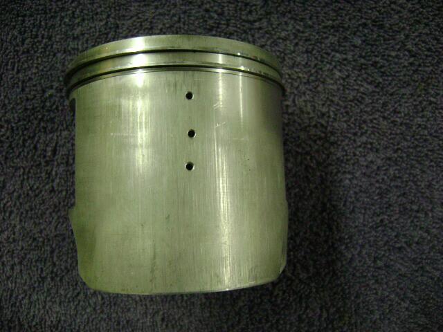

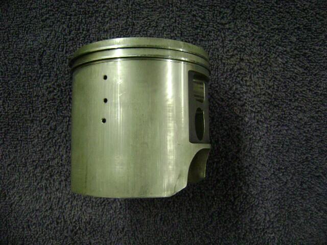

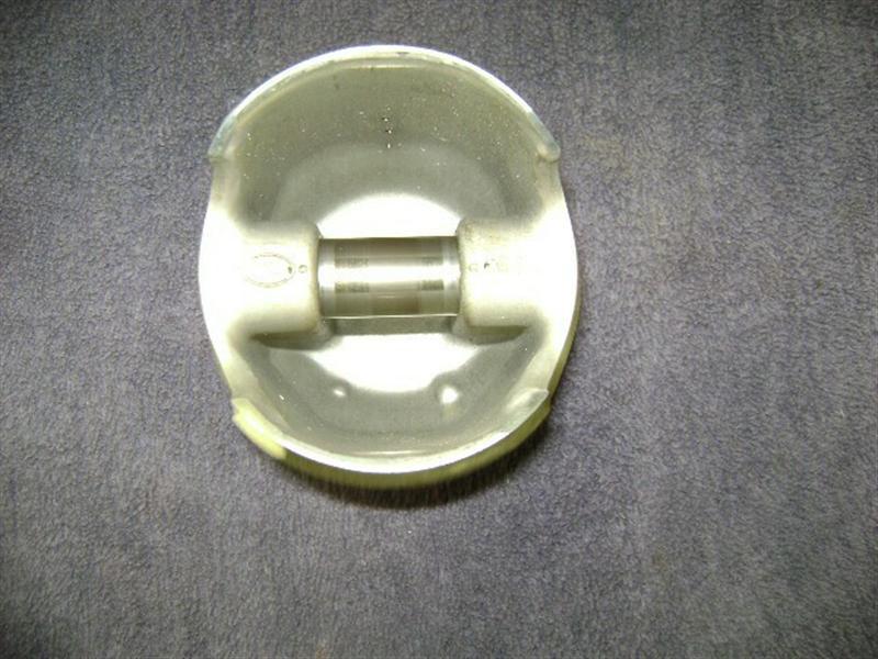

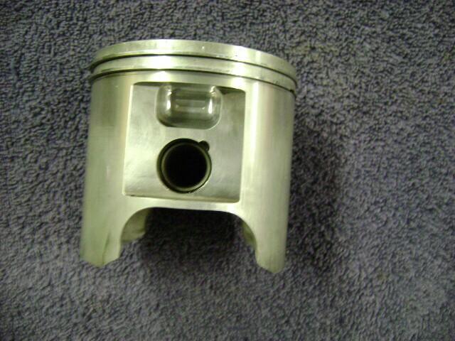

The piston actually looks good, very low hours, it could be reused as is, you also could send it out for skirt coating also.
Their is some slight scuffing on the skirt, the coating would take care of that, the piston was never over heated the wrist pin floats in and out easily, you can tell Hare had it jetting with his signature super FAT jetting heh
Its hard to get good pics of the piston inside but their pics make it look 100x worst than it is .

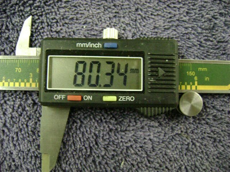

PostPosted: Thu Jan 03, 2008 1:36 pm
OD of the piston skirt

PostPosted: Thu Jan 03, 2008 1:37 pm
A real quick and dirty measurment of the cylinder ID

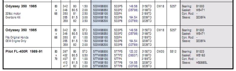

Looking at the wiseco piston chart this cylinder was on second bore.
Shame its broke it had 3 bores left..
