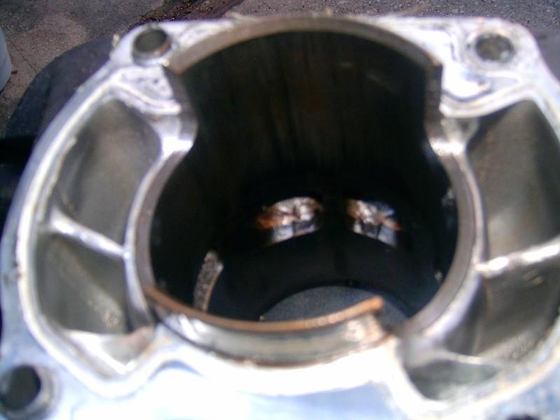

about to tackle this head,ody 350,never taken off head before,I'm reading the service manual and wondering is it really necessary to take off all the stuff the manual says?
it says to remove right and left air guide and main maffler,what the hell is that?are they talking about the exhaust pipe?
also,the fuel tank,seat,drive belt covers,do they all have to come off?
thanks
gasket is stuck to top of cylinder head,don't know if that means anything,in manual its stuck to top of cylinder

i'm just doing everything it says,got most of it off now,once i get everything removed to get to the cylinder i'll probably need some help with that part,hopefully not though

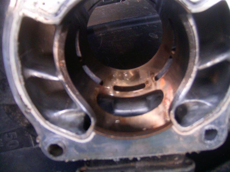

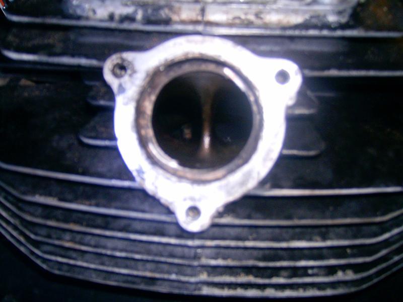

Just finished getting everything removed except the reed cage,pulled off the intake but the reed cage stayed on,I'm afraid to pry it off since i don't know what I'm doing.
Tried to get the 4 cylinder nuts to turn but couldnt budge them,I believe it takes a 14mm but my wrench is not very long and I cant get any torque behind it,sprayed some pb blaster on it and i'm done for the day,will get back to it wed or sunday

don't pry on nothing, a nice tap with a soft hammer or block of wood should be all you need.
good tip on the MP wrench, you can also take a decent box end wrench and evenly grind down the box end to make it fit better, then use another wrench as a cheater if needed.
when you pull the jug don't twist or rotate too much and have a thick rubber band to hold the rod and piston from flipping around

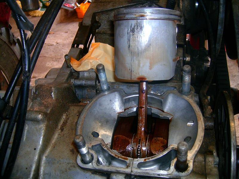

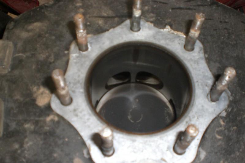

Cylinder nuts came off pretty easy after soaking with pb blaster,cylinder pulled right off very easily
ok,first question,in the last pic,isnt that reed cage suppossed to come off the cylinder? its stuck on there pretty good if it is suppossed to come off and I didnt want to break it if it isnt suppossed to come off.
2.not sure what I'm looking for,everything looks good,It doesnt look like any scarring on the sides of the cylinder,I don't see any loose metal shavings,crank looks fine,I thought maybe it was broke and that's what that metalic banging noise was I heard.I have a buddy coming over tonight to take a look that knows more than me,but that's not much

yes the reed cage will come out of the cylinder.
Go you have a feeler gauge to check the play in the crank?
There looks to be some wear on the exhaust side of the piston. Any more pictures of the exhaust port in the cylinder? From the one you have the bridge does not look to have been relieved. looks like a Honda piston to me though so you should have plenty of life left in the cylinder.

no feeler gauge,if i hold the top of the piston straight up like it would be in the cylinder and move it side to side,I would est about 2 to 3 mm of play
