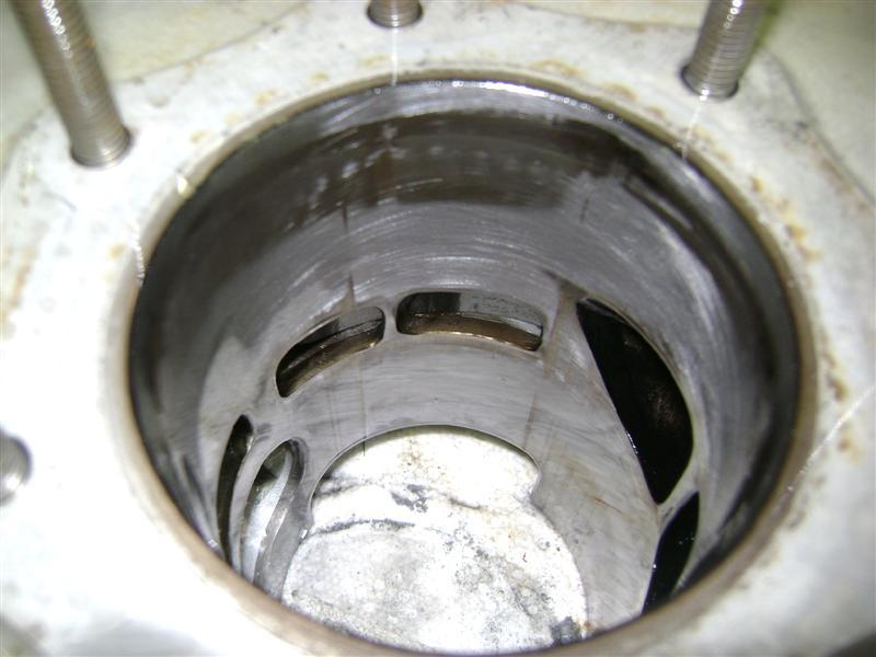

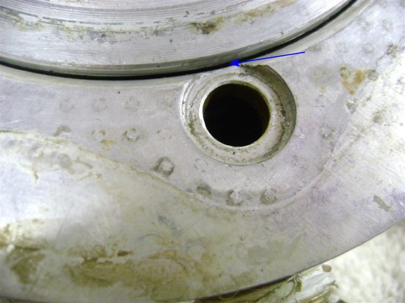

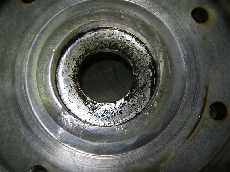

I received your top end today, I only had time to unpack it and give it a quick look, perfect packing BTW the package arrived undamaged.
The first thing I noticed was their is carbon trails by each head stud this is usually a indication that the head was over torqued, when over torqued it will actually distort the cylinder the metal by the studs is actually moved and the cylinder is no longer round so the rings wont seal properly and you get blow by by each stud as seen in the pics.
Was killer busy after work tonight so I didnt get any further I will look closer and take some measurements, I also need to clean the carbon off the cylinder wall and lightly hone the cylinder to see if the metal by the studs has relaxed back to where it was before, I had the same thing on my ATC300R big bore kit http://www.pilotodyssey.com/PO/viewtopic.php?t=5403 the did go back to normal.
These pictures suck I will try to get better pics in the sun light.
The head is interesting if I am not mistaken its a liewire head, strange design as with most his stuff.

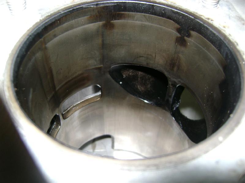

PostPosted: Thu May 14, 2009 8:24 pm

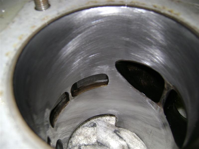

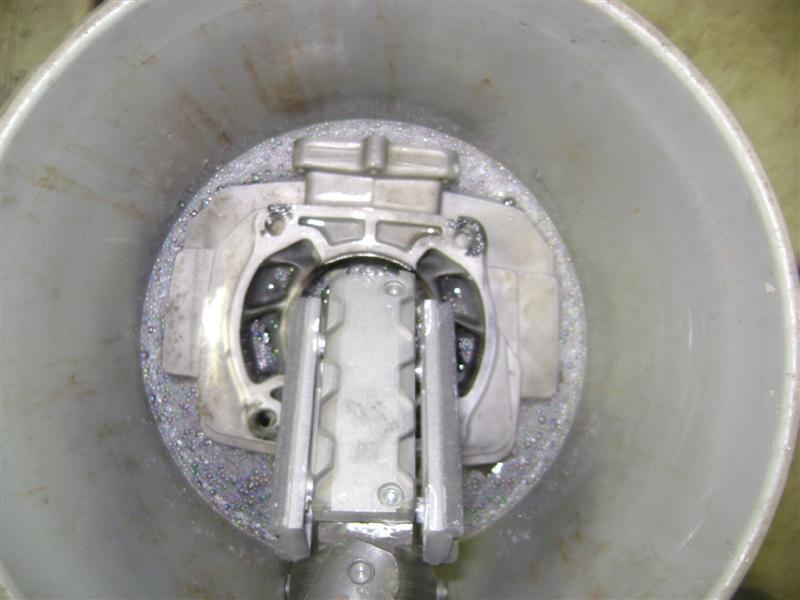

Ok took a second look tonight, actually I put your cylinder in my hone tank, I use a Sunnen AN-112 hone with stones made for 2 cycle engines or cylinders with holes in them, this hone will show you things a ball hone cover up, a ridged stone hone will only remove material from a high spot it will not dip into a low spot like a ball hone does.

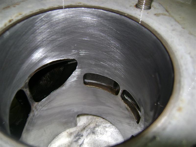

PostPosted: Thu May 14, 2009 8:26 pm
I did a lite hone not much material is removed only enough to show how straight the bore is, no real measurable amount of material is removed.

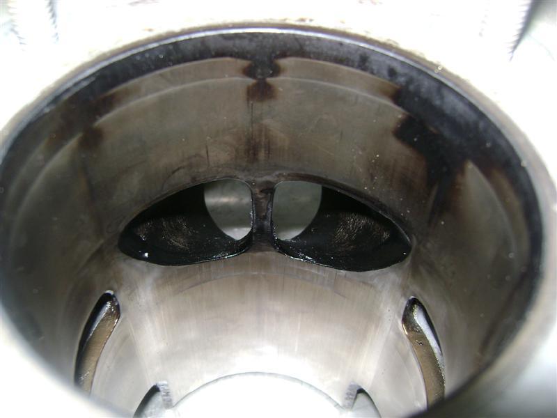

PostPosted: Thu May 14, 2009 8:28 pm

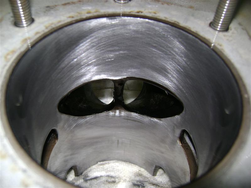

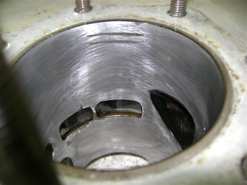

Back in the tank again this time I will remove more material as many call 'break the glaze', you can still see spots at the top of the bore where the rings wore the bore.

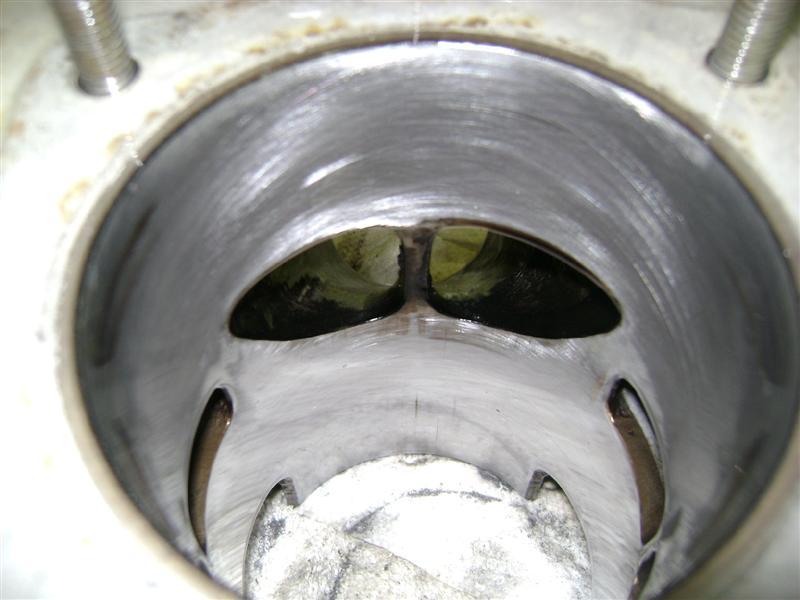

Back into the hone tank for a 3rd time this time I removed even more material, how much? I don't know I didnt bother to measure no use wasting my time measuring when the bore is still in a condition you could not use it.
Now the bore is almost even.

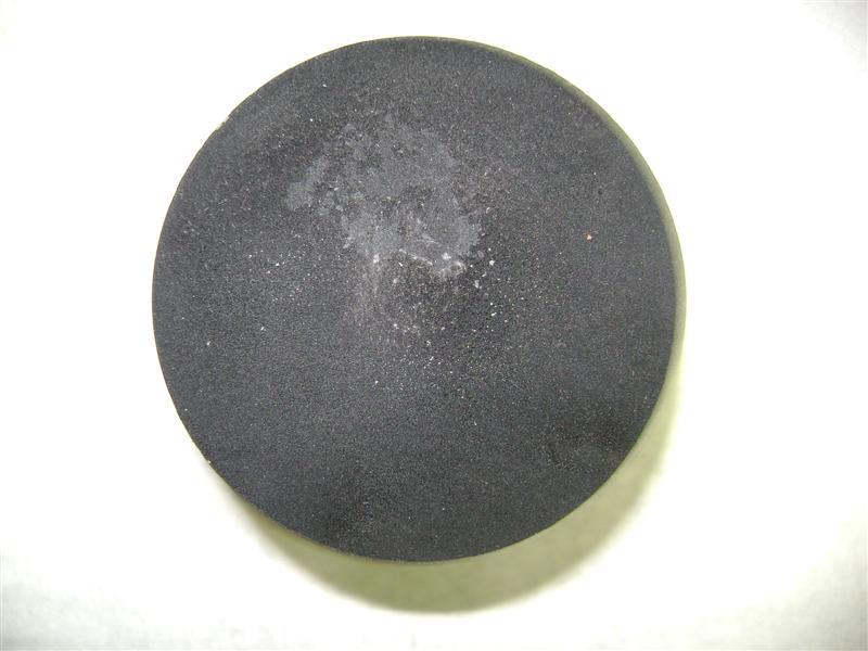

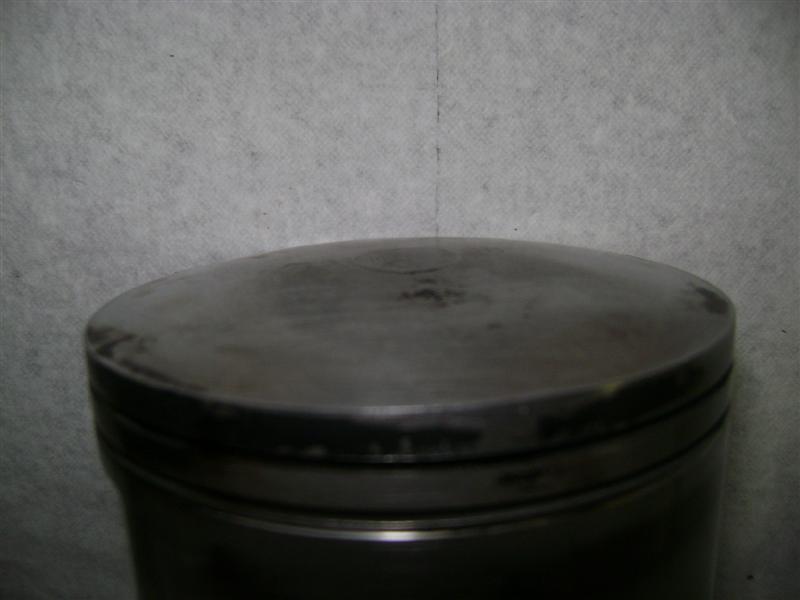

Cant see it well in the pics but the crown of the piston has a dimple spot on it, the piston crown actually got hot enough it started to sag.
File comment: Cleaned up you still cant see it well in the picture.
File comment: The sag spot on the crown perfectly matches the blister spot seen on the bottom side of the piston.
This piston looked DEATH straight in the face and rejected it lol how lucky can you get.

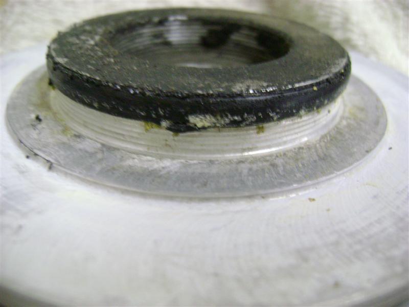

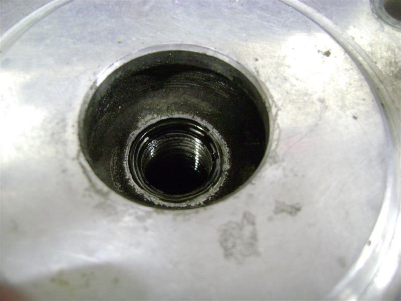

All the Orings need replaced, I never liked this head design I question it after seeing two 'prototypes' he sent a good friend of mine, my buddy Don called me one day and said "I have two water cooled heads for a FL350 you need to come see them" I don't see any difference in this head over the prototypes I looked at, I don't agree at all with the methods used to hold the HOT coolant inside the water jacket, the way the o rings are used goes against all my formal training on o rings I ever had I also have never seen o rings used in any application like they are used here, the O rings are compressed against a threaded stud and are suppose to seal, if you look at the bottom of the head o rings are also expected to seal against a incomplete pocket.
The spark plug sets into a pocket not good for off road it always traps dirt special care must be used before the spark plug is removed each time, compressed air should be used to ensure all loose dirt is out of the cavity before the plug is removed.
Another O ring should have been used on top of the dome to keep dirt that falls into the pocket where the spark plug is from getting to the o ring that seals the top of the dome.
The top of the dome has only one o ring pro design and other mfg's use two o rings in this area.

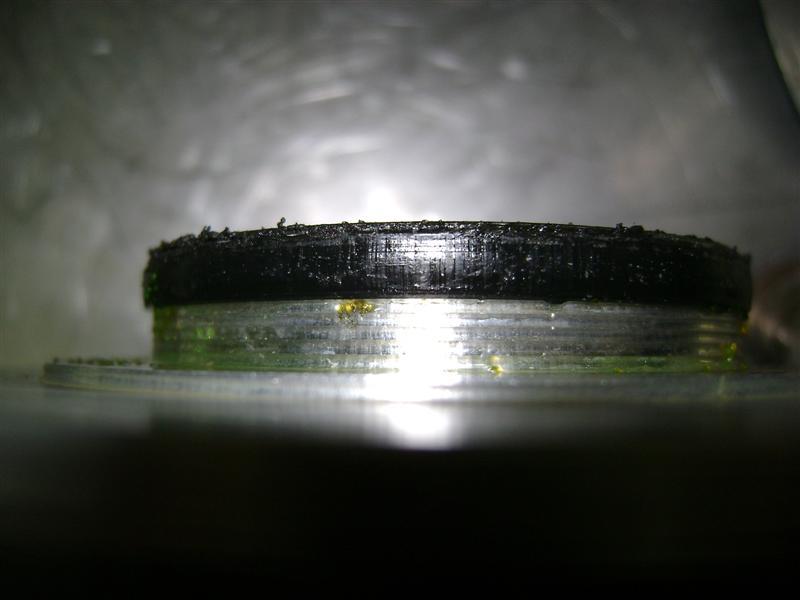

PostPosted: Fri May 22, 2009 11:25 am
Dirt that's below the spark plug between the top of the dome and the outer shell, worked its way to the o ring and was damaging it, I would use high temp silicone in this area after it was assembled to keep crap away from the o ring.

PostPosted: Fri May 22, 2009 11:26 am
Dirt ground into the o ring, o ring distorted like it was affected by heat or the groove clearance is not correct.

PostPosted: Fri May 22, 2009 11:34 am
Ever time I look at this picture it makes me wonder, was the head over torqued during the assembly or did someone throw extra torque on the studs because they seen coolant weeping around an area that the o rings are suppose to seal, its human nature when someone sees something leaking to try to tighten it up.
At the very least ALL the o rings need replaced.
