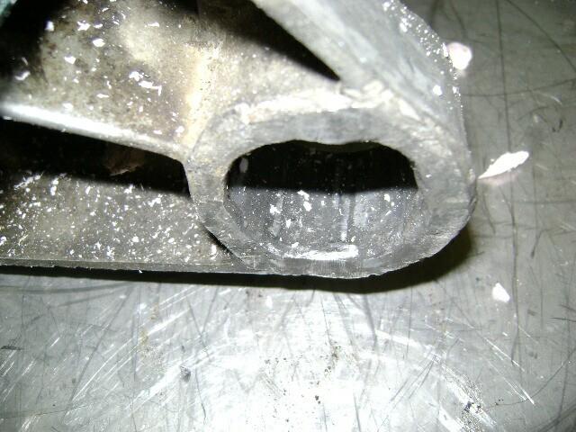

Crank not rusted real bad, some wear on the cases by the Engine mount.

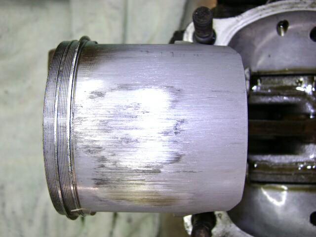

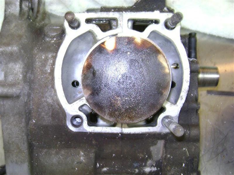

PostPosted: Thu Oct 18, 2007 8:57 pm

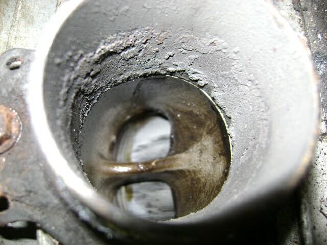

You can see piston scuffing through the exhaust port, you also can see the 'wet line'

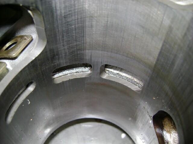

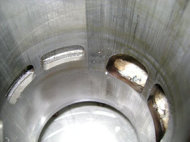

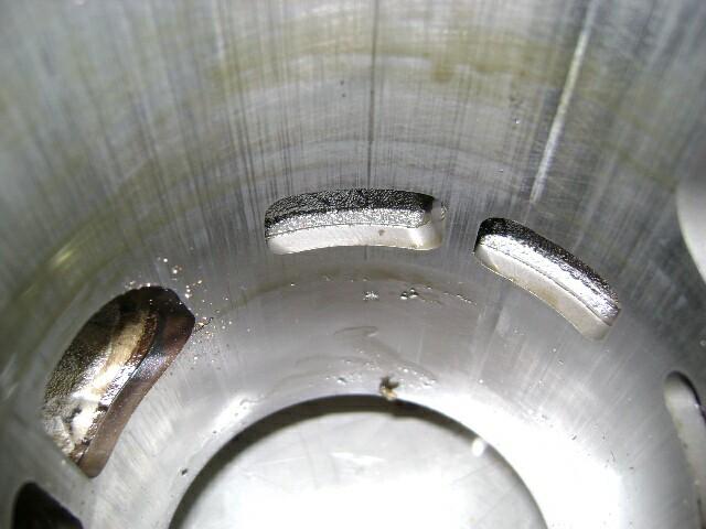

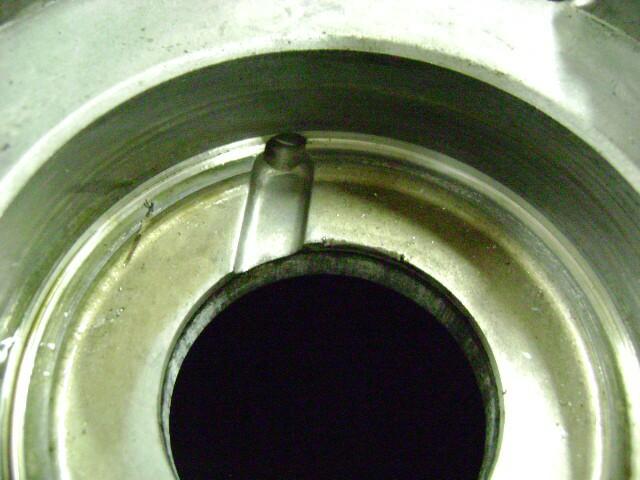

PostPosted: Thu Oct 18, 2007 9:04 pm
The cylinder has a new sleeve but who ever installed it never matched the ports of the new sleeve to the old sleeve and cylinder they also did NOT bevel the ports, they used a WISECO piston and never drilled the lube holes and it looks like they never relieved the exhaust bridge, not surprised the piston is scuffed.

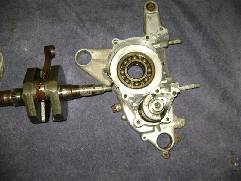

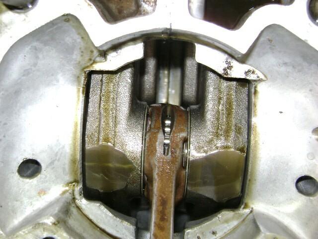

PostPosted: Thu Oct 18, 2007 9:06 pm
The bottom end, will know more once the cases are split.

Thanks Hoser-I'll contact the old owner of this motor (( Internal Combustion Engine ? )) as I just recently bought it for this ody I am currently doing.He had sold it to me under the pretense of it being a 20-30 hr motor (( Internal Combustion Engine ? )) that was recently taken out of a parts machine, he had no other info on it but had mentioned it was rebuilt recently, so I guess the descprition fits the motor (( Internal Combustion Engine ? )).The piston is a Wiseco huh?Wonder why, new sleeve in it why not go with a Honda ART Piston?-have you had the chance to size the bore by chance?
Thanks for the great pictures BTW-the wet line isnt that far from that piston, I havent seen 1 that close to date-could there have been an issue?have you seen the plug I sent by chance-
Also, why resleeve and not drill the cooling holes in the piston-thats the wierdest thing so far IMO-they have it written on the piston box and inside the directions as well.

The piston OD is 3.141
The cylinder ID is 3.151
Skulls NEW wiseco measured 3.143 OD even if wiseco sends you a new piston and it happens to be the same size as Skulls was that would leave you with .008 piston to cylinder clearance...

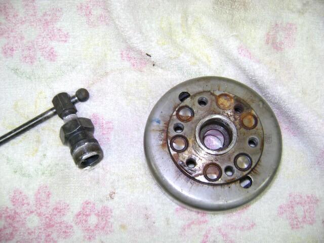

To pull the flywheel you use a puller like this, this puller fits about 1/2 the flywheels Honda uses as well as many other brands.
I think I paid like 15 bux for it at my local Honda dealer about 15 years ago.

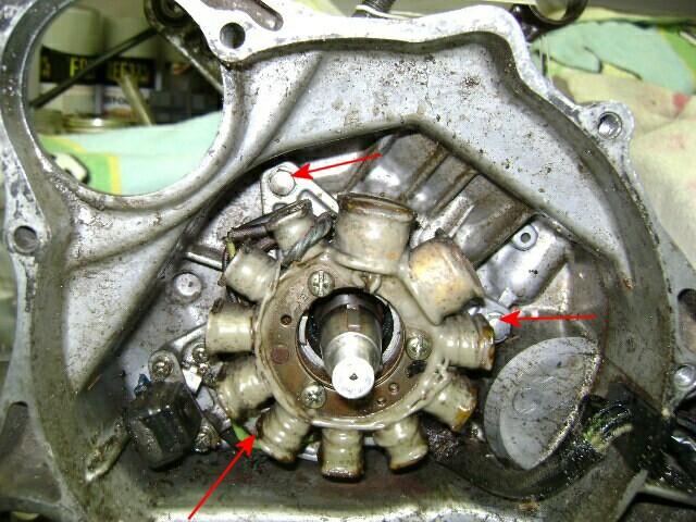

Now you can see the stator, you remove the 3 bolts (red arrows) to remove the stator plate.

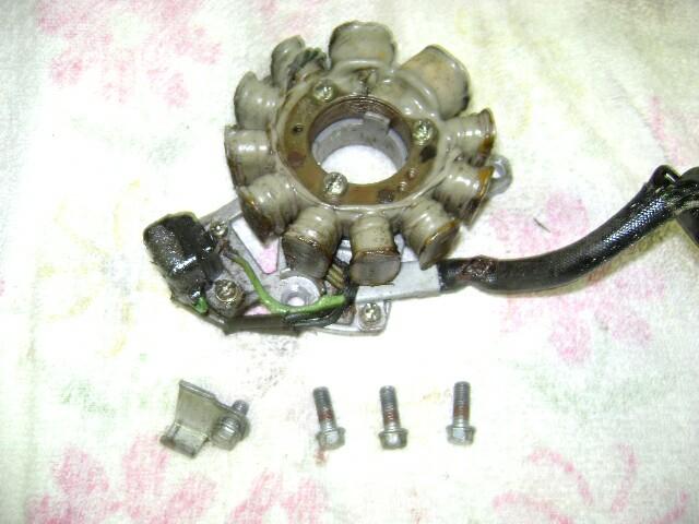

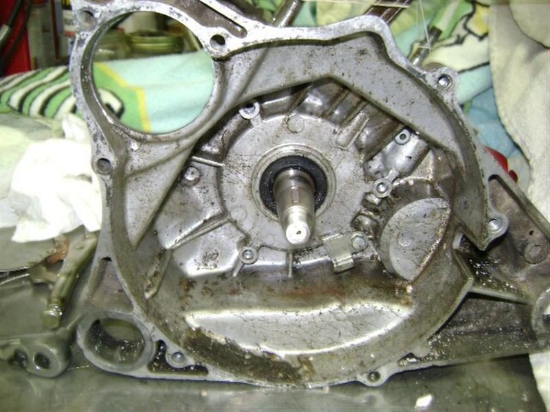

PostPosted: Mon Oct 22, 2007 7:56 pm
Stator plate removed.

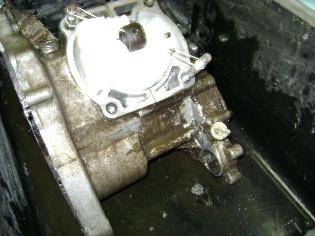

In the tub ready for a bath.

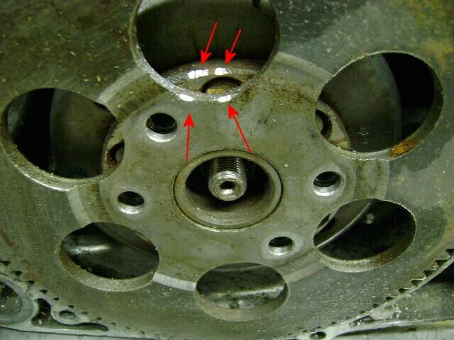

With the first layer of grease and grime removed its time to remove the balancer gears.
Cover off, see the match marks for the balancer (red arrows) the big nut that holds the balancer gear on the crank has a stamped steel lock you bend to keep the nut from coming loose, (blue arrows) it needs replaced it has been removed a few times already and is in rough shape.

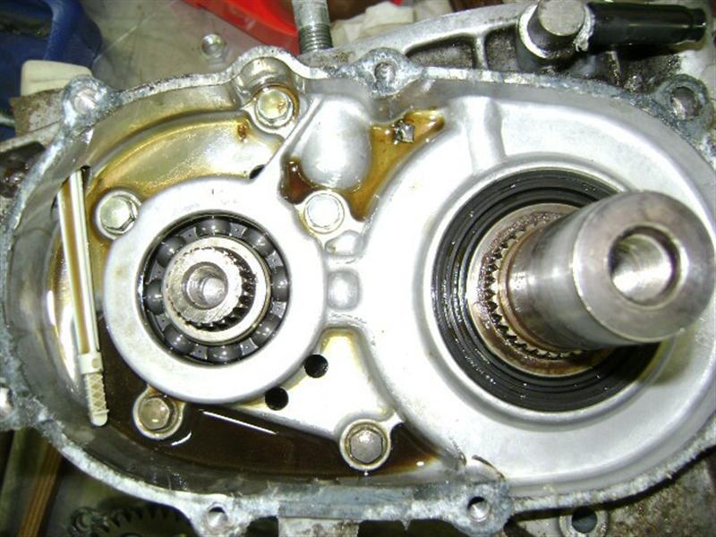

PostPosted: Mon Oct 22, 2007 8:03 pm
Gears removed.
Next I split the cases, I started fabricating a puller plate I will finish that tomorrow and split the cases.
See the balancer oil dip stick?

The cases split easily

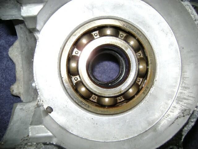

PostPosted: Fri Oct 26, 2007 4:59 pm
FAG bearings from Germany

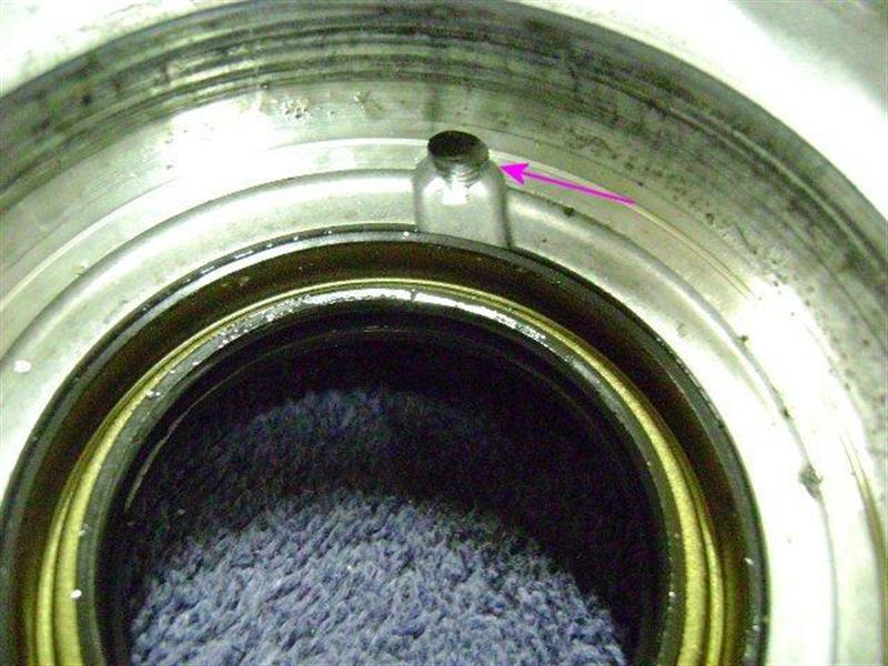

PostPosted: Fri Oct 26, 2007 5:00 pm
Oil passages to the bearings will be hoserized.

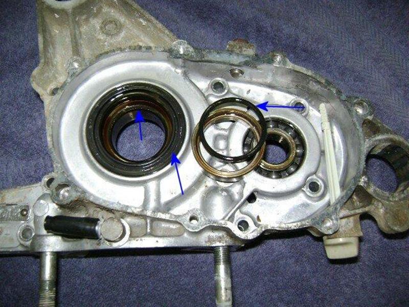

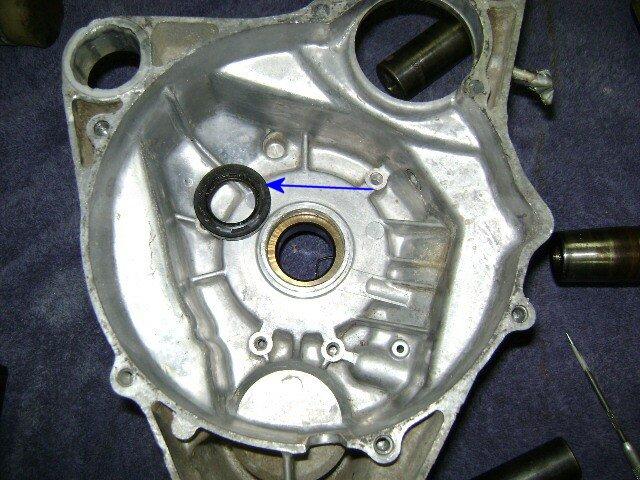

PostPosted: Fri Oct 26, 2007 5:11 pm
Ok, so far I need the following:
Piston-hopefully ART I'll call Sara and ask what they have-the size I need is ?
Head nut- 1
reed cage bolt-1
cylinder nut-1
Balancer gear washer/nut-1 of each
full gasket set
anything else so far?
Probably new bearings and seals for the bottom end as well I would imagine.
Does the full gasket set come with the orings like a Pilot kit does?
I need that big o ring in the the pics, all the blue arrows are pointing to what I need.
O ring (in the pics)
Both crank seals
Both crank bearings
TWO case dowels one is damaged one I have not tried to remove yet
